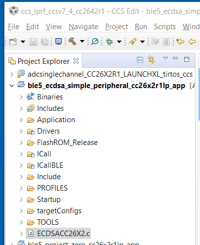

  • Hi Mark,
     Please try the following:
    1. Copy the file ECDSACC26X2.c from C:\ti\simplelink_cc26x2_sdk_1_60_00_43\source\ti\drivers\ecdsa into your simple peripheral project.
    2. Find the API ECDSA_sign (line 736) and rename it. For example ECDSA_sign_mod.
     *  ======== ECDSA_sign ========
    int_fast16_t ECDSA_sign_mod(ECDSA_Handle handle, ECDSA_OperationSign *operation) {
    3. Build your project
      As I mentioned before, this should be fixed in the next SDK version.
