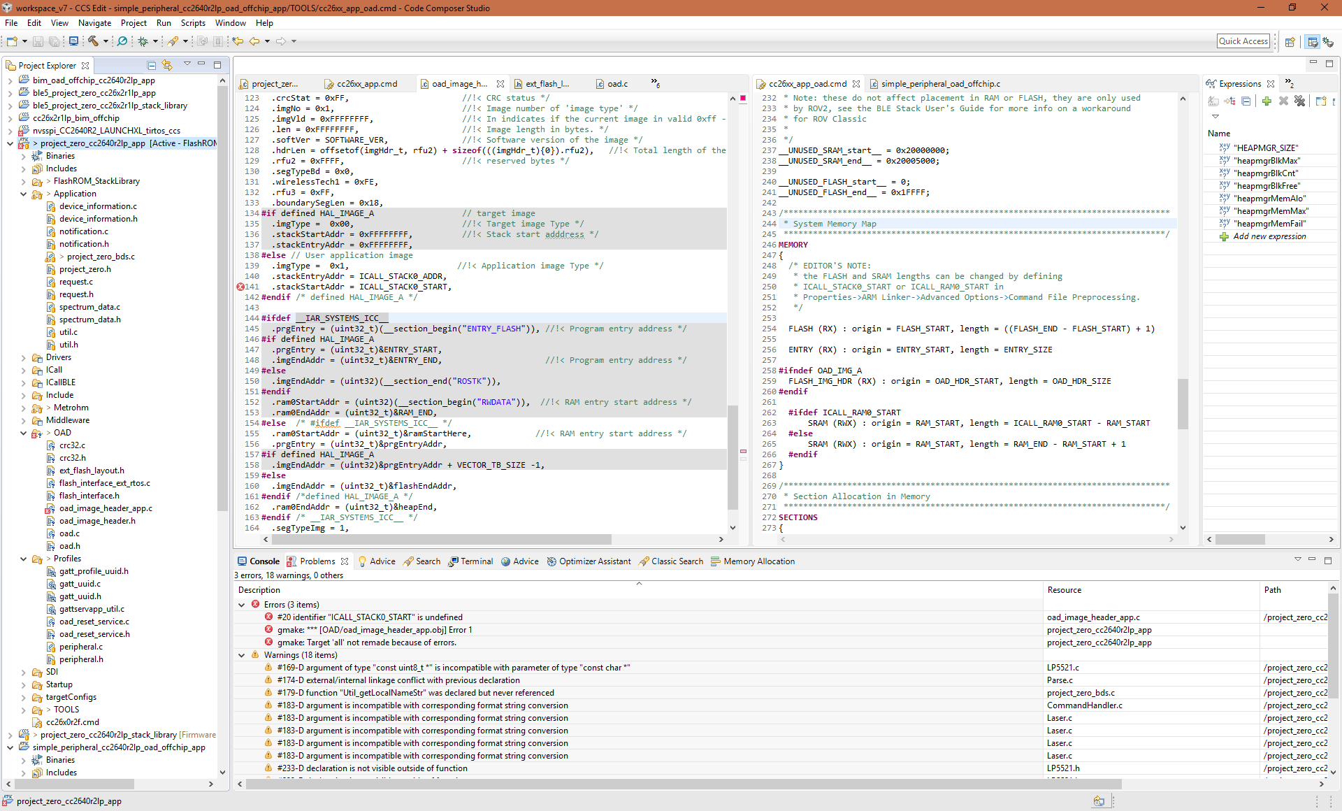

Hi guys,
I'm trying to add the OAD Off Chip functionality to the Project Zero example.
I've noticed differences in what the documentation specifies (software-dl.ti.com/.../oad_offchip.html versus how it was implemented in the simple_peripheral_oad_offchip example.
Some of the differences are what the documentation recommends to do in the main app:
if (events & SBP_QUEUE_PING_EVT)
  while (!Queue_empty(hOadQ))
    oadTargetWrite_t *oadWriteEvt = Queue_get(hOadQ);
    // Identify new image.
    if (oadWriteEvt->event == OAD_WRITE_IDENTIFY_REQ)
      OAD_imgIdentifyWrite(oadWriteEvt->connHandle, oadWriteEvt->pData);
    // Write a next block request.
    else if (oadWriteEvt->event == OAD_WRITE_BLOCK_REQ)
      OAD_imgBlockWrite(oadWriteEvt->connHandle, oadWriteEvt->pData);
    // Free buffer.
    ICall_free(oadWriteEvt);
versus what the example does in simple_peripheral_oad_offchip.c:
// OAD events
      if(events & SBP_OAD_QUEUE_EVT)
        // Process the OAD Message Queue
        uint8_t status = OAD_processQueue();
        // If the OAD state machine encountered an error, print it
        // Return codes can be found in oad_constants.h
        if(status == OAD_DL_COMPLETE)
          Display_print0(dispHandle, SBP_ROW_STATUS1, 0, "OAD DL Complete, wait for Enable");
        else if(status == OAD_IMG_ID_TIMEOUT)
          Display_print0(dispHandle, SBP_ROW_STATUS1, 0, "ImgID Timeout, disconnecting");
          // This may be an attack, terminate the link
          GAPRole_TerminateConnection();
        else if(status != OAD_SUCCESS)
          Display_print1(dispHandle, SBP_ROW_STATUS1, 0, "OAD Error: %d", status);
      if(events & SBP_OAD_COMPLETE_EVT)
        // Register for L2CAP Flow Control Events
        L2CAP_RegisterFlowCtrlTask(selfEntity);
Also, what the document recommends to do to edit the linker file (for existing linker files) (http://software-dl.ti.com/simplelink/esd/simplelink_cc2640r2_sdk/1.40.00.45/exports/docs/blestack/ble_user_guide/html/oad-ble-stack-3.x/oad_appendix.html#sec-generating-oad-linker-file
/* The starting address of the application.  Normally the interrupt vectors  */
/* must be located at the beginning of the application. Flash is 128KB, with */
/* sector length of 4KB                                                      */
#define FLASH_APP_BASE          0x00000000
#define FLASH_LEN               0x20000
#define FLASH_PAGE_LEN          0x1000
#define FLASH_PAGE_MASK         0xFFFFF000
/* Last page of Flash is allocated to App: 0x1F000 - 0x1FFFF */
#define FLASH_LAST_PAGE_START   (FLASH_LEN - FLASH_PAGE_LEN)
#ifdef ICALL_STACK0_START
#ifdef PAGE_ALIGN
#define ADJ_ICALL_STACK0_START (ICALL_STACK0_START & FLASH_PAGE_MASK)
#else /* !PAGE_ALIGN */
#define ADJ_ICALL_STACK0_START ICALL_STACK0_START
#endif /* PAGE_ALIGN */
#endif /* ICALL_STACK0_START */
/* Application stored in and executes from internal flash */
/* Flash Size 128 KB */
    FLASH (RX) : origin = FLASH_OAD_IMG_START, length = ADJ_ICALL_STACK0_START - FLASH_OAD_IMG_HDR_SIZE
#else // default
    FLASH (RX) : origin = FLASH_OAD_IMG_START, length = FLASH_LEN - FLASH_PAGE_LEN - FLASH_OAD_IMG_HDR_SIZE
#endif
Versus what the example simple_peripheral_oad_offchip does in cc26xx_app_oad.cmd:

So, since I've tested the simple_peripheral_oad_offchip, I'm trying to go off of that. An issue with the documented approach is I could never get the L2CAP_RegisterFlowCtrlTask(selfEntity); function to link correctly.
The problem I am facing now is that using the default cc26xx_app_oad.cmd when I build the project I get the error:
This could be because simple_peripheral_cc2640r2lp_oad_offchip_app is a separate stack and app image whereas the project zero is a library image.
So, I'm just a bit confused on which to follow: the documentation or the example. I haven't had luck with either yet. Is there a different example you could point me to? Or any suggestions?
I've uploaded my project if you would like to take a look. (Please note some references are pointing to my E: drive where I had also installed the SDK 1.40.00.45.
Thanks again for your time,
Brett
example.zip

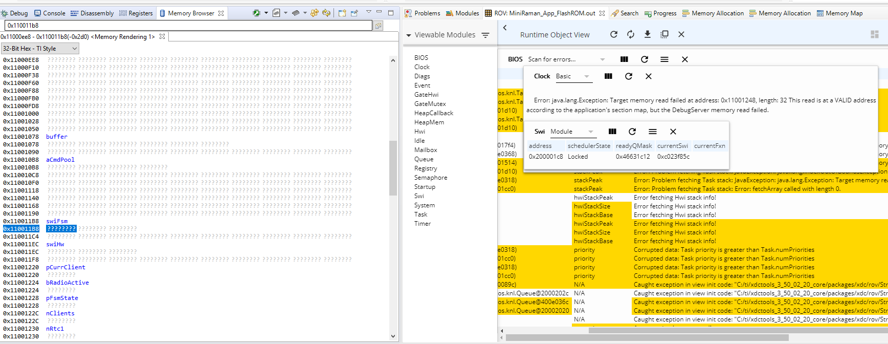

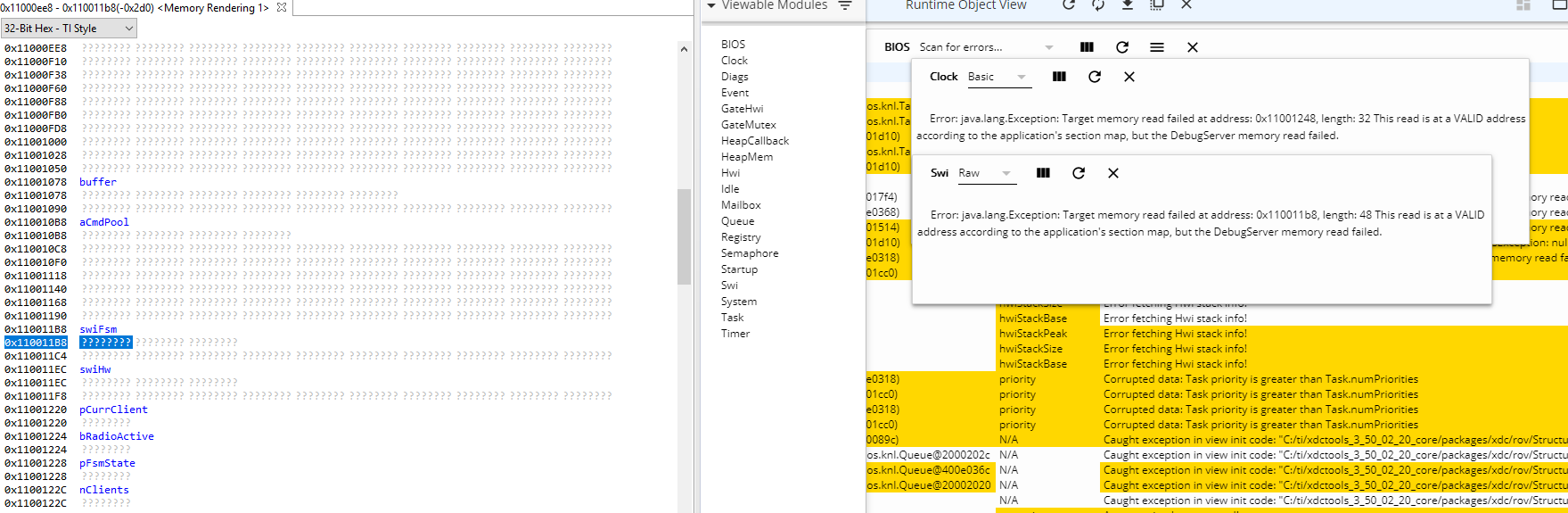

    My issue is that when I program and debug I don't even make it to the main() fxn in main.c.
    Here is the output from the ROV from BIOS when it scans for errors:
    ti.sysbios.knl.Task	Module	N/A	schedulerState	Swi scheduler state unknown
    ti.sysbios.knl.Task	Detailed	ti.sysbios.knl.Task.IdleTask	stackPeak	Overrun!
    ti.sysbios.knl.Task	Basic	ti.sysbios.knl.Task.IdleTask	mode	Invalid mode: 4
    ti.sysbios.knl.Task	Detailed	ti.sysbios.knl.Task.IdleTask	mode	Invalid mode: 4
    ti.sysbios.BIOS	Module	N/A	currentThreadType	Error: unknown thread type for current thread.
    ti.sysbios.knl.Semaphore	Basic	(0x20001f64)	pendElems	Error: Problem scanning pend Queue: JavaException: java.lang.Exception: Target memory read failed at address: 0xffffffe2, length: 8 This read is at an INVALID address according to the application's section map. The application is likely either uninitialized or corrupt.
    ti.sysbios.knl.Semaphore	Basic	(0x2000180c)	pendElems	Error: Problem scanning pend Queue: JavaException: java.lang.Exception: Target memory read failed at address: 0xff000000, length: 8 This read is at an INVALID address according to the application's section map. The application is likely either uninitialized or corrupt.
    ti.sysbios.knl.Event	Basic	(0x400e0368)	pendElems	Error: Problem scanning pend Queue: JavaException: java.lang.Exception: Target memory read failed at address: 0x79519998, length: 8 This read is at an INVALID address according to the application's section map. The application is likely either uninitialized or corrupt.
    ti.sysbios.knl.Semaphore	Basic	(0x2000152c)	pendElems	Error: Problem scanning pend Queue: JavaException: java.lang.Exception: Target memory read failed at address: 0x447f0e9, length: 8 This read is at an INVALID address according to the application's section map. The application is likely either uninitialized or corrupt.
    ti.sysbios.knl.Task	Detailed	(0x20001d28)	stackPeak	Error: Problem fetching Task stack: JavaException: java.lang.IndexOutOfBoundsException: null
    ti.sysbios.knl.Task	Detailed	(0x400e0318)	stackPeak	Error: Problem fetching Task stack: JavaException: java.lang.Exception: Target memory read failed at address: 0xd2cacbc9, length: 935415552 This read is at an INVALID address according to the application's section map. The application is likely either uninitialized or corrupt.
    ti.sysbios.knl.Task	Detailed	(0x20001cd8)	stackPeak	Error: Problem fetching Task stack: Error: fetchArray called with length 0.
    ti.sysbios.family.arm.m3.Hwi	Module	N/A	hwiStackPeak	Error fetching Hwi stack info!
    ti.sysbios.family.arm.m3.Hwi	Module	N/A	hwiStackSize	Error fetching Hwi stack info!
    ti.sysbios.family.arm.m3.Hwi	Module	N/A	hwiStackBase	Error fetching Hwi stack info!
    ti.sysbios.knl.Task	Module	N/A	hwiStackPeak	Error fetching Hwi stack info!
    ti.sysbios.knl.Task	Module	N/A	hwiStackSize	Error fetching Hwi stack info!
    ti.sysbios.knl.Task	Module	N/A	hwiStackBase	Error fetching Hwi stack info!
    ti.sysbios.knl.Task	Basic	(0x400e0318)	priority	Corrupted data: Task priority is greater than Task.numPriorities
    ti.sysbios.knl.Task	Basic	(0x20001d28)	priority	Corrupted data: Task priority is greater than Task.numPriorities
    ti.sysbios.knl.Task	Detailed	(0x400e0318)	priority	Corrupted data: Task priority is greater than Task.numPriorities
    ti.sysbios.knl.Task	Detailed	(0x20001d28)	priority	Corrupted data: Task priority is greater than Task.numPriorities
    ti.sysbios.family.arm.m3.Hwi	Basic	(0x200008b4)	N/A	Caught exception in view init code: "C:/ti/xdctools_3_50_02_20_core/packages/xdc/rov/StructureDecoder.xs", line 547: java.lang.Exception: Target memory read failed at address: 0x8c1fab7e, length: 200 This read is at an INVALID address according to the application's section map. The application is likely either uninitialized or corrupt.
    ti.sysbios.family.arm.cc26xx.Timer	Device	(0x200006d8)	N/A	Caught exception in view init code: "C:/ti/xdctools_3_50_02_20_core/packages/xdc/rov/StructureDecoder.xs", line 547: java.lang.Exception: Target memory read failed at address: 0x40092000, length: 28
    ti.sysbios.knl.Queue	Basic	ti.sysbios.knl.Queue@20002038	N/A	Caught exception in view init code: "C:/ti/xdctools_3_50_02_20_core/packages/xdc/rov/StructureDecoder.xs", line 518: java.lang.Exception: Target memory read failed at address: 0xfe00ffff, length: 8 This read is at an INVALID address according to the application's section map. The application is likely either uninitialized or corrupt.
    ti.sysbios.knl.Queue	Basic	ti.sysbios.knl.Queue@400e036c	N/A	Caught exception in view init code: "C:/ti/xdctools_3_50_02_20_core/packages/xdc/rov/StructureDecoder.xs", line 518: java.lang.Exception: Target memory read failed at address: 0x79519998, length: 8 This read is at an INVALID address according to the application's section map. The application is likely either uninitialized or corrupt.
    ti.sysbios.knl.Clock	Module	N/A	N/A	Caught exception in view init code: "C:/ti/xdctools_3_50_02_20_core/packages/xdc/rov/StructureDecoder.xs", line 518: java.lang.Exception: Target memory read failed at address: 0x11001258, length: 32 This read is at a VALID address according to the application's section map, but the DebugServer memory read failed.
    ti.sysbios.family.arm.m3.Hwi	Module	N/A	exception	An exception has occurred!

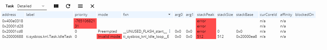

    And the associated Task Stacks:
    0x400e0318 is suppose to be the SDI task
    0x20001d28 app stack
    0x20001cd8 gapRoleSTack stack
    I have increased the size of the idleTask stack to 4096 but the issue persists with the same outcome. I don't think the size is the issue but just a symptom.

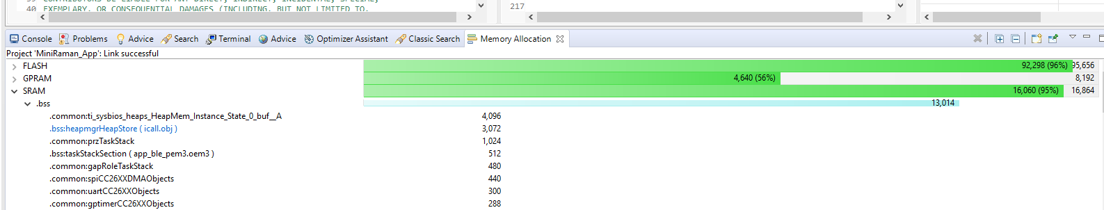

    Also to note, ive shuffled my memory to use GPCache and the Sensor Cache:

      #define ENTRY_END               FLASH_START + FLASH_SIZE - RESERVED_FLASH_SIZE - 1
      #define ENTRY_START             ENTRY_END - ENTRY_SIZE + 1
      #define FLASH_END               ENTRY_START - 1
    #else
      #define  OAD_HDR_START          0
      #define  OAD_HDR_SIZE           0x50
      #define  OAD_HDR_END            OAD_HDR_START + OAD_HDR_SIZE - 1
      #define ENTRY_START             OAD_HDR_END + 1
      #define ENTRY_SIZE              0x40
      #define ENTRY_END               ENTRY_START + ENTRY_SIZE - 1
      #define FLASH_START             ENTRY_END + 1
      #define FLASH_END               ICALL_STACK0_START - 1
    #endif
     * Stack
    /* Create global constant that points to top of stack */
    /* CCS: Change stack size under Project Properties    */
    __STACK_TOP = __stack + __STACK_SIZE;
     * GPRAM
    #ifdef CACHE_AS_RAM
      #define GPRAM_START             GPRAM_BASE
      #define GPRAM_END               (GPRAM_START + GPRAM_SIZE - 1)
    #endif /* CACHE_AS_RAM */
     * Main arguments
    /* Allow main() to take args */
    /* --args 0x8 */
     * ROV
     * These symbols are used by ROV2 to extend the valid memory regions on device.
     * Without these defines, ROV will encounter a Java exception when using an
     * autosized heap. This is a posted workaround for a known limitation of
     * RTSC/rta. See: bugs.eclipse.org/.../show_bug.cgi
     * Note: these do not affect placement in RAM or FLASH, they are only used
     * by ROV2, see the BLE Stack User's Guide for more info on a workaround
     * for ROV Classic
    __UNUSED_SRAM_start__ = 0x20000000;
    __UNUSED_SRAM_end__ = 0x20005000;
    __UNUSED_FLASH_start__ = 0;
    __UNUSED_FLASH_end__ = 0x1FFFF;
     * System Memory Map
    MEMORY
      /* EDITOR'S NOTE:
       * the FLASH and SRAM lengths can be changed by defining
       * ICALL_STACK0_START or ICALL_RAM0_START in
       * Properties->ARM Linker->Advanced Options->Command File Preprocessing.
      FLASH (RX) : origin = FLASH_START, length = ((FLASH_END - FLASH_START) + 1)
      ENTRY (RX) : origin = ENTRY_START, length = ENTRY_SIZE
    #ifndef OAD_IMG_A
      FLASH_IMG_HDR (RX) : origin = OAD_HDR_START, length = OAD_HDR_SIZE
    #endif
      #ifdef ICALL_RAM0_START
          SRAM (RWX) : origin = RAM_START, length = ICALL_RAM0_START - RAM_START
      #else
          SRAM (RWX) : origin = RAM_START, length = RAM_END - RAM_START + 1
      #endif
      #ifdef CACHE_AS_RAM
        GPRAM (RWX) : origin = GPRAM_START, length = GPRAM_SIZE
      #ifdef AUX_AS_RAM
        AUX_RAM (RWX) : origin = AUX_RAM_BASE, length = AUX_RAM_SIZE
      #endif /* AUX_AS_RAM */
     * Section Allocation in Memory
    SECTIONS
    #ifdef OAD_IMG_A
      GROUP >  FLASH(HIGH)
        .image_header align PAGE_SIZE
        .text
        .const
        .constdata
        .rodata
        .emb_text
        .init_array
        .cinit
        .pinit
      }LOAD_END(flashEndAddr)
      GROUP > ENTRY
        .resetVecs
        .intvecs
        EntrySection  LOAD_START(prgEntryAddr)
    #else   // OAD_IMG_B || OAD_IMG_E
      GROUP > FLASH_IMG_HDR
      GROUP > ENTRY
        .resetVecs
        .intvecs
      GROUP >>  FLASH
        .text
        .const
        .constdata
        .rodata
        .emb_text
        .pinit
      .cinit        : > FLASH LOAD_END(flashEndAddr)
    #endif // OAD_IMG_A
     GROUP > SRAM
        .data LOAD_START(ramStartHere)
        .bss
        .vtable
        .vtable_ram
        vtable_ram
        .sysmem
        .nonretenvar
      } LOAD_END(heapStart)
      .stack            :   >  SRAM (HIGH) LOAD_START(heapEnd)
        #ifdef CACHE_AS_RAM
      reorganized_into_gpcache
         icall.obj(.data)
         icall.obj(.bss)
    //     device_information.obj(.data)
         notification.obj(.data)
    //     request.obj(.data)
    //     spectrum_data.obj(.data)
         SRI_Global.obj(.data)
         CommandHandler.obj(.data)
         RFCC26XX_singleMode.obj(.bss)
       } > GPRAM
      #ifdef AUX_AS_RAM
      reorganized_into_auxram
        sdi_task.obj(.data)
        sdi_task.obj(.bss)
    	sdi_rxbuf.obj(.bss)
    	sdi_tl_uart.obj(.bss)
    	sdi_tl.obj(.bss)
    	sdi_tl.obj(.data)
        } > AUX_RAM
    	#endif/* AUX_AS_RAM */

    Thanks for the reply.
    Yes, i am using the 1_40_00_45 SDK.
    I tried using the Flash Programmer to write all images (BIM, STACK, APP) but with the same out come.
    One difference i just noticed was the with the ProjectZero app, the ICall Heap was allocated in the remaining SRAM space.
    And with the Simple Peripheral Off-Chip OAD Example, it appears i now have explicit secotrs defined:
    .bss:heapmgrHeapStore
    .common:ti_sysbios_heaps_HeapMem_Instance_State_0_buf_A
    This could be causing issues since my App did require a large Heap. But then again, I never make it into the App main() fxn.
    I thought the heap would have been the same with both projects.
    I did however set OSAL_SNV = 0, not sure if that would affect the heap though.
    Thank you again!
    Brett

  • The icall.obj object from above was originally placed in GPCache, we can ignore that.
    I've placed in back in GPCache to free room in SRAM for the Heap.
    Im still confused on what .common:ti_sysbios_heaps_HeapMem_Instance_State_0_buf__A is though..
  • Just an update, i had removed
    utils.importFile("common/cc26xx/kernel/cc2640/config/ble_stack_heap.cfg");
    from my app_ble.cfg which created that heap in SRAM. Im back to the dynamically allocated shared heap.
  • My memory discrepancies are back to normal, i had caused them by removing utils.importFile("common/cc26xx/kernel/cc2640/config/ble_stack_heap.cfg"); from app_ble.config.
    I have also moved the icall.obj to GPCache so that my heap has plenty of room.
    Im back to the original issue i cant seem to get past: From the ROV Bios Erros:
    ti.sysbios.knl.Task	Basic	(0x20001d10)	mode	Invalid mode: 4
    ti.sysbios.knl.Task	Detailed	(0x20001d10)	mode	Invalid mode: 4
    ti.sysbios.knl.Semaphore	Basic	(0x200017f4)	pendElems	Error: Problem scanning pend Queue: JavaException: java.lang.Exception: Target memory read failed at address: 0xffffffff, length: 8 This read is at an INVALID address according to the application's section map. The application is likely either uninitialized or corrupt.
    ti.sysbios.knl.Semaphore	Basic	(0x20001514)	pendElems	Error: Problem scanning pend Queue: JavaException: java.lang.Exception: Target memory read failed at address: 0x1210068, length: 8 This read is at an INVALID address according to the application's section map. The application is likely either uninitialized or corrupt.
    ti.sysbios.knl.Task	Detailed	(0x20001d10)	stackPeak	Error: Problem fetching Task stack: JavaException: java.lang.IndexOutOfBoundsException: null
    ti.sysbios.knl.Task	Detailed	(0x400e0318)	stackPeak	Error: Problem fetching Task stack: JavaException: java.lang.Exception: Target memory read failed at address: 0xd24fdbc9, length: 935677696 This read is at an INVALID address according to the application's section map. The application is likely either uninitialized or corrupt.
    ti.sysbios.knl.Task	Detailed	(0x20001cc0)	stackPeak	Error: Problem fetching Task stack: Error: fetchArray called with length 0.
    ti.sysbios.knl.Task	Basic	(0x20001cc0)	priority	Corrupted data: Task priority is greater than Task.numPriorities
    ti.sysbios.knl.Task	Detailed	(0x20001cc0)	priority	Corrupted data: Task priority is greater than Task.numPriorities
    ti.sysbios.family.arm.m3.Hwi	Basic	(0x2000089c)	N/A	Caught exception in view init code: "C:/ti/xdctools_3_50_02_20_core/packages/xdc/rov/StructureDecoder.xs", line 547: java.lang.Exception: Target memory read failed at address: 0xe0b4f8df, length: 200 This read is at an INVALID address according to the application's section map. The application is likely either uninitialized or corrupt.
    ti.sysbios.knl.Queue	Basic	ti.sysbios.knl.Queue@2000202c	N/A	Caught exception in view init code: "C:/ti/xdctools_3_50_02_20_core/packages/xdc/rov/StructureDecoder.xs", line 518: java.lang.Exception: Target memory read failed at address: 0xf5a002b5, length: 8 This read is at an INVALID address according to the application's section map. The application is likely either uninitialized or corrupt.
    ti.sysbios.knl.Queue	Basic	ti.sysbios.knl.Queue@20002020	N/A	Caught exception in view init code: "C:/ti/xdctools_3_50_02_20_core/packages/xdc/rov/StructureDecoder.xs", line 518: java.lang.Exception: Target memory read failed at address: 0x2044414f, length: 8 This read is at an INVALID address according to the application's section map. The application is likely either uninitialized or corrupt.
    ti.sysbios.knl.Clock	Module	N/A	N/A	Caught exception in view init code: "C:/ti/xdctools_3_50_02_20_core/packages/xdc/rov/StructureDecoder.xs", line 518: java.lang.Exception: Target memory read failed at address: 0x11001248, length: 32 This read is at a VALID address according to the application's section map, but the DebugServer memory read failed.
  •   Not sure if these help or not:
