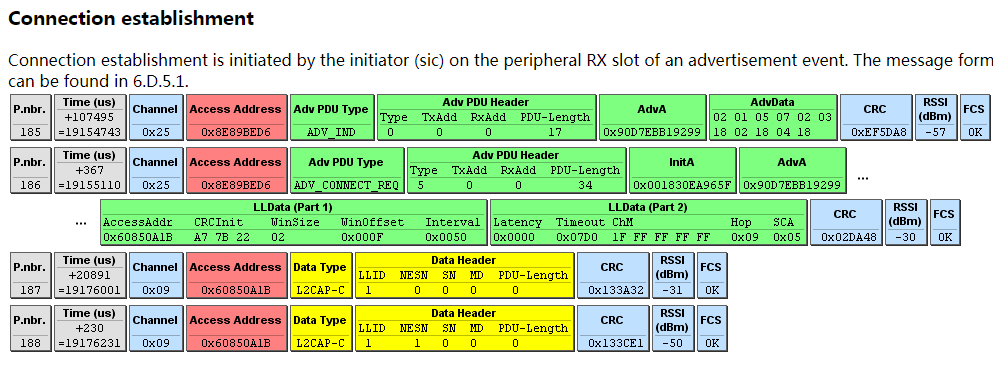

(1)Running the simple_peripheral project in CC2640 LAUNCHPAD .Serial port assistant shows CC2640 is advertising , as shown in picture 1 .
picture 1

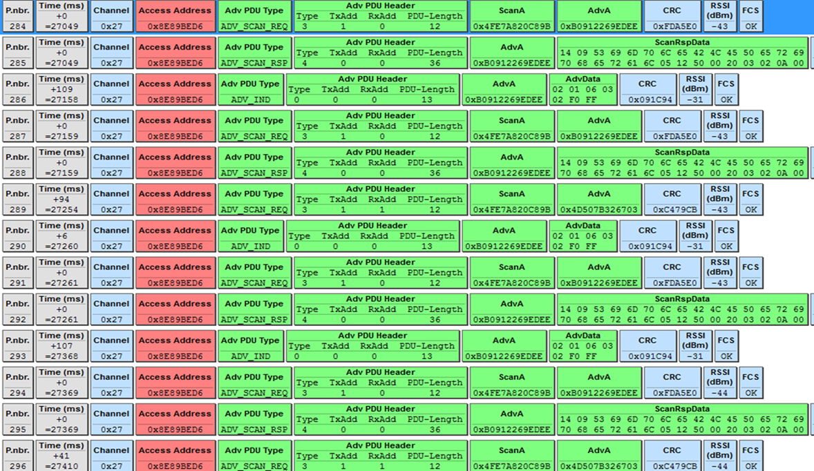

(2)Scaning CC2640 in BLE SCANNER on android phone , as shown in picture 2.
picture 2
(3)press the "CONNECT " button . However , serial port assistant shows connecting fail , as shown in picture 1.
(4)CC2640 enters in "GAPROLE_WAITING" .Then CC2640 stops advertising , as shown in picture 1.

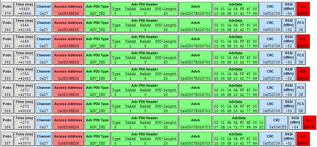

3、analysis of packet sniffer
(1)using packet sniffer , several packets about “Scan request / response” has been captured , as shown in picture 3 .

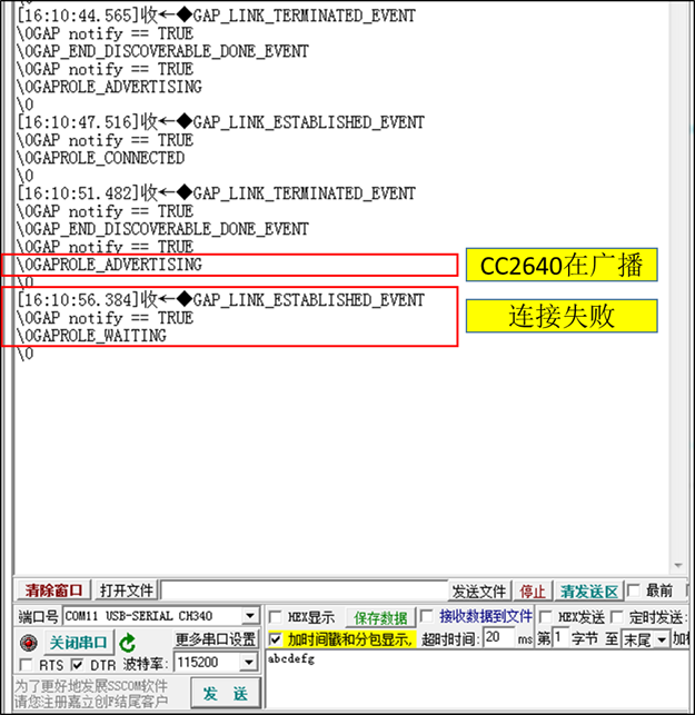

(2)several packets about "FCS = ERROR" has been captured , as shown in picture 4 . No packets about “Connection establishment” has been captured .
picture 4

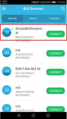

(3)according to the "BLE sniffer guide ", packets about “Connection establishment” can be captured , as shown in picture 5.
picture 5

  • When connecting CC2640 with android phone , it may shows "connecting fail" . This problem cannot be completely resolved , as android system is opensource .
    In the failure case, it appears that you have failed to capture the connect request using the TI-sniffer. Because the TI sniffer will use a round robin scheme for scanning the advertising channels for a connect request, the most failsafe way is to use 3x dongles and configure each to use only one advertising channel. Then chance of catching the connect request is much higher.
    Another case is that it is possible that your android phone does not see the phone when entering the initiating state. When a device tries to enter a connection it will scan (usually in a higher duty cycle) for the device is is looking for. If the initiating device does not see the advertiser it is attempting to connect to then the connect request will not be sent.
    Can you attempt to try the following?
    - Run the test again with 3x sniffers (one per channel) and see if a connect request is sent
    - Try to change the advertising rate of the peripheral device and see if the connection rate is better.
