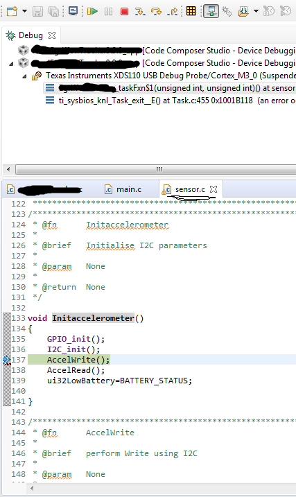

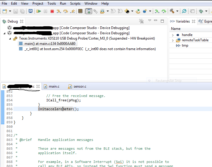

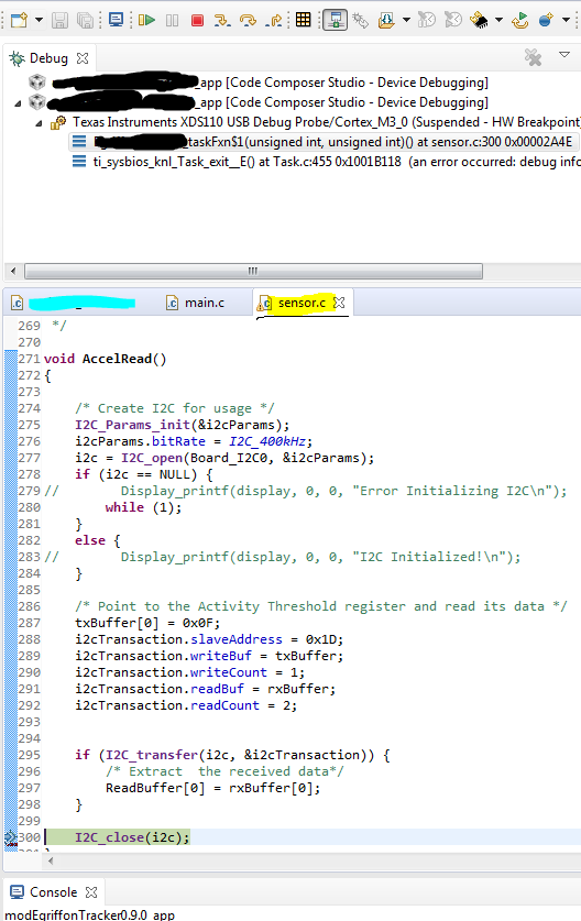

  • Are you sure you application code is including "sensor.h" and is using your code? Simply adding your *.h and *.c files does not magically include and use your code, your application has to.
    I do understand *.h and *.c file doesn't get magically added, but i have already added sensor.h file in my application code,
    Also i have checked that the functions from sensor.c file are linked with my application code,
    i have checked it by adding a break point in sensor.c file so when i run the code the compiler goes to the break point in sensor.c file when the functions from it are called in the project zero.c file,
    But the issue is that some part of the code is not working properly which are working fine if remove the modular part of the code,
    And also the device gets disconnected from the BLE Scanner application and functionality also doesn't works properly.
    I have attached the images where the code is going to Break point in sensor.c file
    So how can resolve this issue
    Thanks and Regards
    Utkarsh
