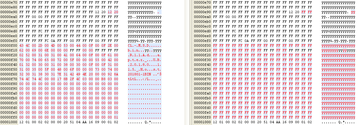

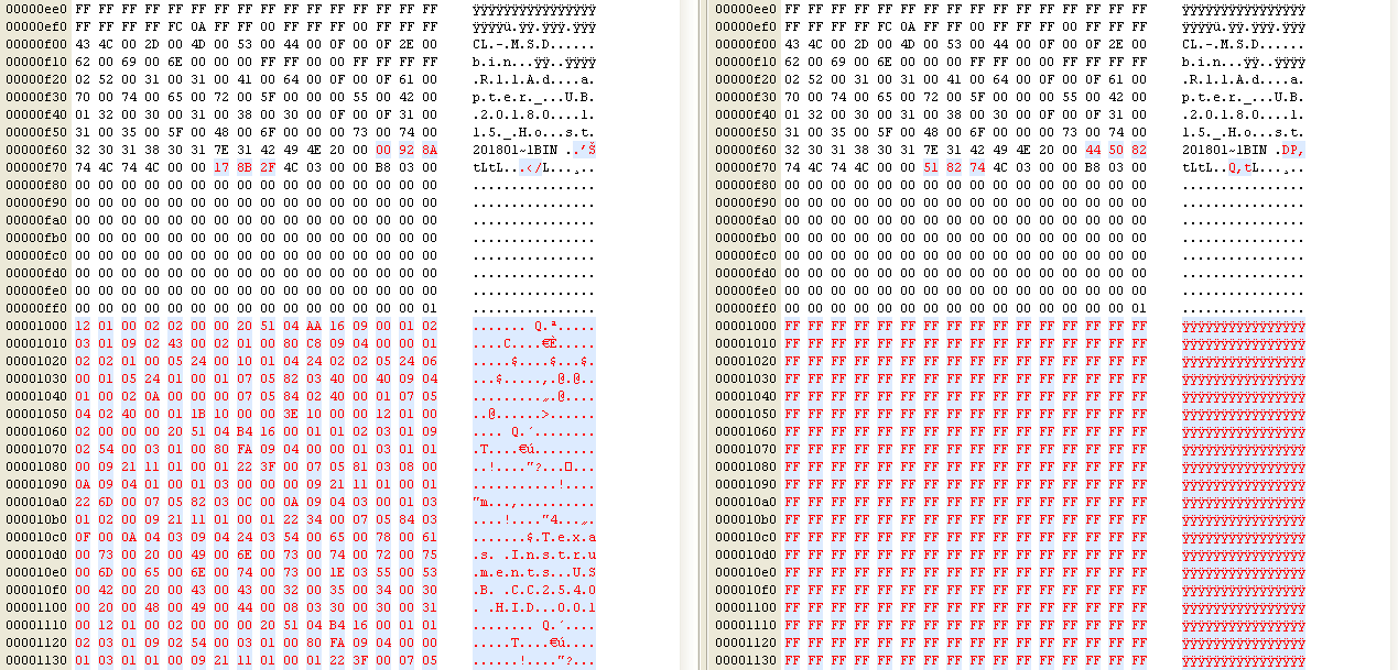

    Thanks for your answer first.And the differences between normal and bad image file as follows:
    1.from 00001000 to 00015000 total 80KB image codes lost ,instead by FF.
    2.The right crc shadow 0x2012 ocupied by 0xFFFF,and the file name space has the same problem.

  • Situation one is our customer using it good for the beginning ,but after several days later during using it on work,it suddenly did not work.I read out the contents from the flash and find out that the right crc shadow 0x2012 ocupied by 0xFFFF,and the file name space has the same problem.
    Situation two is the first time using the dongle it works fine,but serval days later inserting it in the usb interface for the second time,it does not work.I read out the contents from the flash and find out that from 00001000 to 00015000 total 80KB image codes lost ,instead by FF.

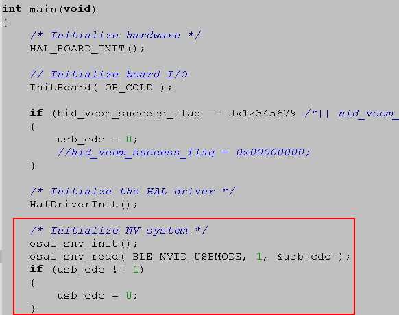

  • The NVS driver could erase a page, do you have an example of the API calls you use?

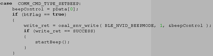

  • The first time I use the read flash api as follows:
    The firsttime I use the write flash api as follows:
    Api function osal_snv_read() and osal_snv_write()you can find it in the stack BLE-CC254x-1.3.2.

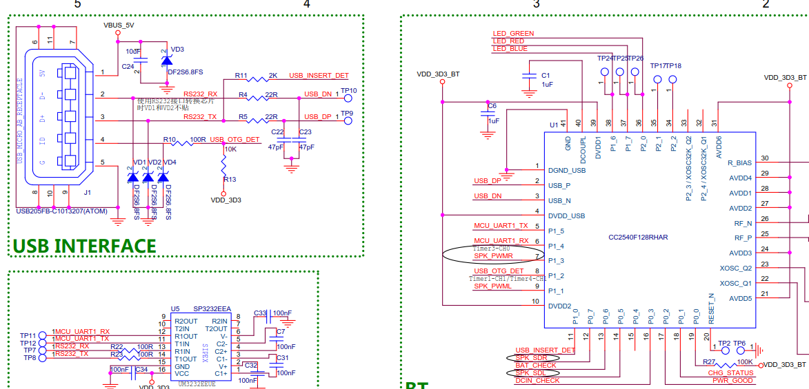

  • If it only happens on a few devices, I'm interested in knowing the details around the hardware design. Have you followed out HW reference design for USB dongle? (CC2540EMK-USB)
  • Our dongle  Circuit schematic diagram as follows.Are there any problems?
  • From what I can see the CFG-DISCS section (referring to Universal Boot Loader for SoC-8051 by USB-MSD Developer's Guide) can set a GPIO. What is this struct defined as in your case? If you have defined a GPIO that is floating this could lead to issues.
