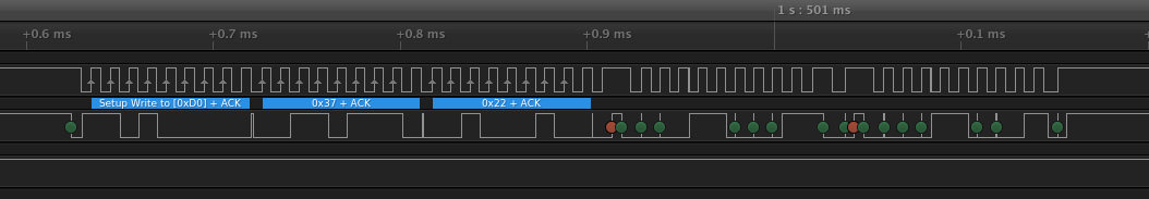

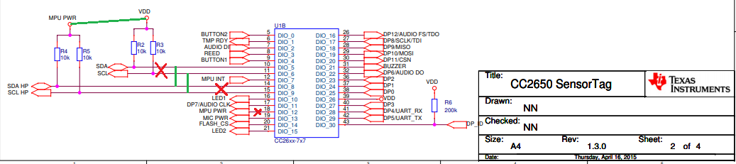

I am trying to communicate with an MPU9250 via the sensor controller. I have a gy-91 breakout board that combines a BMP280 and MPU9250 connected to a 2650 launchpad.
I have no trouble reading the BMP280, but on the 2nd i2c transaction with the MPU9250, I get a i2cstatus of 1. I can read the whoami byte from the 9250, but anything after that fails.
Any idea on how to troubleshoot this without a oscilloscope?
i2cStart();
i2cTx(I2C_OP_WRITE | (MPU9250_I2C_ADDR<<1));
i2cTx(MPU9250_WHO_AM_I); //WHO_AM_I is the register for device ID
i2cRepeatedStart();
i2cTx(I2C_OP_READ | (MPU9250_I2C_ADDR<<1));
i2cRxAck(output.whoamiMPU9250);
i2cStop();
i2cStart();
i2cTx(MPU9250_WHO_AM_I); //<<<<<< fails here with i2cstatus on 1
i2cRepeatedStart();
i2cStop();
