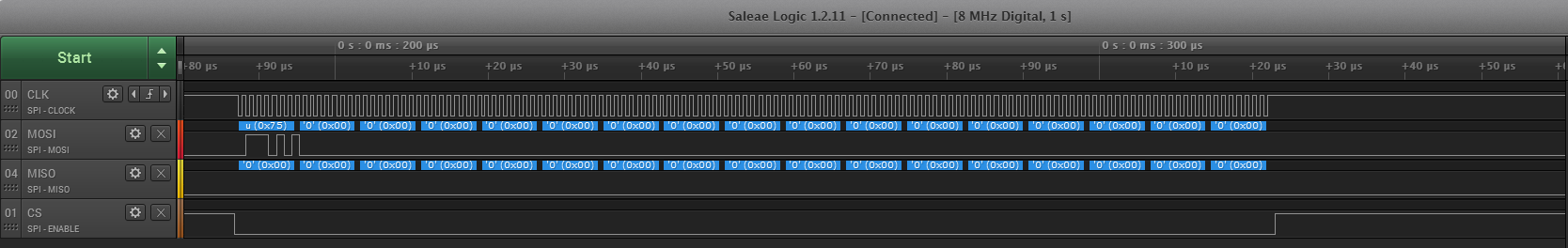

  • Ohad,
    This is what you're trying to do, correct?
    I have the value 0x75 as if it is the register address. After the register address there are 16 transactions left open while keeping CS low until the end. I don't have anything coming in on the MISO since I have nothing to read from but in your case you'd expect data from whatever you are reading from.
    This is all done with the following. Is there anything different than what you have?:
    SPI_Transaction spiTransaction;
    // Init SPI and specify non-default parameters
    SPI_Params_init(&spiParams);
    spiParams.bitRate     = 1000000;
    spiParams.frameFormat = SPI_POL1_PHA1;
    spiParams.mode        = SPI_MASTER;
    spiTransaction.count = 17;    // sizeof(rxBuf) could work too
    spiTransaction.txBuf = txBuf; // txBuf with the register address in it
    spiTransaction.rxBuf = rxBuf; // rxBuf empty array of appropriate size
    // Open the SPI and perform the transfer
    spiHandle = SPI_open(Board_SPI0, &spiParams);
    SPI_transfer(spiHandle, &spiTransaction);
    -Sy Su
