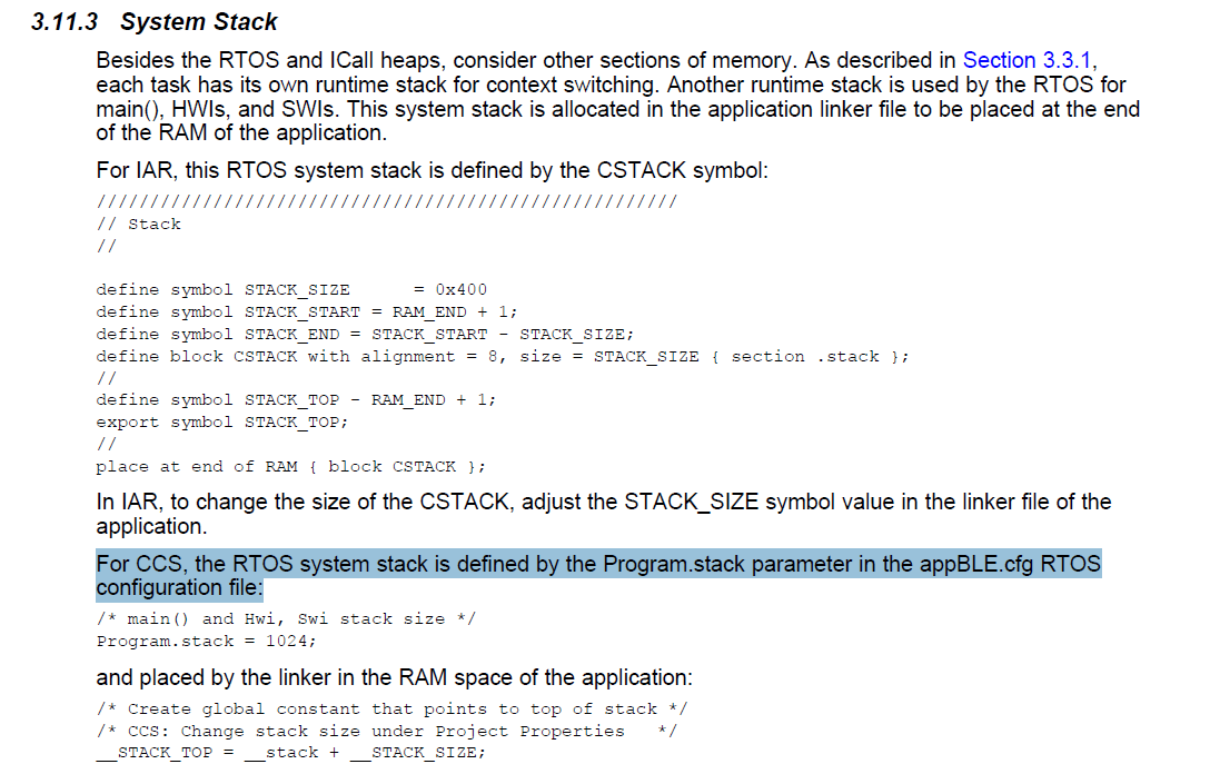

I try to adjust the stack size from 1K to 2K in my modified simple_peripheral_2650lp  project linker settings the project settings but it seems to have no effect.
The stack size in the map is unaffected. Is this overridden somewhere?

    Are you making changes in the cc26xx_app.cmd file, found in the TOOLS folder of the simple_peripheral_cc2640r2lp_app? You can see in the comments at the top of this file that it says:
    /* The following command line options are set as part of the CCS project.    */
    /* If you are building using the command line, or for some reason want to    */
    /* define them here, you can uncomment and modify these lines as needed.     */
    /* If you are using CCS for building, it is probably better to make any such */
    /* modifications in your CCS project and leave this file alone.              */
    /* --heap_size=0                                                             */
    /* --stack_size=256                                                          */
    /* --library=rtsv7M3_T_le_eabi.lib                                           */
    Is that where you made your change to the linker? I think as it suggests, it is better not to change the linker file at all but rather to change the CCS project settings. Stack size is configured in project > properties > Build > ARM Linker > Basic Options, you'll see a spot for "Set C system stack size".
    Katie
  • In addition, please see Sec 3.11.3 "System Stack" in the BLE SW Developer's Guide SWRU393 for adjusting the system stack via the Program.stack parameter:
