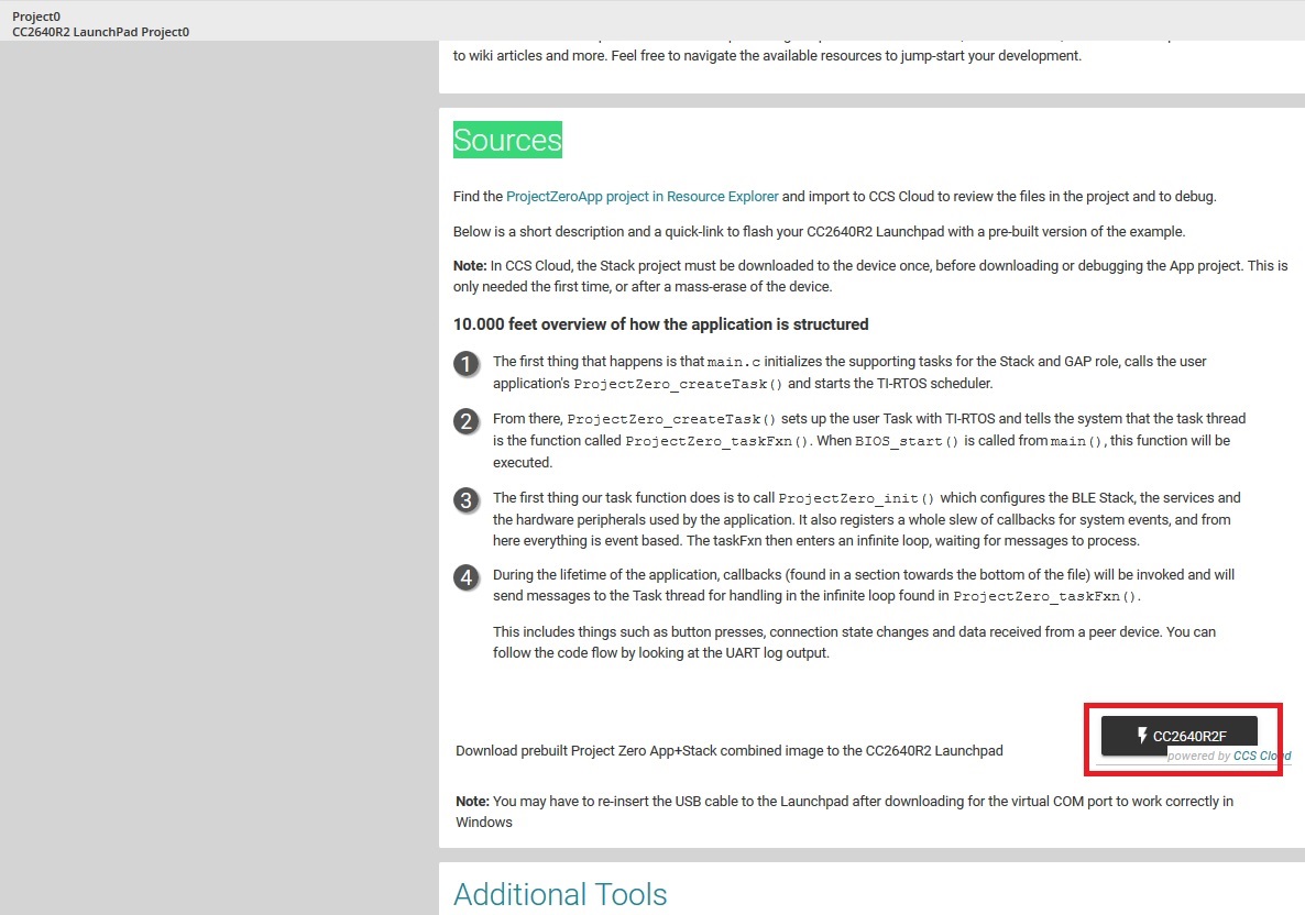

         2. when i read  the ProjectZero guide, There is a notes of start step 2  which write like this “Program your LaunchPad by pressing on the button in the Sources section.”
              what is  the “Sources section”  , anyway  there is  a lot the message in the putty windows ,why my board just give a little?

    2. There is a CC2640R2F button at the end of Source section. If you click it, it will invoke CCS could to download binary to your LAUNCHXL-CC2640R2F from CCS cloud. I don't think this would work in China.
