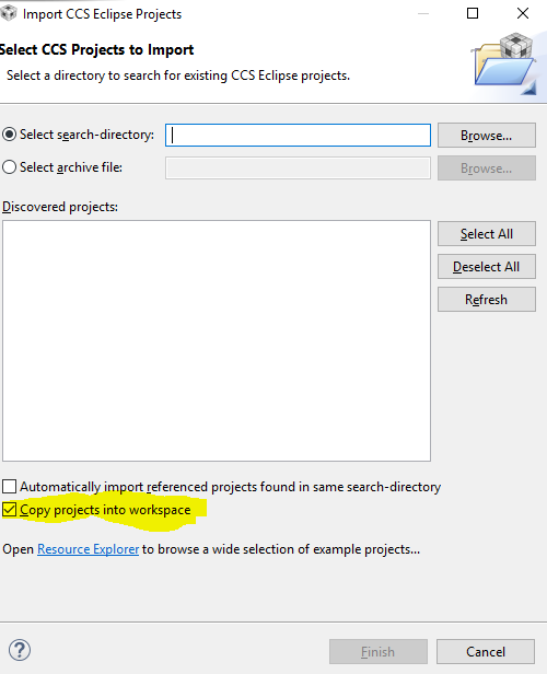

  2. I couldn't obtain a local copy of the example fully independent from the copy installed with the stack. This would be desirable because I don't want to reinstall the stack if I mess too much with the example and cannot get it to compile anymore. Was this even possible with version 6.2? I think it is with v7.3.

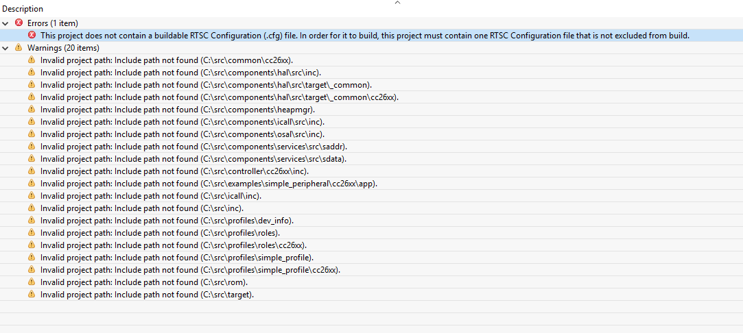

  4. When I try to build the stack and the application, the following errors and warnings appear:
stack:
app:
Other projects of the same folder give similar errors. I have also tried to use the Project Zero as a starting point but even there many errors appear. How can I solve these errors?
      1. Yes, it's possible with CCS 6.2, but again, you can just use v7.3 as long as the compiler version is the same
      1. where did you download TI SDK? If you change the folder structure, you will have to rewrite the project spec in order to find those files.The default folder should be in c:/ti
