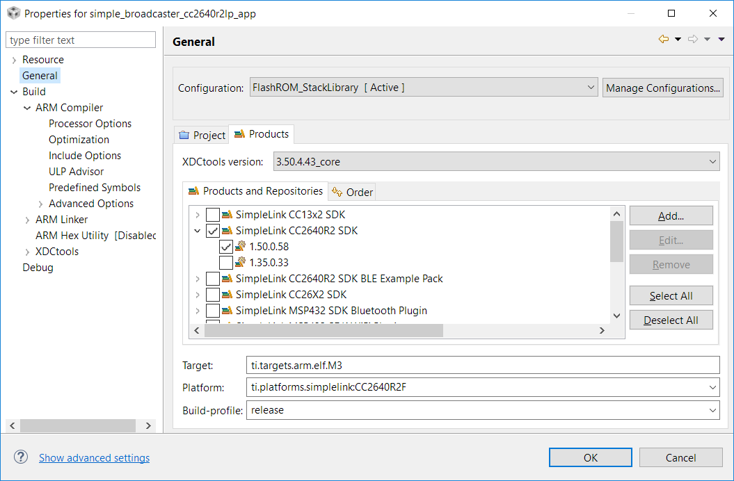

  • Hi Arun,
    Did you manually set the "Other Repositories"? Can you try unchecking the last two and checking the needed SimpleLink products instead?

  • Hi Joe,
     This is what I have:
    Could try importing the project again in a brand new workspace??
      Hopefully this helps.
        David
