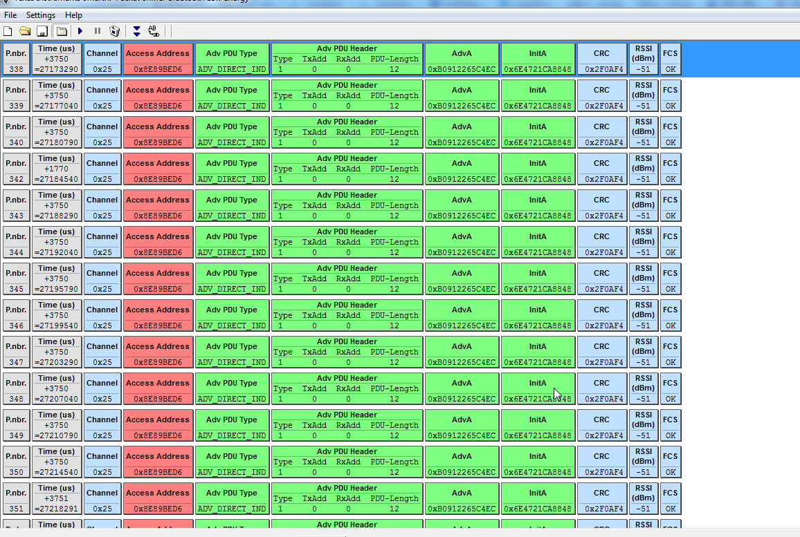

  • Hi Evan,
    I have added changes as you suggested, the advertisement changes to ADV_DIREC_IND type .
    But i can view the device in sniffer only, Central device not able to list ADV_DIREC_IND advertisement type devices .
    How i can add address of Central device(initiator) in payload to view the Directed advertisement devices by central device (initiator)?
    Is there any changes required in central side (or) broadcaster side?
    Please provide some solution.

  • Hi Evan,
    I have modified the code as you suggested in the broadcaster.c file , in that i added the "MAC address of central device".
    Still i am not able to see the advertisement in Central device , but can able to see via sniffer.
    Sniffer shows both slave and initiator address.
    Attached the sniffer data here.
    Thanks and Regards,
    Jayachandran R

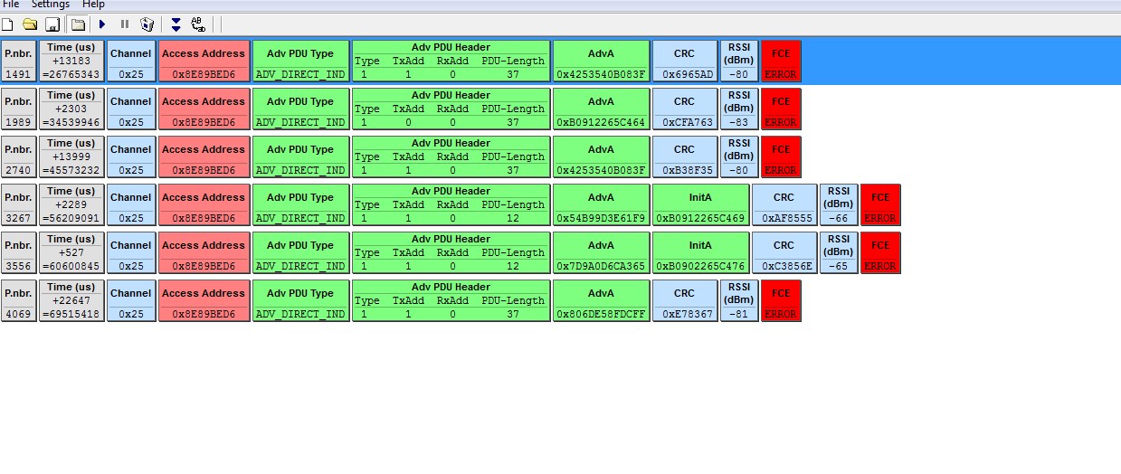

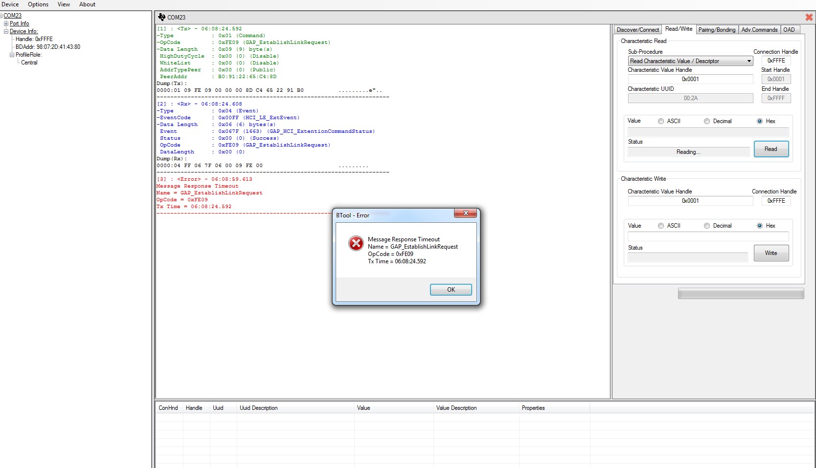

  • Hi evan,
    Test Program : SimpleBLEPeripheral  example project.
    Peripheral role : Device CC2650R2F -> MAC  ID  [B0:91:22:65:C4:8D].
    Central Role :  Host test program with launch pad -> MAC ID [98:07:2D:41:43:80].
    I took SimpleBLEPeripheral example project and modified code for directed advertisement , i did following steps,
    1.In peripheral.c file  in  gapRole_init() function modified to gapRole_AdvEventType = GAP_ADTYPE_ADV_HDC_DIRECT_IND;
    2.In peripheral.c file  static variable   gapRole_AdvDirectAddr[B_ADDR_LEN] assigned with Initiator address (Central Role mac ID)  {0x80, 0x43, 0x41, 0x2D, 0x07, 0x98}.
    3.SimpleBLEPeripheral.c file added following code in SimpleBLEPeripheral_init function.
    uint8 desired_adv_event_type = GAP_ADTYPE_ADV_HDC_DIRECT_IND;
    uint8 desired_adv_direct_addr[] =
       0x3C,
       0x2D,
       0xB7,
       0x85,
       0xEE,
       0xFE
     GAPRole_SetParameter( GAPROLE_ADV_EVENT_TYPE, sizeof( uint8 ), &desired_adv_event_type );
     GAPRole_SetParameter( GAPROLE_ADV_DIRECT_ADDR, B_ADDR_LEN, desired_adv_direct_addr );
    Found Following Observation :
    1.While Sniffing the data using sniffer ,Advertisement PDU is not proper and shows FCE error at end .
       With Broadcaster example project the sniffer logs are looking good .
       Please refer sniffer data attached.
    2.Established the connection using central device , But connection is not established.
       please refer the  Btool log.
    Is code changes are correct? how i can test this code using Btool with Host test program?
    Please provide some suggestion on this .
    Thanks and regards,
    Jayachandran r
  • Jayachandran,
    Let me look into this a bit more in depth. The device that you're running Btool with is running central or host test?
  • Hi Evan,
    I used host test app!
    hex file flashed is host_test_cc2650lp_app.hex and host_test_cc2650lp_stack.hex in launchpad.
  • Hi Evan,
    Now the Directed Advertising is working fine.
    The problem i gave wrong peer address in ADV PDU (in reverse order), after corrected the PDU now it is working.
    But i am giving Fixed Peer Address in the ADV PDU.
    How i can change the Peer Address Dynamically? , Because Over the period of device life time i need to change central device.
    Thanks and Regards,
    Jayachandran R

    Please help me on this .
    Thanks and regards,
    Jayachandran R
