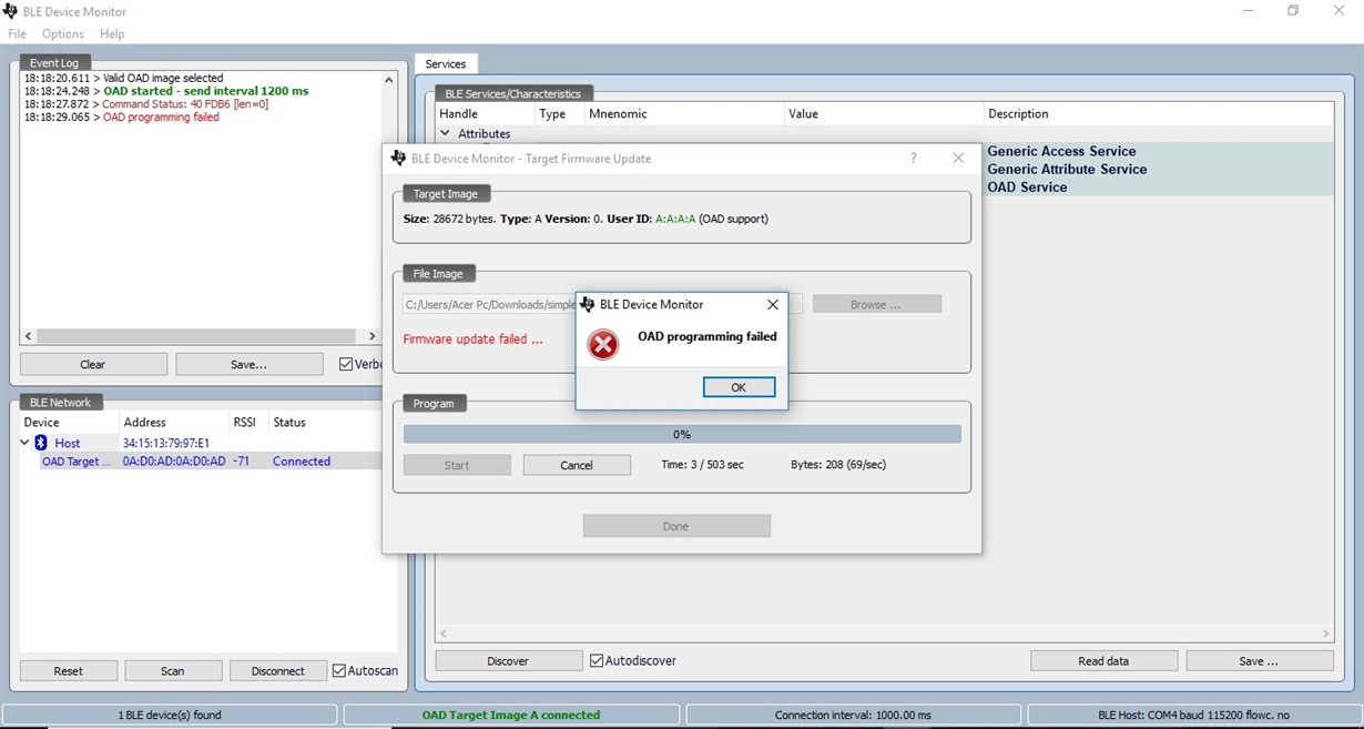

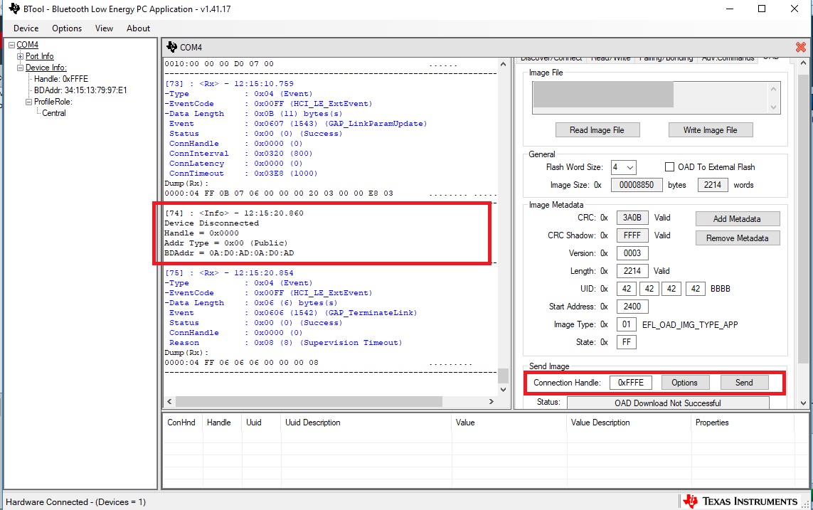

    But when connected through BTool and CC2650 USB Dongle, it automatically disconnects after a few seconds (before even initiating the OAD process).
    It gets stuck at step "OAD Send UUID Info Discovery" for few seconds, then gets disconnected and shows "OAD Download Not Successful".
    Disconnection is random and does not depend on any ongoing process. I searched online and it seems that my BTool version does not match with the firmware in my CC2650 USB Dongle.
    I have "ble_sdk_2_02_01_18" and I have downloaded the host_text hex file from the same SDK version. As there's no OAD option in the btool installed at "ble_sdk_2_02_01_18\tools\btool.exe" I am using the btool installed at "C:\ti\simplelink_cc2640r2_sdk_1_35_00_33\tools\blestack\btool".
    Is this the problem?

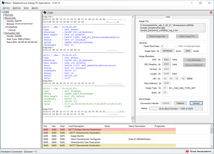

  • Hey,
    Just realized problem is whenever BTool receives 11 Bytes (follow the screenshot) from OAD Target, it gets stuck immediately. Normally, it receives 10 bytes and then 6 bytes during the OAD process.
    Not able to understand why is this happening??
    Any idea?

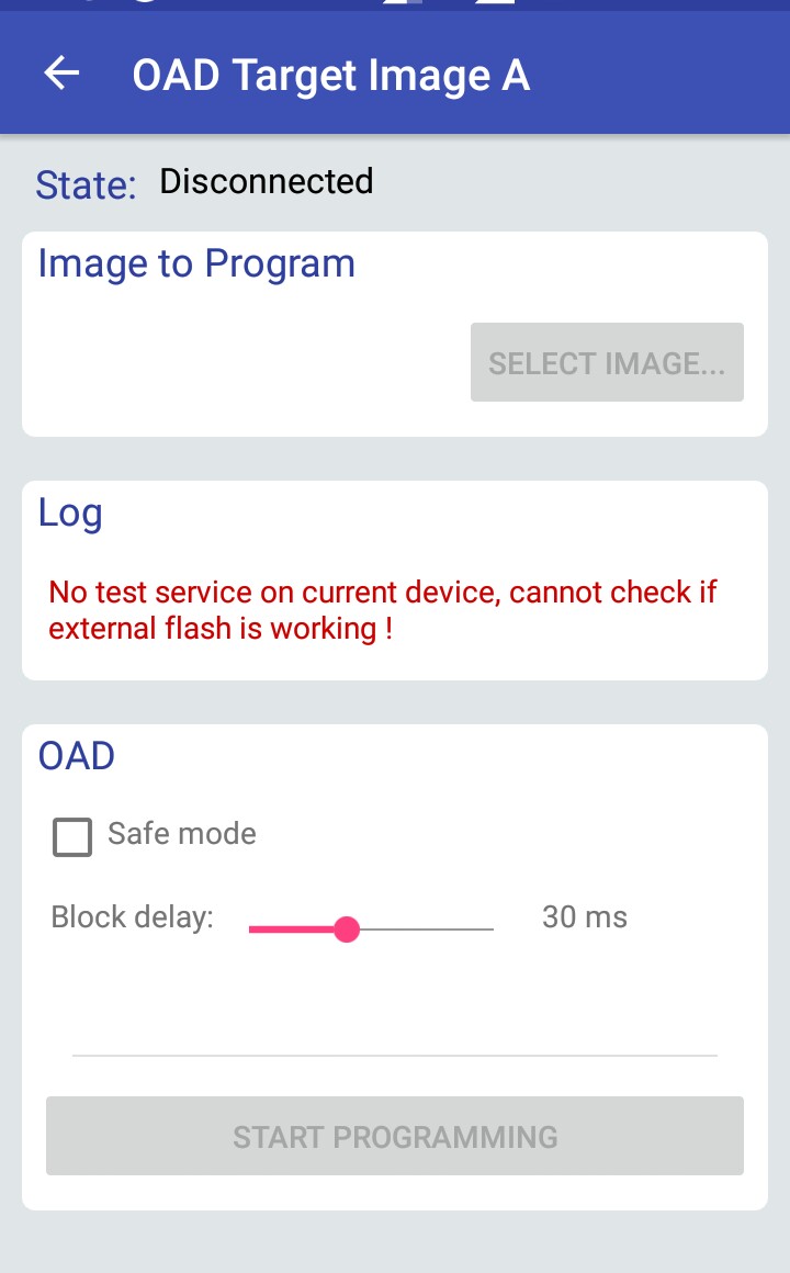

  • Hey Katie,
    Thanks for the reply.
    I am not sure if it is the problem with either Btool, BLE Device Monitor or CC2540 USB Dongle, because I just implemented the OAD Host Functionality in Android with following procedure (as given in OAD Guide):
    1. Connect to OAD_Target_Image_A.
    2. Search for OAD Service.
    3. Set notifications on for Image Notify, Image Block and Image Status characteristics.
    4. Read image header from bin file and write it on Image Notify characteristics.
    5. If target responds with image_block_index on Image Block characteristic, start reading 16-byte blocks of data from bin file and write on image block characteristic with index of current block.
    6. Wait for next block index from target on Image Block characteristic.
    7. Repeat 5.
    Following is the logcat output of some of my attempts:

    04-05 18:06:27.033 17518-17536/in.test.oadtest D/BluetoothGatt: onClientConnectionState() - status=8 clientIf=5 device=0A:D0:AD:0A:D0:AD //DISCONNECTED
    There is no pattern in disconnection. It disconnects randomly.
  • Well, trying with BLE Device Monitor gave me this output.
  • Same behavior in BLE Device Monitor too... Gets disconnected randomly.

    We solved the BLE being disconnected issue by changing the connection parameters to following:
     * CONSTANTS
    // Advertising interval when device is discoverable (units of 625us, 160=100ms)
    #define DEFAULT_ADVERTISING_INTERVAL          80
    // Limited discoverable mode advertises for 30.72s, and then stops
    // General discoverable mode advertises indefinitely
    #define DEFAULT_DISCOVERABLE_MODE             GAP_ADTYPE_FLAGS_GENERAL
    // Minimum connection interval (units of 1.25ms, 80=100ms) if automatic
    // parameter update request is enabled
    #define DEFAULT_DESIRED_MIN_CONN_INTERVAL     1024
    // Maximum connection interval (units of 1.25ms, 800=1000ms) if automatic
    #define DEFAULT_DESIRED_MAX_CONN_INTERVAL     2048
    // Slave latency to use if automatic parameter update request is enabled
    #define DEFAULT_DESIRED_SLAVE_LATENCY         0
    // Supervision timeout value (units of 10ms, 1000=10s) if automatic parameter
    // update request is enabled
    #define DEFAULT_DESIRED_CONN_TIMEOUT          100
    // Whether to enable automatic parameter update request when a connection is
    // formed
    #define DEFAULT_ENABLE_UPDATE_REQUEST         GAPROLE_LINK_PARAM_UPDATE_INITIATE_APP_PARAMS
    // Connection Pause Peripheral time value (in seconds)
    #define DEFAULT_CONN_PAUSE_PERIPHERAL         1
    // How often to perform periodic event (in msec)
    #define OTA_PERIODIC_EVT_PERIOD               20
    // The size of an OAD packet.
    #define OAD_PACKET_SIZE                       ((OAD_BLOCK_SIZE) + 2)
    // Task configuration
    #define OTA_TASK_PRIORITY                     1
    #ifndef OTA_TASK_STACK_SIZE
    #define OTA_TASK_STACK_SIZE                   644
    #endif
    // Internal Events for RTOS application
    #define OAD_STATE_CHANGE_EVT                  0x0001
    For Now, OAD from BTool is working smooth and perfect but with we're still facing the same issue with Android.
    We're following this repo : https://git.ti.com/ble-oad-android-source-code/ble-oad-android-source-code
    We've already cloned and built the repo but somehow we ended up getting the following error every time (Even after trying with hex file you sent).
    Please look into the issue ASAP. We want to start the production immediately.
    I've attached the Packet Sniffer's data while doing the OAD process with Android and CC2640.
    (It contains too many advertisement packets as I didn't know how to filter them but in middle somewhere you will find the data packets.)
    Please let us know if you find anything.
