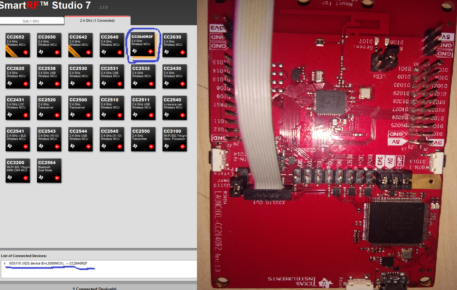

Now the issue is that i am trying to dump the firmware on my custom board using the XDS110 Debugger from the launchpad (i.e.,CC2640R2-LaunchXL) the connection is shown in image named as connections.jpg which is attached below
However  I can  see the device connected in Smart RF Studio.
But when i build and debug the code i get an error which is mentioned in image named as Errormsg.jpg which is attached below
So i not able understand where i am going wrong, so please help me with this so that i can dump my firmware in my Custom Board

  • Utkarsh,
    How are you powering your other board? Thanks for posting, sorry you're having issues.
  • Hello Evan,
    Thank You for replying,
    Currently while debugging power source for my custom board is 3.3V on JTAG cable apart from this there is no external power source wherein my launchpad is powered through USB.
    However i also have 3v coin cell battery connection option also but for debugging or dumping code i am not using battery.

  • Utkarash,
    Can you confirm that you see 3.3V powering your device?
    Also, be careful to review the schematic concerning your JTAG/SWD to make sure it's as accurate as possible to the schematic of the launchpad. Feel free to post a schematic if you want.
