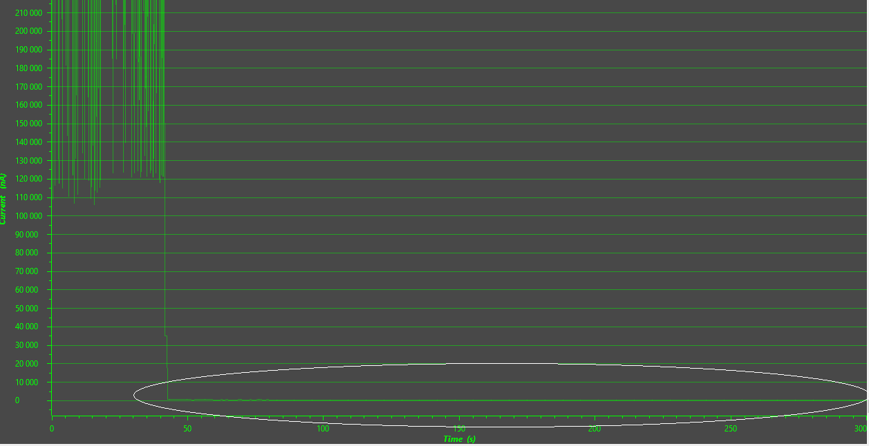

Help me understand.
1. CC2540F256RHA consumption  in the connected mode (w/o transmissions)     ~ 100 uA.  -good!
2. LAUNCHXL-CC2650 (thermometer example) in the connected mode                   ~ 200uA   - bad!
3. My custom board with CC2640F128RSM in the connected mode                            ~ 200uA   - bad!
In Shutdown mode my custom board CC2640F128RSM                                                < 1uA  - Good!
Measured by TI XDS110 Debuge Probe.
Why does CC2640 consume more than CC2540 in connected mode???
What can be done?
Alex
P.S.

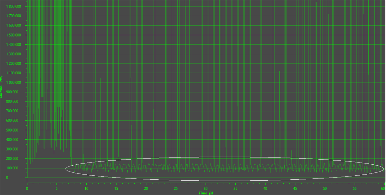

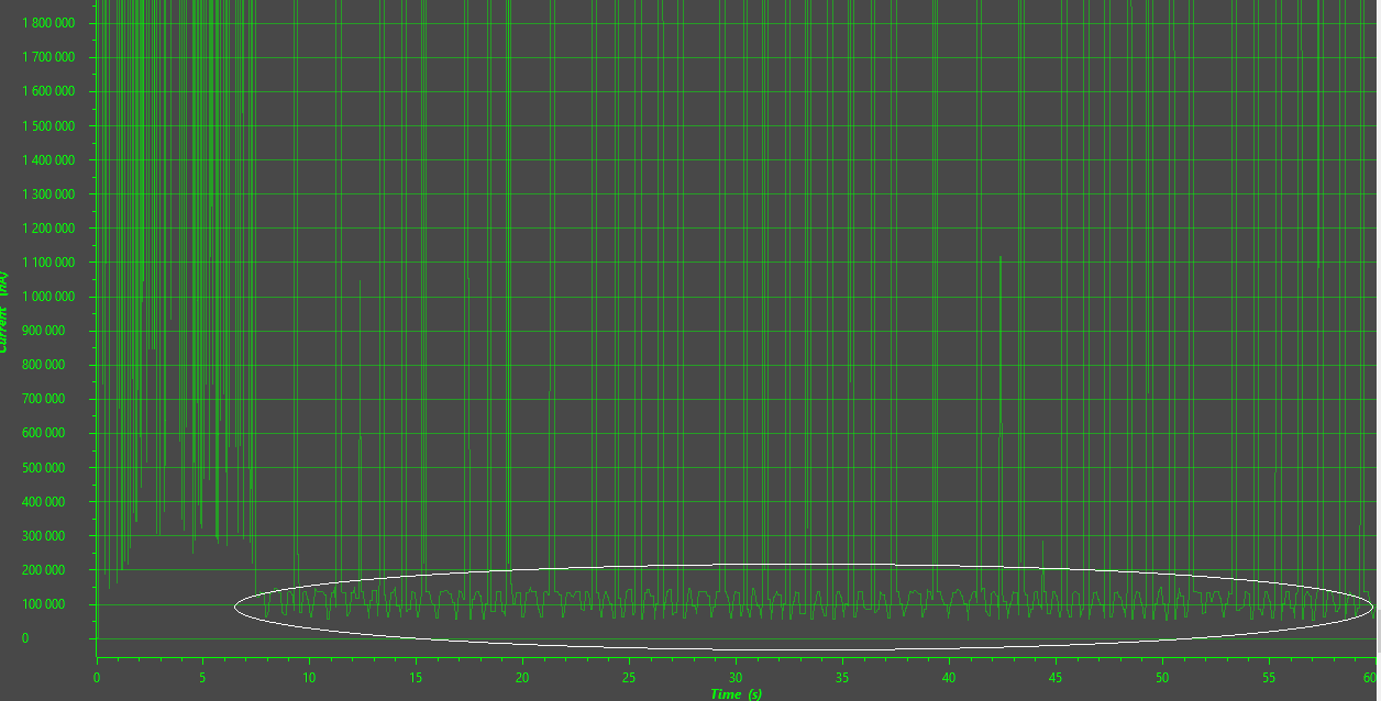

There are oscillograms.
  • Fig 0. CC2540 Connected 60sec

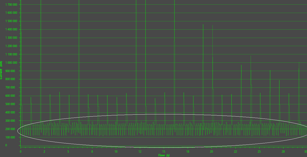

    Fig 1. LAUNCXL-CC2650 thermometer Connected 60sec

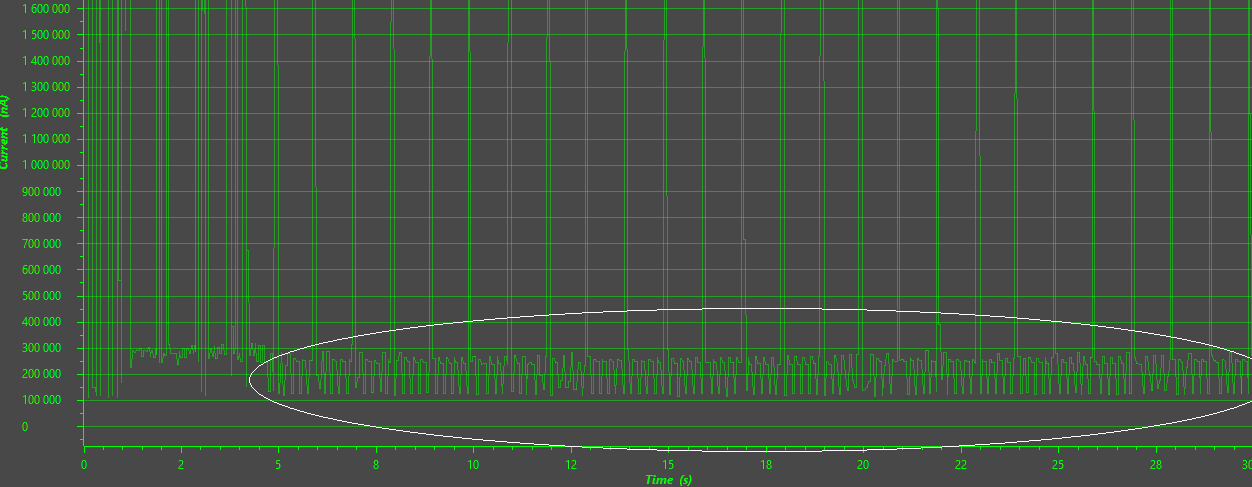

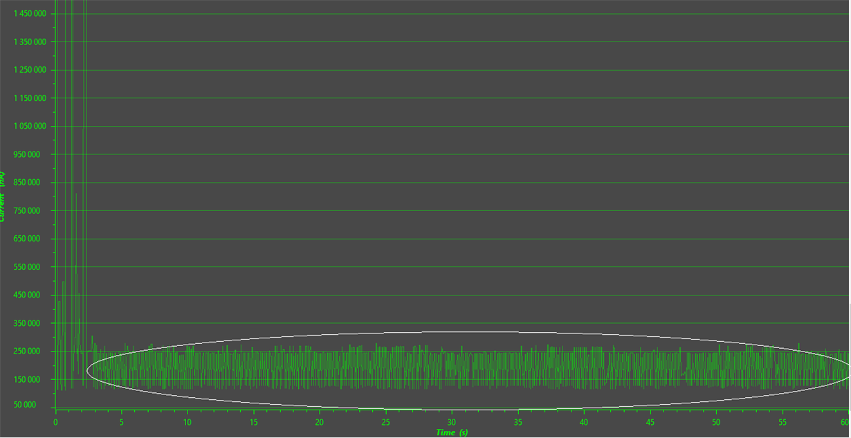

    Fig 2.CC2640 Connected 30sec

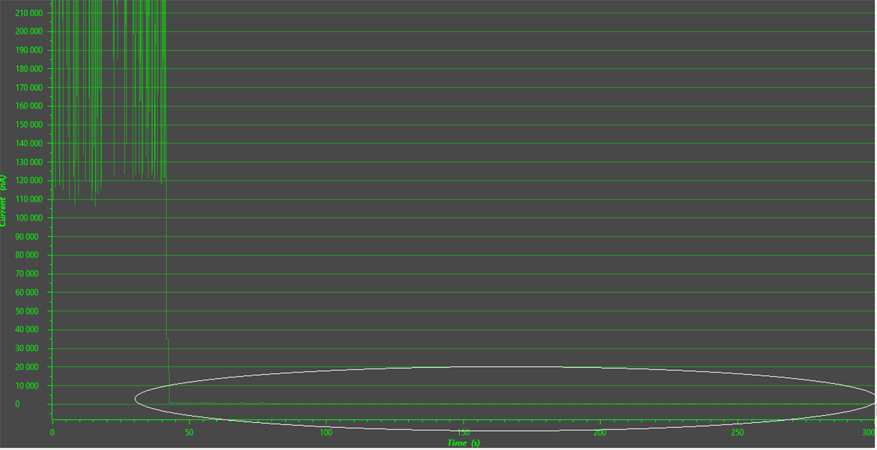

    Fig 3. CC2640 Shutdown 300sec
  • Are you only using out of box example? What's the connection parameters for CC2540 and CC2640 devices?
    Are those examples you are using identical application wise?

  • I think it's because of:
    #define DEFAULT_ENABLE_UPDATE_REQUEST GAPROLE_LINK_PARAM_UPDATE_WAIT_BOTH_PARAMS
    Try to use
    GAPROLE_LINK_PARAM_UPDATE_INITIATE_BOTH_PARAMS
    and capture an BLE air sniffer trace (not HCI dump) to confirm which link params are in use.
    Best wishes
    thanks for the answer
    // Whether to enable automatic parameter update request when a connection is formed.
    #define DEFAULT_ENABLE_UPDATE_REQUEST         GAPROLE_LINK_PARAM_UPDATE_INITIATE_BOTH_PARAMS //GAPROLE_LINK_PARAM_UPDATE_WAIT_BOTH_PARAMS
    nothing changed
    Now i can't capture an BLE air sniffer trace  :-(
  • What's your master device? It's difficult to read the connection event from a oscilloscope diagram.
    Can you try using simple_peripheral on CC2640 out of box example and measure the average power consumption.
    Please set connection interval to be 1 second and do not enable periodic event. We have done the measurement on that setting and the average current should be 10uA.
    You can follow the application report found here : www.ti.com/.../swra478c
    to set up the SW for comparison.
