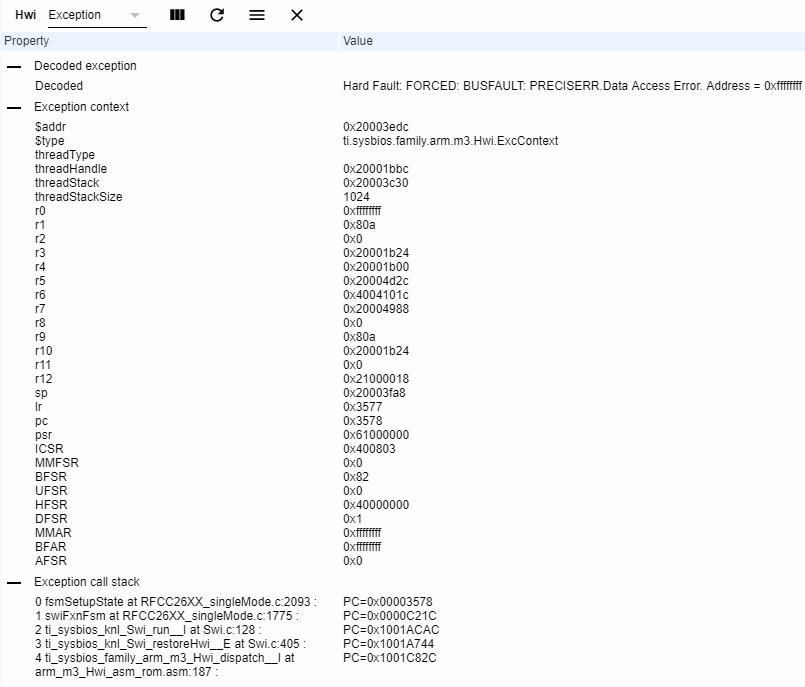

What worries me more is that I sometimes get an exception in my application which seems to happen inside the RFCC26XX_singleMode function. I have attached the exception call stack:

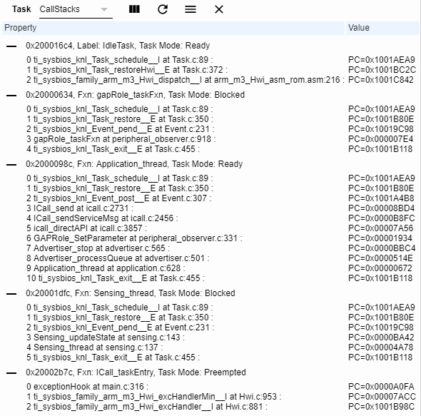

It seems to be a timing issue in the RF driver, as my stack and heap aren't broken, I have HEAP_METRICS enabled and have included the task callstack:
The only thing that stands out is that my application has just called GAP_endDiscoverable(), but I am not sure if this triggers the exception as I do a lot of end_discoverable in my application. Is there any clue as to why this is happening? Is the stack unable to cope with a lot of GAP_ calls while scanning at the same time?

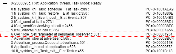

    Thank you for your answer. It is not obvious from the call stack I have included but GAP_endDiscoverable() is called from a task context here:
    My main thread is Application_thread, which calls Advertiser_stop which calls GAPRole_SetParameter in the peripheral_observer profile. I have not modified peripheral_observer. The peripheral_observer profile then calls GAP_endDiscoverable. Advertiser_stop has the following lines of code:
    uint8_t advertDisable = FALSE;
    /* Disable All Advertisements */
    GAPRole_SetParameter(GAPROLE_ADVERT_ENABLED, sizeof(uint8_t), &advertDisable);
    GAPRole_SetParameter(GAPROLE_ADV_NONCONN_ENABLED, sizeof(uint8_t), &advertDisable);
    Thanks for any clear-up.
    Mattia

    I am still encountering this issue. I am seeing this issue when switching from connected advertisements to unconnected advertisements and back in my application. It happens when calling GAP_EndDiscoverable in the application.
    I am quite certain it's a bug in the RF driver in SDK 1.50.00.58. Please take a look at line 2092 in CC26XX_singlemode.c where a possible null pointer is being dereferenced. The exception occuring in my first post demonstrates this issue (pOpFirstPend's address value is 0xffffffff).
    I am using a custom patched version of the driver which fixes this problem (attached below), but I expect an official patch coming from TI. Could you provide me with a date on when to expect this patch? We are already using this feature in our product based on the CC2650 and intend to keep using this feature with the new SDK. Thank you for your answer.
    Mattia
