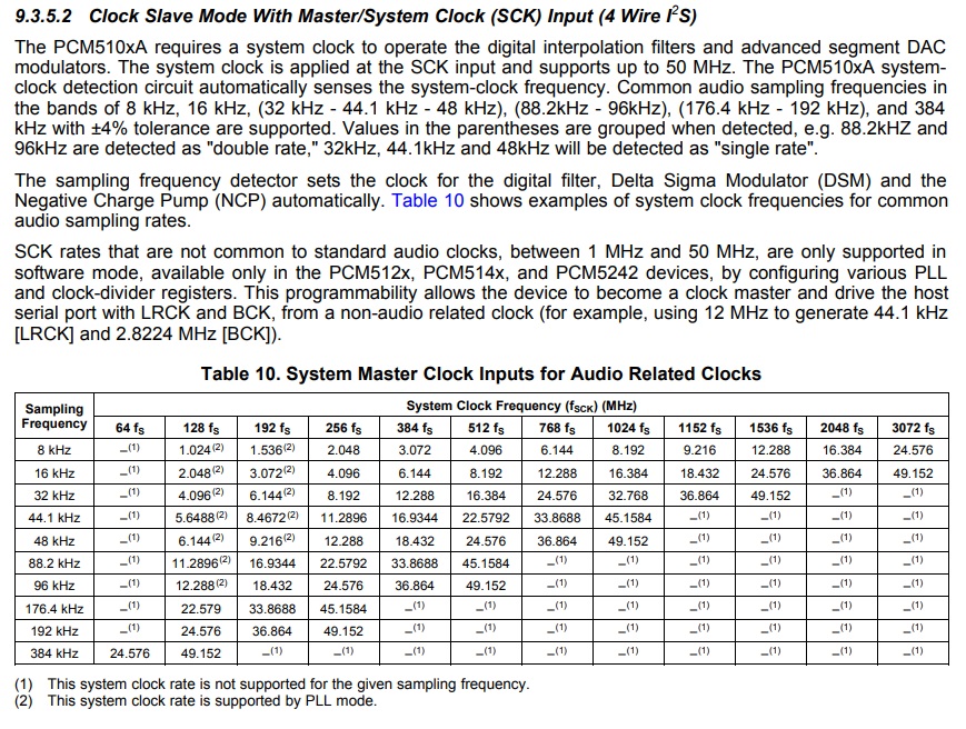

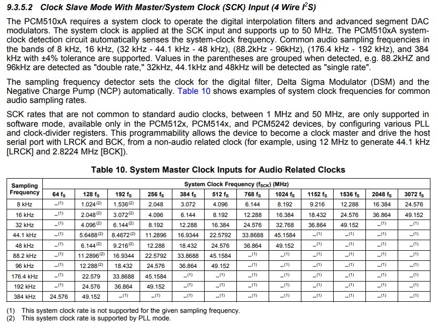

    Understood that the clock signal must be identical. How about the tolerance of sampling frequency? I am reading this thread and noticed that the sampling frequencies of PCM5100 DAC can support +/-4% tolerance, is it the same in CC2564?
    Thanks and best regards,
    Kevin
  • Hi Kevin,
    I have interpreted this spec. to be set by the Bluetooth spec. which if I remember correctly is +- 30ppm. This is very tight and matches the carrier spec. for Bluetooth. I would guess the CC2564 probably doesn't need to spec the tolerance because of the Bluetooth requirement .
