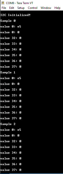

i am interfacing the gy80 accelerometer (ADXL345) with cc2640r2F . my problem is that i m not getting right output values
plz check my program and resolve my problem

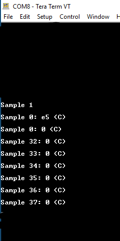

  • yes there is a problem in printout. the correct image is

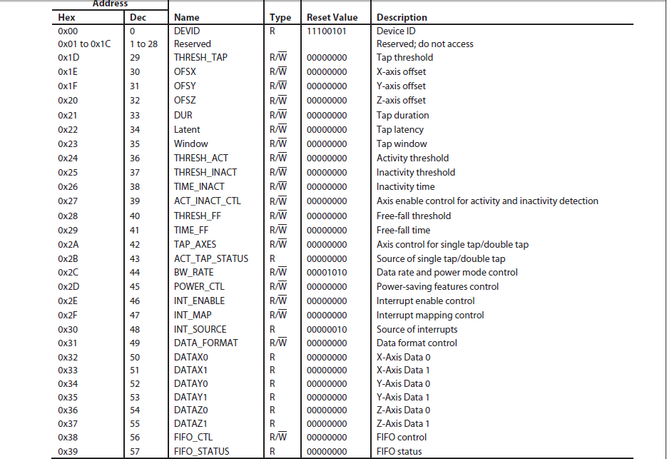

    if i using the 2 and 8 in my  code ,i get the correct reset values . e5 shows the reset address of DEVID (device address) and 0 denote reset values of other registers .
    if i used your code i get only device address reset values (e5) and not getting right registers reset values .

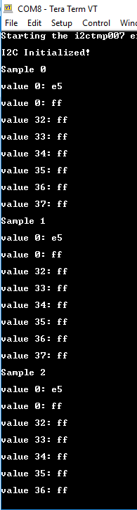

    your output is
    my problem is that,  i want the final output (x,y,z) and i forget  something in my code.
    can u plz give the final output code .
  • i am not getting the desired output . can u plz check the register address and tell me what i miss in my codes and give final output coding of my problem
    Can you please show me your modified code, the printout of the modified code does not match what I recommended.

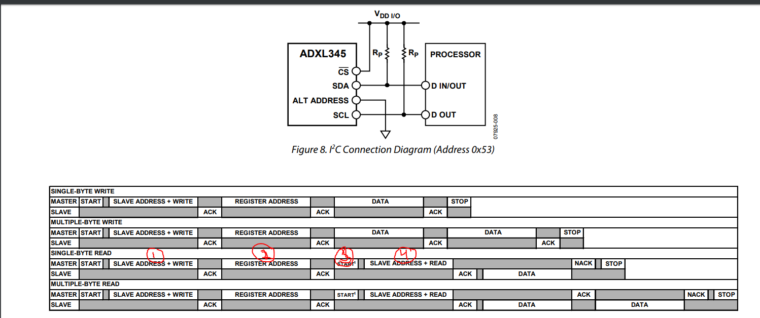

    According to the datasheet of the accelerometer you are using, you need to:
    1. start a write transaction (I2C address + 0)
    2. send the register you wish to read (txBuffer[i])
    3. stop transaction
    4. start a new read transaction (I2C address + 1)
    The code would look like this:

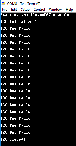

  • BY Using above code i am not getting any output. and where i used the i2c address(0x53) to interface the board.
    if i used the " slave address + write " which can be equal to (0x53+0xA6=F9) and slave adress + read equal to (0x53+0xA7=FA) . again result is same i.e " i2c bus fault".
    in Previous reply i understand how to read and the write the data with addition of slave address  but practically it is not working.
    The output of the previous reply  of that code is
    You do not need to add the write + address to the address. according to the datasheet, the address is a 7bit value and you just add that last bit depending whether you want to read or write.
    For WRITE:
    ((0x53 << 1) + 0x00) = 0xA6
    For READ:
    ((0x53 << 1) + 0x01) = 0xA7
    That is the reason behind the slave address being 0xA7 or 0xA6. If you have a digital analyzer that you could use to sniff the lines and see the output of the device, it would be helpful.

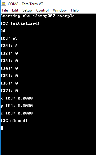

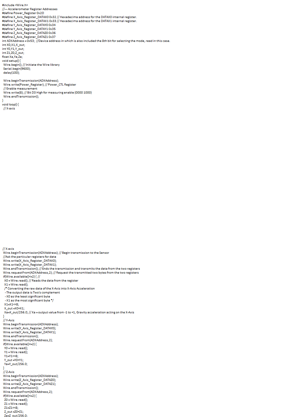

  • my final coding is give below. i m unable to read the data from the register, plz check my coding.
    my steps to make the program is :
    1 . connect the I2C using slave address(i2c address 0x53)
    2. define the following registers
    3. enable the power controlled register (0x2D) by write the value 0x08(0000 1000 i.e for measurement enable)
    4. read the data from axes register
    5. calculation
    6. output

    #define DATAX0 0x32 /*X-Axis Data 0 */
    #define DATAX1 0x33 /*X-Axis Data 1 */
    #define DATAY0 0x34 /*Y-Axis Data 0 */
    #define DATAY1 0x35 /*Y-Axis Data 1 */
    #define DATAZ0 0x36 /*Z-Axis Data 0 */
    #define DATAZ1 0x37 /*Z-Axis Data 1 */
    #define DEVID 0x00 /* Device address */

    Display_printf(display, 0, 0, "%x\n",PCR);
           i2cTransaction.slaveAddress = 0x53; /* (0x53 + 0) i2c address*/
           i2cTransaction.writeBuf = txBuffer;
           i2cTransaction.writeCount = 4;
           i2cTransaction.readBuf = rxBuffer;
           i2cTransaction.readCount = 10;
           if (I2C_transfer(i2c, &i2cTransaction))
               //while(2)
                   txBuffer[0] = DEVID;
                   txBuffer[1] = PCR;
                   rxBuffer[1]=0x08;
                   txBuffer[2] = DATAX0;
                   txBuffer[3] = DATAX1;
                   txBuffer[4] = DATAY0;
                   txBuffer[5] = DATAY1;
                   txBuffer[6] = DATAZ0;
                   txBuffer[7] = DATAZ1;
    Display_printf(display, 0, 0, "[%x]: %x \n", txBuffer[0],rxBuffer[0]);
    Display_printf(display, 0, 0, "[%x]: %x \n", txBuffer[1],rxBuffer[1]);
    Display_printf(display, 0, 0, "[%x]: %x \n", txBuffer[2],rxBuffer[2]);
    Display_printf(display, 0, 0, "[%x]: %x \n", txBuffer[3],rxBuffer[3]);
    Display_printf(display, 0, 0, "[%x]: %x \n", txBuffer[4],rxBuffer[4]);
    Display_printf(display, 0, 0, "[%x]: %x \n", txBuffer[5],rxBuffer[5]);
    Display_printf(display, 0, 0, "[%x]: %x \n", txBuffer[6],rxBuffer[6]);
    Display_printf(display, 0, 0, "[%x]: %x \n", txBuffer[7],rxBuffer[7]);
               x=rxBuffer[2]+rxBuffer[3];
               x_out=x/256;
               y=rxBuffer[4]+rxBuffer[5];
               y_out=y/256;
               z=rxBuffer[6]+rxBuffer[7];
               z_out=z/256;
               Display_printf(display, 0, 0, "x [%d]: %f \n", x, x_out);
               Display_printf(display, 0, 0, "y [%d]: %f \n", y, y_out);
               Display_printf(display, 0, 0, "z [%d]: %f \n", z, z_out);
           else
               Display_printf(display, 0, 0, "I2C Bus fault\n");
           /* Sleep for 1 second */
           sleep(1);
       /* Deinitialized I2C */
       I2C_close(i2c);
       Display_printf(display, 0, 0, "I2C closed!\n");
       return (NULL);
    output display
    please check my program and give the solution
  • this is my arduino coding which is working on same sensor
    Try and read through the following code. I go through each line and explain what I am doing.

    //populate the txBuffer before doing the I2C_transaction
    txBuffer[0] = PCR;
    //set bit 4 and 3 [0000 11000] for measurement mode enable and auto_sleep enable
    txBuffer[1] = 0x0D;
    i2cTransaction.slaveAddress = (0x53);
    //two byes are going to be sent when doing a single byte write (Register + Value)
    i2cTransaction.writeCount = 2;
    //No reply from the slave when doing a write, no need for a buffer
    i2cTransaction.readBuf = NULL;
    i2cTransaction.readCount = 0;
    //Lets wait a second to let the device reset and start calculations after writing to the power control register
    sleep(1);
    txBuffer[1] = DEVID;
    //To keep it simple let's do single byte read operations
    for(i=0;i<8;i++){
    //1 byte is going to be sent when doing a single byte read (Register)
    i2cTransaction.writeBuf = txBuffer[i];
    i2cTransaction.writeCount = 1;
    i2cTransaction.readBuf = txBuffer[i];
    i2cTransaction.readCount = 1;
    Display_printf(display, 0, 0, "[%x]: %x \n", txBuffer[i],rxBuffer[i]);
    else

    AB
  • hello,
    The above Coding is working by correcting some  small things . This is my First I2C Task.
    Thanks for help .
