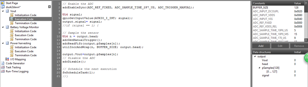

I built the project in sensor controller studio and it passed the testing.
Then, I followed the example  Sensor Controller- integrate with TI-RTOS application in simpleLink Academy1.11  with cc2650 lanuchpad project zero to build the bluetooth data transfer.
However, it seems not work,but without errors or warning.
How can I change so as to perform task at BLE?

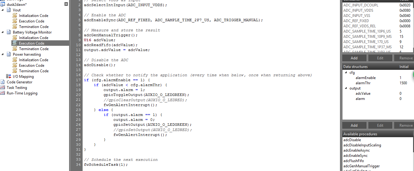

Sensor controller code
Project name:dusk2dawn
CCS
The yehighline is what I changed.

  • Copy and paste the SC Driver initialization into ProjectZero_init().
  • // Initialize the Sensor Controller
        scifOsalInit();
        scifOsalRegisterCtrlReadyCallback(scCtrlReadyCallback);
        scifOsalRegisterTaskAlertCallback(scTaskAlertCallback);
        scifInit(&scifDriverSetup);
        // Set the Sensor Controller task tick interval to 1 second
        uint32_t rtc_Hz = 1;  // 1Hz RTC
        scifStartRtcTicksNow(0x00010000 / rtc_Hz);
    //Change here
        // Configure Sensor Controller tasks
        scifTaskData.battery.cfg.alarmThr = 1500;
    scifTaskData.power.cfg.th1 = 50000;
        // Start Sensor Controller task
        scifStartTasksNbl(BV(SCIF_VOUT_TASK_ID));
      scifStartTasksNbl(BV(SCIF_BATTERY_TASK_ID));
      scifStartTasksNbl(BV(SCIF_POWER_TASK_ID));

static void processTaskAlert(void)
  // Clear the ALERT interrupt source
  scifClearAlertIntSource();
  // Get 'state.dawn', and set dawnStr to appropriate string
  //uint16_t dawn = scifTaskData.dusk2dawn.state.dawn;
  //char *dawnStr = (dawn != 0) ? "dawn" : "dusk";
  // Set the dawnStr to the String characteristic in Data Service
  //DataService_SetParameter(DS_STRING_ID, strlen(dawnStr), dawnStr);
  // Set red LED value
  //PIN_setOutputValue(ledPinHandle, Board_LED0, dawn);
  // Acknowledge the ALERT event
  scifAckAlertEvents();
} // processTaskAlert
