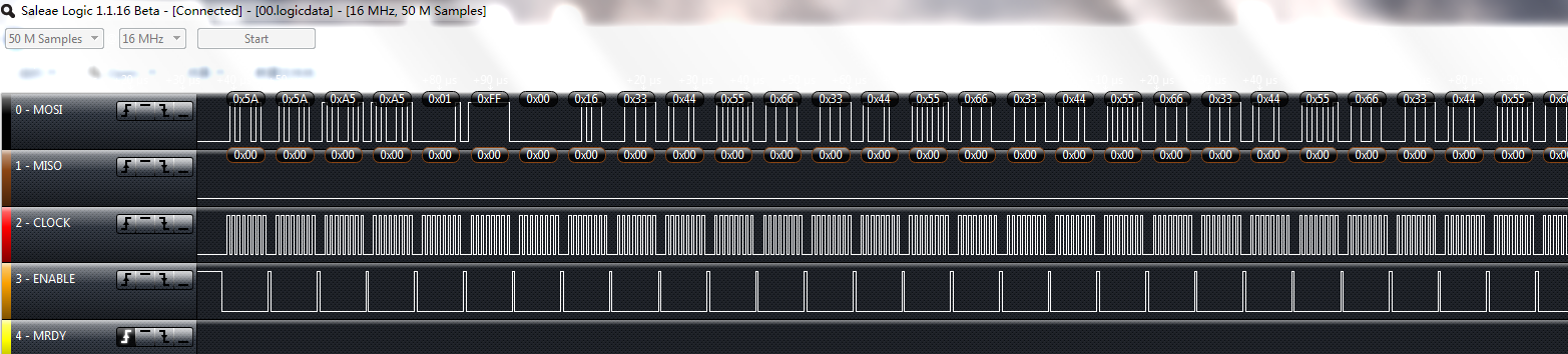

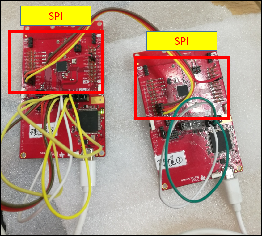

3.Using the configuration above , 32 bytes of data were written during the state of SPI CSN keeping at the low level ,as shown in picture 1.
picture 1

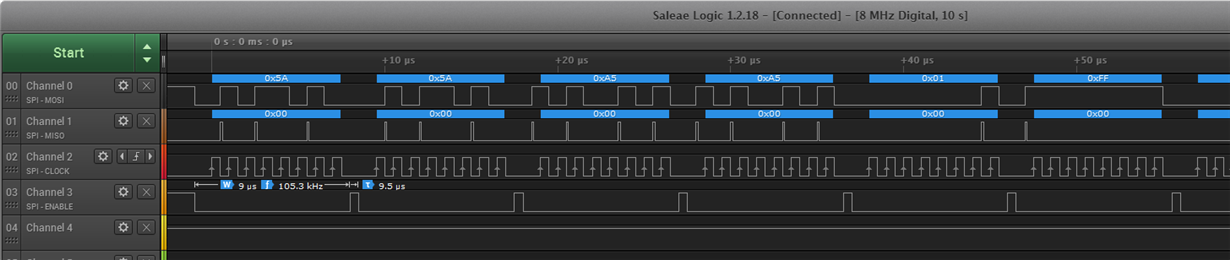

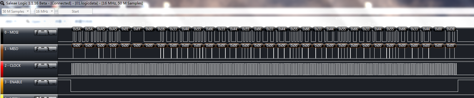

4.Connecting SPI MASTER and SPI SLAVE, as shown in picture 2 and picture 3.
picture 3
5.SPI SLAVE can read only the first byte----0X5A

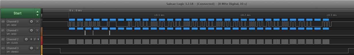

6.If SPI MASTER using the default SPI CSN configuration , SPI SLAVE can read all the datas that SPI MASTER writes .SPI MASTER writes 32 bytes of data during the state of SPI CSN keeping at the low level , as shown in picture 4.
picture 4
Where am I wrong when configuring the SPI CSN ?

  • According to this found in the SPI driver:
    static const uint32_t frameFormat[] = {
        SSI_FRF_MOTO_MODE_0,    /* SPI_POLO_PHA0 */
        SSI_FRF_MOTO_MODE_1,    /* SPI_POLO_PHA1 */
        SSI_FRF_MOTO_MODE_2,    /* SPI_POL1_PHA0 */
        SSI_FRF_MOTO_MODE_3,    /* SPI_POL1_PHA1 */
        SSI_FRF_TI,             /* SPI_TI */
        SSI_FRF_NMW             /* SPI_MW */
    you are using Motorola mode 0.
    According to "20.4.4.3 Motorola SPI Frame Format With SPO = 0 and SPH = 0" in the TRM:
    "For continuous back-to-back transmissions, the SSIn_FSS signal must pulse high between each data word transfer because the slave-select pin freezes the data in its serial peripheral register and does not allow altering of the data if the SPH bit is clear. The master device must raise the SSIn_FSS pin of the slave device between each data transfer to enable the serial peripheral data write. When the continuous transfer completes, the SSIn_FSS pin is returned to its IDLE state one SSIn_CLK period after the last bit is captured."
  • When using SPI_POLO_PHA0  mode , the SPI CSN signal must pulse high between each data word transfer, as shown in picture 1.
    When using SPI_POLO_PHA1  mode ,the SPI CSN pin is held low between successive data words and terminates like a single-word transfer, as shown in picture 2.
    When using SPI_POL1_PHA0  mode , the SPI CSN signal must pulse high between each data word transfer, as shown in picture 3.
    When using SPI_POL1_PHA1  mode ,the SPI CSN pin is held low between successive data words and terminates like a single-word transfer, as shown in picture 4.
