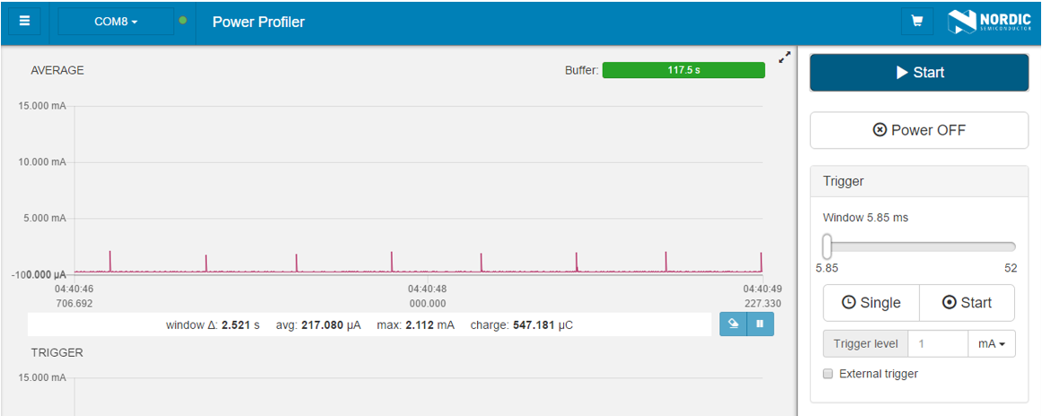

I'm having a problem with the power consumption when using launch pad cc2640r2f chip.

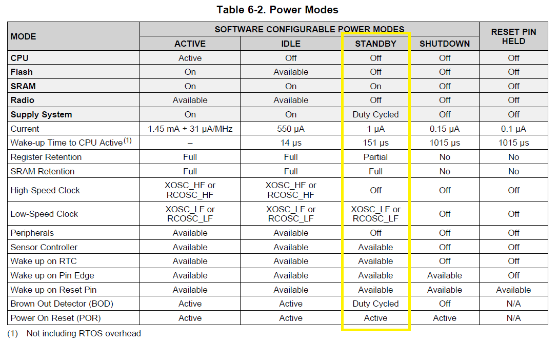

When running the “micro-eddystone-beacon” of CC2640R2 Texas Instrument example, I expect to have a 1uA base consumption.

When monitoring the consumed power with the PPK (power profiler kit PCA63511 of Nordic) we have a base consumption of 220uA (it’s the best we got after tuning the example).

From these we have tried the following test
Test 1: Adding these lines to the program, disconnecting all the GPIO + Debugger, commenting out all tasks
/*--------initialization power policy---------*/
Board_initGeneral();
Power_enablePolicy();
Power_setPolicy(PowerCC26XX_standbyPolicy);
/*--------fin initialization power policy-----*/
//force mode standby
Power_sleep(PowerCC26XX_STANDBY);
Result 1: power consumption drops from 5mA to 220 uA
What can I do to have a 1uA base power consumption with the cc2640R2F ?
