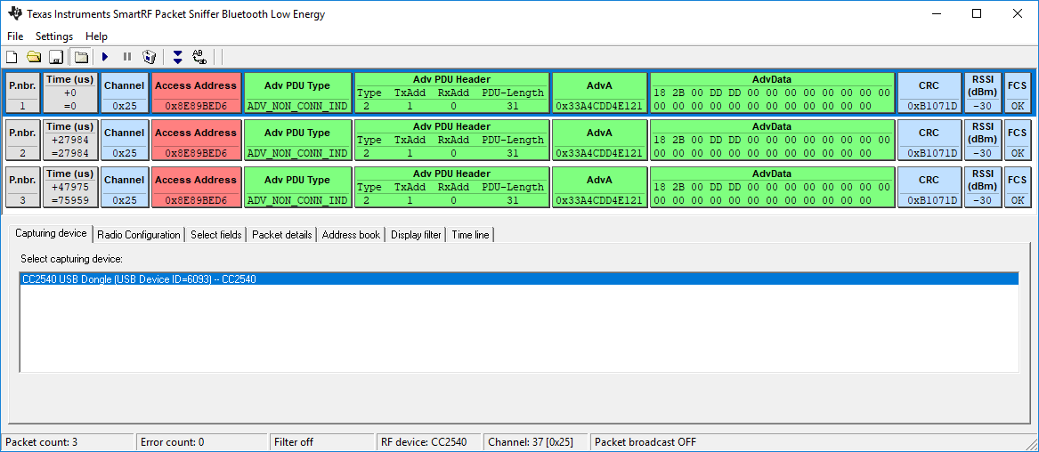

In my multi-role BLE application I need non-connectable and non-scannable undirected advertising with (PDU Type=2)/(TxAdd=1)/(RxAdd=0) fields in PDU header:
Bluetooth Advertisement PDU format

However, I did not see TxAdd=1 in the air :
What is wrong in my approach ?

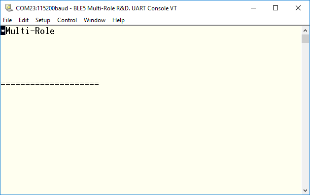

    I tried to change addremode in the GAP_DeviceInit () to ADDRMODE_RANDOM by following the step below in my multi-role.c file:
    // Address mode of the local device
    #define DEFAULT_ADDRESS_MODE                  ADDRMODE_RANDOM
    However, this change crashes the application and I see the following screen in my terminal:

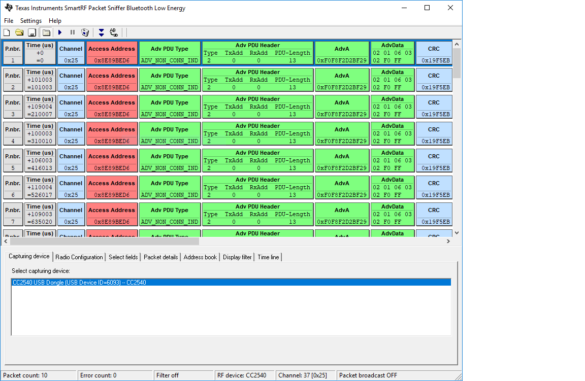

    In fact, I need non-connectable and non-scannable undirected advertising with (PDU Type=2)/(TxAdd=1)/(RxAdd=0) fields in PDU header.
    I need Advertising packet in the air that I have here :

  • Hi Marie,
    Suddenly, I found that in the address mode = ADDRMODE_RP_WITH_PUBLIC_ID everything is fine and I can set TxAdd = 1!
    Now I'm looking for a way to change the advertising address "on the fly".
    By the way, it seems that the cause of the crash is combined with a random generator. I did not find the code TRNGCC26XX_open () in multi-role project (neither stack no app). I guess that in the address mode = ADDRMODE_RANDOM or ADDRMODE_RP_WITH_RANDOM_ID the GAP uses TRNGCC26XX without correct initialization on my side.
