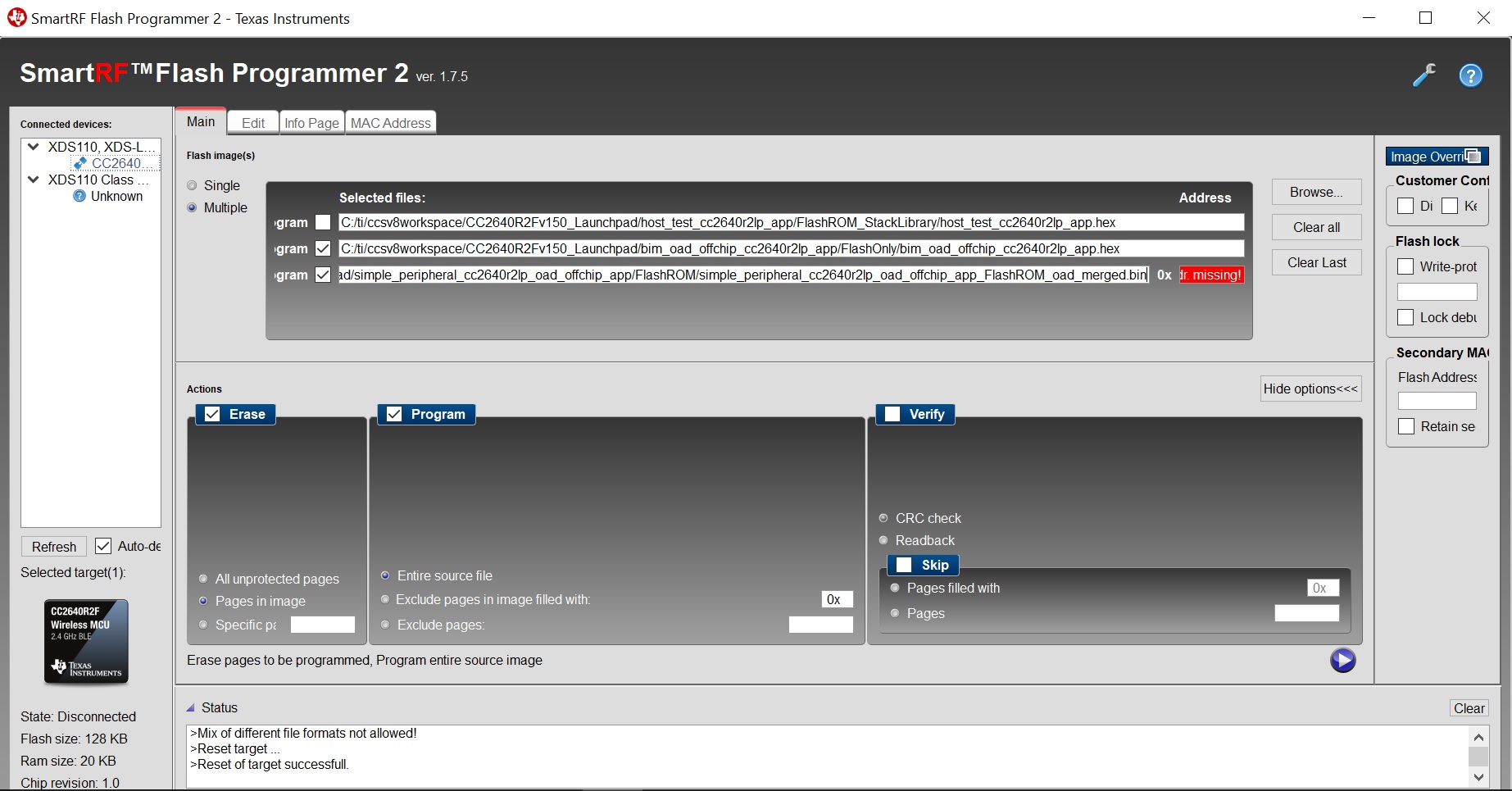

    Before I did the above change ,I traced in BIM.
    When the following code in jumptoPrgEntry executed, an error occurred:
    "A precise data access error has occurred at data address 0xc9011001.
    Exception occured at: 0x1f812 "
    // Reset the stack pointer,
    asm(" LDR SP, [R0, #0x0] ");
    I program my app first via SmartRF Flash V2, at offset=0.
    It can be executed,cause it self contain the ccfg. (the app size is 128KB) .
    Then I use the IDE(IAR ) to download the BIM, i think it will replace the flash page31.

  • Hi Markel,
    Thanks for your advice.
    In fact, the order of the my image downloading is BIM, APP_Stack_Merged.
    And another strange problem is, if I use the hex file in SmartRF flash V2, the code does not work after programmed(with or without a hradware reset or power on/off).
    I have to use bin files,and specify the address(BIM is 0x1F000,app+stack is 0), then the code can work after programmed.
    This problem not only occurs in my modified application, also in the default SDK example (simple_peripheral_oad_offchip).
    As your advice using BIM, Stack, and APP order to download, I cannot perform this cause I don't know the address of the Stack .
    I think it may not work in my situation as I mentioned above.

  • Hi Markel,
    I do exactly what you did.
    But it only works when it is bin files.
  • I think there was an error occur when converting from bin to hex.
    But the IDE(IAR 8.22.2) did not show any error message when doing building.
  • Hi Kaifen,
    I am using CCS so the procedure is different from IAR. Can you follow the instructions at "Using IAR" "C:/ti/simplelink_cc2640r2_sdk_1_50_00_58/docs/blestack/ble_user_guide/html/oad-ble-stack-3.x/oad_offchip.html"
    From what I understand from the document procedure "Using IAR Off-Chip OAD", you need to flash in this order BIM hex file, app oad merged.bin.
    -kel
  • Hi Markel,
    The procedure guide ("Using IAR")  you mentioned was what I referred from.
    Besides, I have read the post-build action,and run the script directly in command line.
    It generate the same xxx_merged.hex (I have compared them by hash tool).
    Here is one of the command window result screen shot.
    All the input hex files are generated from output_converter.
  • Hi Markel,
    I think I have misunderstood the doc.
    It clearly says that we should use the bin format. >_-
    Not mentioned anything about the hex files. So the hex files cannot work ?May be....
    Okay, I'm going through this issue.
    Besides, after program BIM and stack one by one, I can debug the app with IDE.
    The only problem here is the power on reset issue.
    Until now,it still needs a hard reset after power on,then the software reset can perform correctly.
    Thanks for your kindly help.
  • Hi Kaifeng,
    From what I remember there is an issue with IAR hex generation utility that's why there is post build step to convert it to bin file. Anyway, maybe a TI Engineer will reply to clarify all this further.
    -kel
