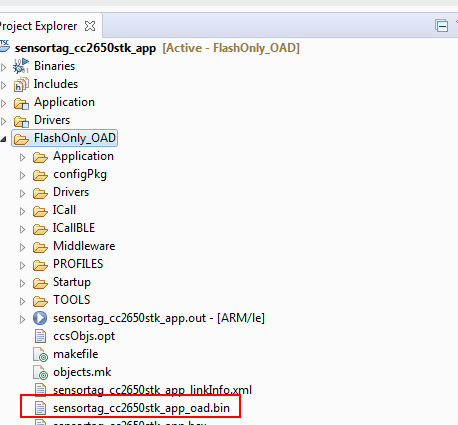

    Using the unmodified sensortag project from the SDK with CCS I was able to produce the OAD binary.
    The OAD image tool is included in the project and will generate the OAD binary automatically
    The file highlighted in the red box below is the one that should be passed into BTool as per section 5.6.2 of the OAD User's Guide.
    You should be able to follow the rest of the guide from here to perform an OAD. If you are using the mobile app, I do not have an android device available but iOS you are able to e-mail yourself the binary that you are trying to OAD and open the e-mail attachment in the TI SensorTag app.
