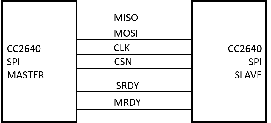

(2) add NPI_SPI into simple_peripheral project according to 《Cc2640_Adding_a_UART_or_SPI_driver_to_a_Sample_Project》.After completed , the result is shown in picture 1.

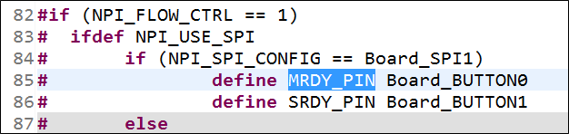

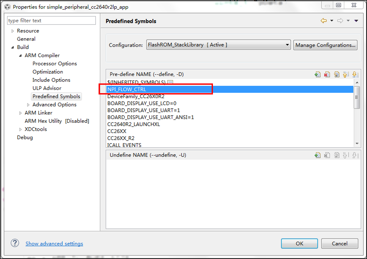

(3) according to the TI official guide 《NPI》, there has MRDY and SRDY wires . Add predefined symbols "NPI_FLOW_CTRL" in simple_peripheral project , as shown in picture 2.

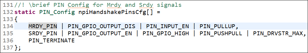

(4) In npi_tl.c , MRDY_PIN and SRDY_PIN is defined , as shown in picture 3. MRDY_PIN and SRDY_PIN is Board_BUTTON0 and Board_BUTTON1 respectively , as shown in picture 4 .

    As far as I know there is no NPI SPI Master implementation on the TL layer as there is for UART. Is there any special reason why you want to use NPI SPI to setup communication between two CC2640R2F?
    NPI is quite big and not super easy to use, if you simply need to some sort of simple communication between the two platforms you are probably better of using the original SPI driver and putting together a simple packet format.
