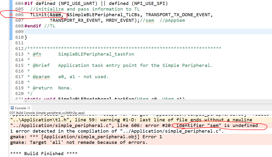

Adding NPI_SPI into simple_peripheral project , but compiling failed .
My detail steps is shown as followed:
1.On CC2640 LAUNCHPAD , add NPI_SPI into simple_peripheral project according to 《Cc2640_Adding_a_UART_or_SPI_driver_to_a_Sample_Project》.
2. download the “tl.h” and “tl.c ” file . The path is shown in attachments 6(6) and 6(7).
3. add NPI_SPI into simple_peripheral project according to 《Cc2640_Adding_a_UART_or_SPI_driver_to_a_Sample_Project》.
4.compile the simple_peripheral project , but it failed , as shown in picture 1 .
5. the reason why compiling failed is that "sem" is not defined in this project .The code is shown as followed:
#if defined (NPI_USE_UART) || defined (NPI_USE_SPI)
  //initialize and pass information to TL
  TLinit(&sem, &SimpleBLEPeripheral_TLCBs, TRANSPORT_TX_DONE_EVENT,
         TRANSPORT_RX_EVENT, MRDY_EVENT);
#endif //TL

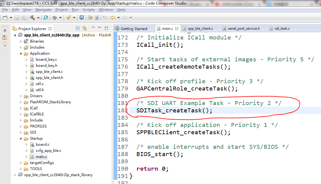

    After downloading and compiling the spp_ble_client project from Github , it shows build success . However , the  spp_ble_client project  is based on UART , instead fo SPI , as shown in picture 1 .Where can  spp_ble_client project based on SPI be downloaded ?

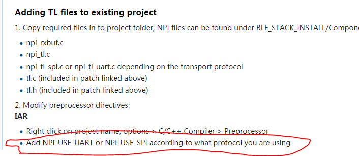

    NPI/SDI still contains SPI support. You would have to tweak the application a bit to enable it to use the underlying SPI transport. For example, you would have to define NPI_USE_SPI in preprocessor settings.
    Best wishes
  • I have already add the predefined symbols "NPI_USE_SPI" according to the second step of 《Cc2640 Adding a UART or SPI driver to a Sample Project》 ,  as shown in picture 1 .
    Can you find out other possible reasons why the compiling failed ?

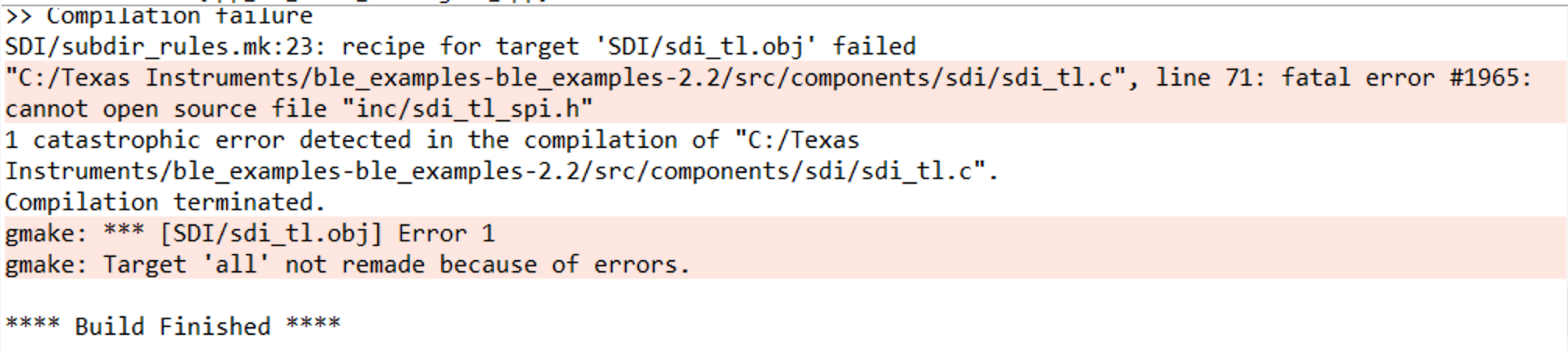

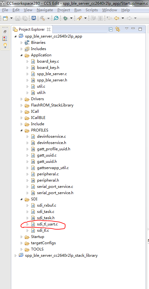

  • In the SDI folder of SPP project , only "sdi_tl_uart.c " can be found . "sdi_tl_spi.c" can never be found in the SDK,  as shown in picture 1.
    Where can the  "sdi_tl_spi.c"  of SPP be downloaded ?
    You have to add the files to the project from here:
    C:\ti\simplelink_cc2640r2_sdk_1_40_00_45\source\ti\blestack\npi\src
    Best wishes
  • I am having the same issues with my CC2640 (non R2) project. I have found npi_tl_spi.h and npi_tl_spi.c, but after searching my entire hard drive I cannot fin the missing file that is throwing the error shown in the image. Where can spi_tl_spi.h be found?
    You should replace all instance of sdi_tl_spi with npi_tl_spi (for ex. in sdi_tl.c) since you are using npi_tl_spi.h which should still work.
