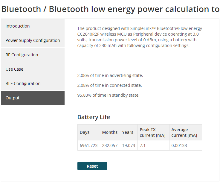

    Basically, I am looking at a replacement for an implantable device that currently uses NFC.   I would like the range to be about 1-2m.  The other requirement is the average current draw for at least 10years needs to be about 2uA.  The device will primarily be in sleep state and will wake up occasionally to take data.  So what I am currently doing is trying to work backwards to see if a) this is possible and if so b) what my connection interval can be.  (This is in an early stage and I am not necessarily married to this device or ever BLE so any suggestion's as to other devices would be appreciated.  But, with those I would have similar questions).
    In very very over simplified terms and ignoring a lot of other factors.
    In sleep mode the device draws 100nA.  Assuming we have a 270mAh battery that's  8.76mAh over the 10years leaving 261mAh.  The CC2640 uses approximately 6ma in 0dBm transmit and in receive mode so at 6mA that leaves about 43.5 hours of operation or about .0118 hrs/day for transmit/receive operations.

  • To answer your questions first:
    1. Yes, you can lower the TX output power to get lower current consumption. However, we do not have current number for TX output power other than 5dBm and 0dBm.
    2. No, there is no method to lower RX current.
    I would first recommend you to take a look at our Measuring Bluetooth Low Energy Power Consumption application report to get a better overview of BLE technology current profile.
    The average current consumption for 1s connection interval is 10uA, if you incorporate the slave latency with even longer connection interval, then achieving 2uA current consumption with device stays in connected is definitely no problem.
    We have a online tool called BLE power calculator for you to checkout your use case and we will also have a excel sheet version of BLE current calculator available for public soon.
    I did a quick check out if device only sends out 1 byte of data in connection and broadcast 1 byte of data (both activities stay on 30 mins per day), then this is the current consumption is gonna be like:

  • Please try this link.
    www.ti.com/.../power-calculator.page
    The lowest TX output power can be set to -21dBm.
