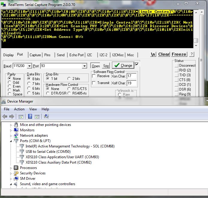

    I think I have terminal settings correct because I am getting data from the Simple_Central application, see screen shot below.
    But, the data has a lot of extra characters which I am guessing are control commands for an LCD display.  The app is responding
    to the Keys on the sides of the lauchXl board, but the displayed characters on the PC Terminal are not usable.  I thought maybe
    there is a #define to have the project run based on a PC Terminal and not an LCD display?

  • Hi Dan,
    There is a #define to run the program with an LCD. The projects do not use that by default. You can check the display settings used in the predefined symbols in the app project settings. When you switch to using an LCD, you will want to change the define.
    Does your terminal program use any encoding? Can you try again with a different program? I use PuTTY and my terminal output always looks fine out of box.
  • Hi Dan,
    While you are checking your predefined symbols, you may try disabling this setting to see if you have better results: BOARD_DISPLAY_USE_UART_ANSI=1
  • Hi Dan,
    You may also be able to get the correct output by changing your terminal display settings: realterm.sourceforge.io/
    Maybe switching to ANSI without disabling the BOARD_DISPLAY_USE_UART_ANSI=1 symbol will display the output correctly.
  • Rachel,
    I tried PuTTY and that worked! Thanks so much. Also, changing the Display on RelaTerm to ANSI also worked.
