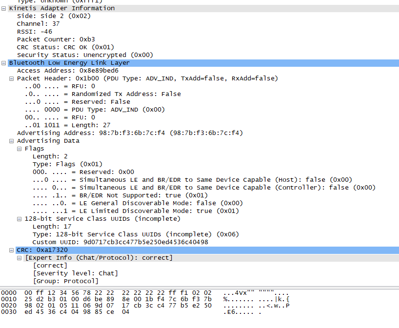

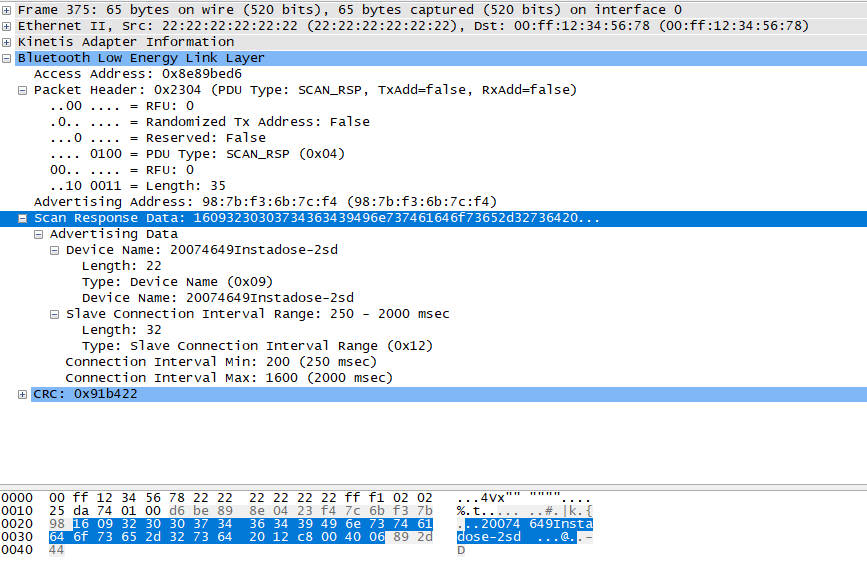

After android OS update(7.x.x Nougat to 8.x.x Oreo), android pixel phone cannot find the CC2540 devices.
Android versions 7.x devices can find it.
Used sniffer to look into the data packets and it looks well formed. Do not see any malformed data.
Below is the advertisement frame captured in sniffer. Please help.
