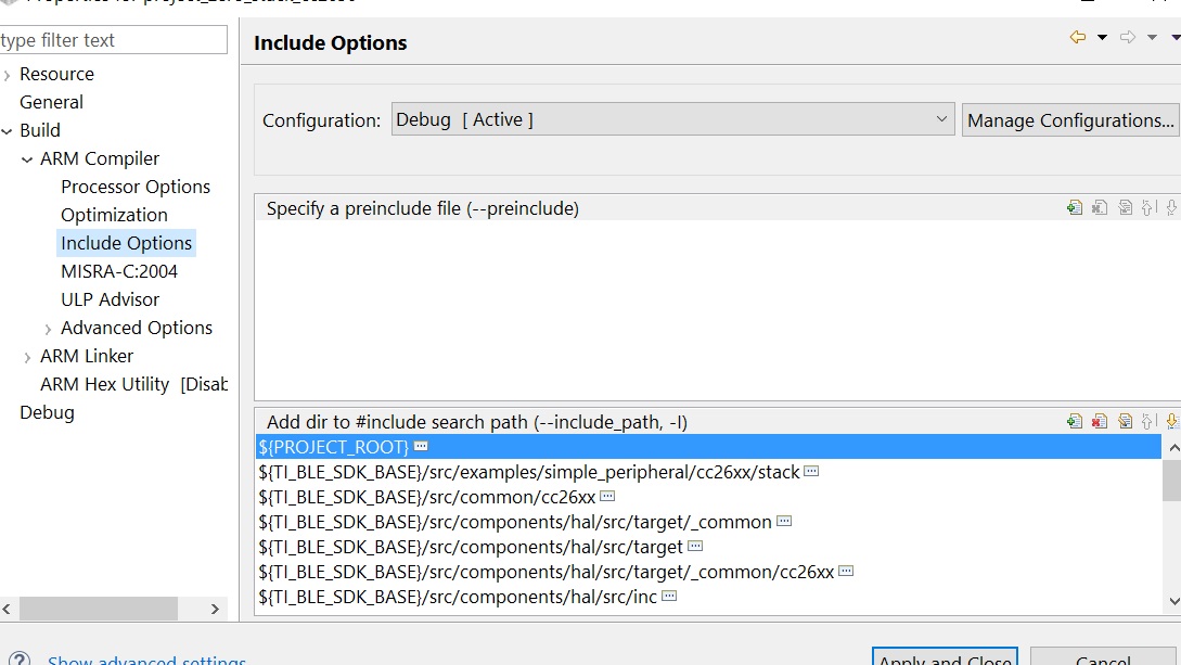

  • Hello Azim,
    Those missing header files should be under the c:\ti\tirtos_cc13xx_cc26xx_2_**\products\cc26xxware_2_xx\inc
    Please include that folder in your "include options" under Properties->Build->ARM compiler->include Options
    Prashanth

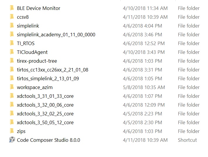

  • Hi AM,
    I noticed you said you were "trying to play with Project Zero". Did you make any modifications to Project Zero before getting this build error?
    Did you follow the instructions in the SimpleLink Academy lab to get started? software-dl.ti.com/.../ble_01_basic.html
  • Hi Rachel,
    No(laughs). I wasnt pretty sure what packages  to install. I have the following in my TI  folder.
    Previously I had some ARM compiler issues. I could not sort that.
    I was using an Arduino in between at the same COM port. I resumed working on CCS only to be welcomed by this. Even the error window is missing in the console.

  • Hi Prashanth,
    I tried. It's stilll the same. I add it in the bottom window..right? Please the screenshot below(next reply).
    best,
    Azim
  • Here's a screenshot of the Include..options..what am I expected to do?
    AM
  • Hello AM,
    One crude way is to add the folder into the include options by clicking the green "+" sign and adding this folder in the above screen shot you provided "C:\ti\tirtos_cc13xx_cc26xx_2_21_01_08\products\cc26xxware_2_24_03_17272\inc\"
    Typiclaly, when you import a project into the workspace, it should also import a dependent TIRTOS project named some thing like tirtos_builds_CC26X2R1_LAUNCHXL_release_ccs into the workspace. Then it should build with no issues.
    Prashanth
  • Hello Prashanth,
    I did try both- adding the file paths individually and adding folders.. it's still giving me errors. I downloaded the files from Resource Explorer.
    Azim
  • Can you try removing the "\inc" in that path? Just give it as "C:\ti\tirtos_cc13xx_cc26xx_2_21_01_08\products\cc26xxware_2_24_03_17272\"
  • I did..still the same. Do you think it has something to do with the drivers?
