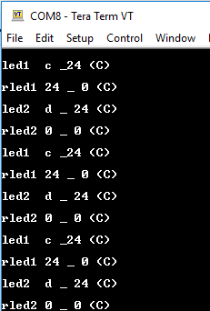

and the display output is

    if (I2C_transfer(i2c, &i2cTransaction)) {
    Display_printf(display, 0, 0, "led1 %x _%x (C)\n", txBuffer[0],txBuffer[1]);
    Display_printf(display, 0, 0, "rled1 %x _ %x (C)\n", rxBuffer[0],rxBuffer[1]);
    /* LED 2 enable */
    txBuffer[0] =REG_LED2_PA ; /* 0x0d*/
    txBuffer[1] =0x24 ; /* write 0x24 into led 2*/
    i2cTransaction.slaveAddress = 0x57;
    i2cTransaction.writeBuf = txBuffer;
    i2cTransaction.writeCount = 2;
    i2cTransaction.readBuf = rxBuffer; /* read led 2 data */
    i2cTransaction.readCount =2;
    Display_printf(display, 0, 0, "led2 %x _ %x (C)\n", txBuffer[0],txBuffer[1]);
    Display_printf(display, 0, 0, "rled2 %x _ %x (C)\n", rxBuffer[0],rxBuffer[1]);

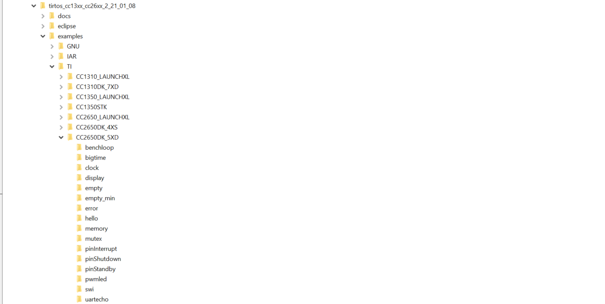

    For your first question, any IO can be used for pin interrupt. We have pin interrupt examples for all our CC26xx/CC13xx devices and package.
    For other questions related to sensor, I would recommend you to post on the product forum or to contact the support for the sensor module.
  • Merging the thread since it's the same question.
    For the pin interrupt, please see the examples we have provided in our software package.
    For the I2C problem, can you provide logic analyzer trace so we can know if there is actual data flowing between the 2 devices.

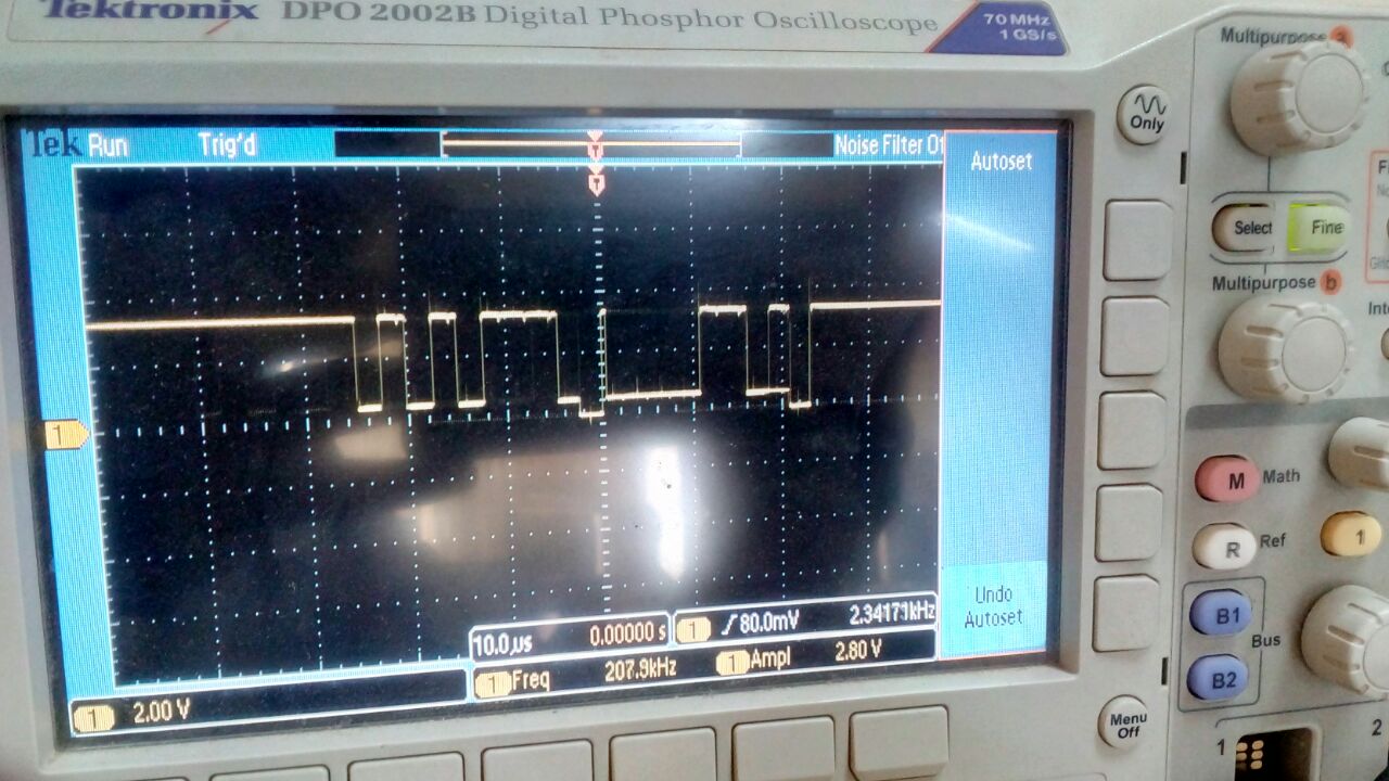

    First can you post the schematic of the design you are using and also the connection you made from CC2640R2F to the other board?
    The signal you captured using oscilloscope does not look right to me, can you take a picture of the setup and post it here.
    If you CC2640R2F is already sending the correct signal and there is no response, then you need to contact whoever made the sensors to get the support.

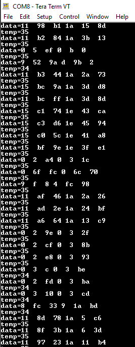

  • hello ,
    1. I am able to read the device temperature.
    2. I am able to read the FIFO DATA REGISTERS (0x07)  and the data of the register is changes when some obstacle come near to the device or we can say that the red and ir led is on and work as a proximity sensor .
    in my coding i used spo2 mode by putting 0x03 into the mode configuration (0x09) and my problem is that how will i differenciate the ir and red led data from reading the FIFO DATA REGISTER(0X07).
    what will be my further steps to differenciate the the ir data and red led data out of these 6 buffers data
    the my code and display data is given below and please check my code by reading max30102 datsheet.

    I  am unable to calculate the heart rate and SPO2 by using ir and red led data. i am using maxrefdes117 and interfacing with cc2640r2f board .
    give the algorithm or calculation steps to solve the  heart rate and spo2 from led datas.
    the output display is given below
    this is simply  the led data which is directly read from the register and after that what i will do
    thanks
