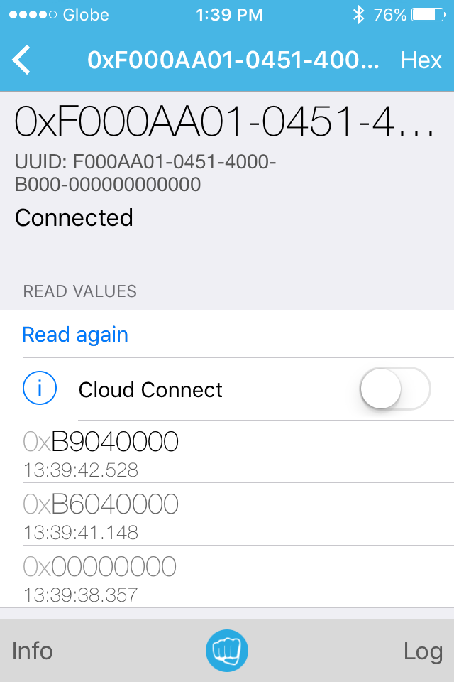

I have gone through the 'Bluetooth Low Energy Sensors BoosterPack' example and have made all of the specified changes.
The program compiles fine, and runs, but I am *not* getting any output to my BLE client nor to the UART-connected display. It seems that program execution never gets to the TMP007 task.
I have attached a screen-capture of the PuTTY output and the ROV output.
Jim
Bluetooth Low Energy Sensors BoosterPack – Only Idle Loop is running

    Again, just getting reacquainted with the CCS toolset - ('Object/IR' = Object Interrupt Request ???) If so, wouldn't that be embedded somewhere in the example ? Wouldn't I receive some sort of error if the program tried to call the routine if it didn't exist ?
    Without the full BLE functionality added I can: 1 - get temperature readings to the screen (using the 'empty' project, Tasks 1 - 2) so it is able to see the temperature sensor., 2 - see my service show up on my BLE scanner (Task 4).
    This example is from SimpleLink Academy, so my thought would be that at some point it worked. What would I need to do to get back to that point ?

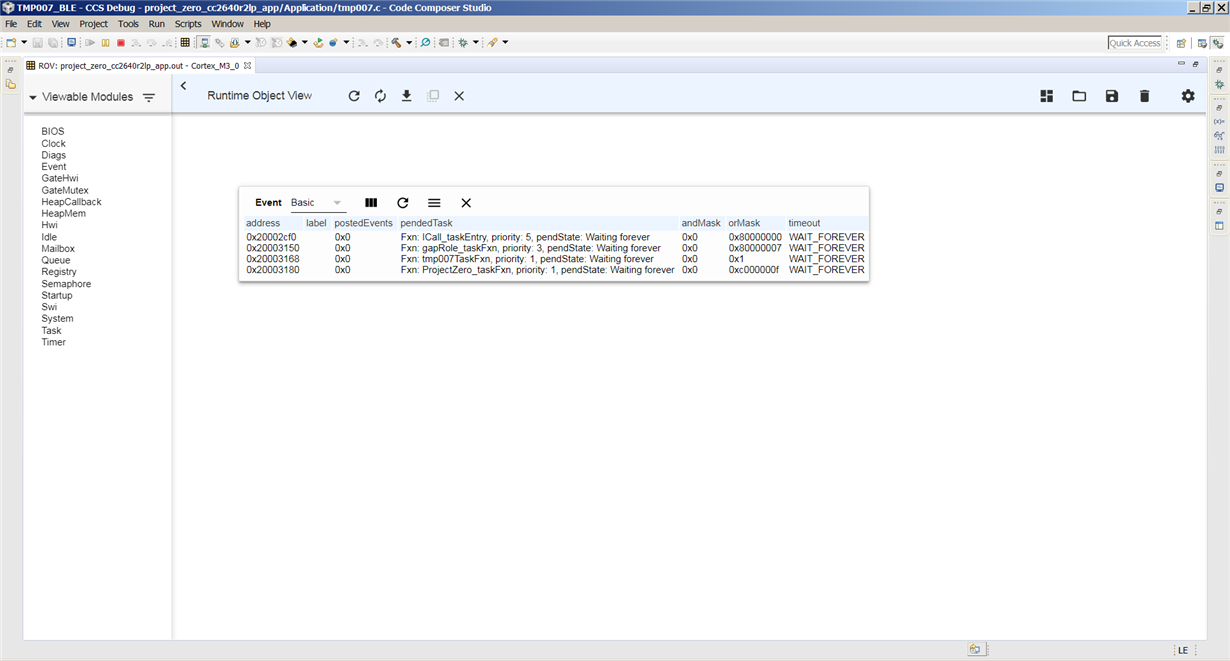

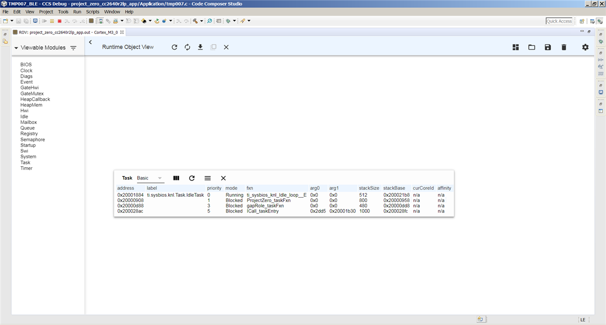

    I tried to paste in a copy of the ROV results. Every task is blocked except the 'ti.sysbios_knl_idl_Loop'. I put some 'LogInfo0's into the task. As far as I can tell the 'TMP007' task *never' starts as the only LogInfo which appears on the screen are those associated with the Project Zero code as shown in my original post. None of the TMP007 'LogInfo' information ever appears.
    Suggestions ?? I'm stuck. Actually, this isn't so much about getting this particular example going as it is about getting some sensor data transmitted via BLE.
    Jim

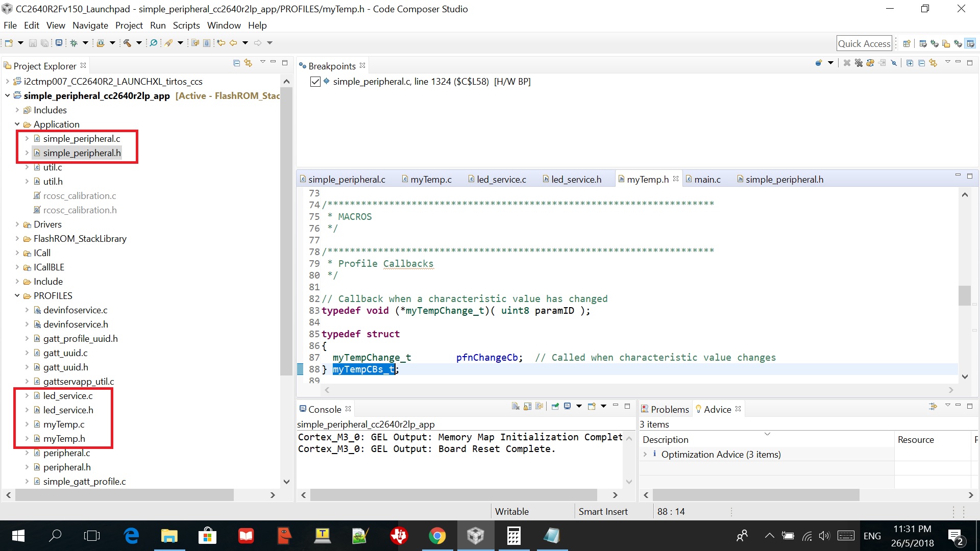

    Create a few new .c/.h files where you can put the tmp code into this file, and create a function like tmp_task_create(); in which you will call the POSIX thread create stuff etc and call this function from main.c

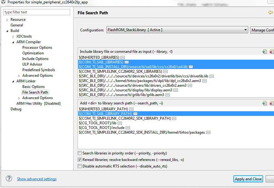

    Then, you will need to add posix to your project. To do this, you need to do a few things (we are working to improve this process).
    1) In simple_peripheral, under the TOOLS folder in the project, find app_ble.cfg. Change it according to this file:1401.app_ble.cfg
    2) Right click on project (simple_peripheral) > Properties > Build > ARM Compiler > Include Options and add this: ${COM_TI_SIMPLELINK_CC2640R2_SDK_INSTALL_DIR}/kernel/tirtos/packages/ti/sysbios/posix
    Then you will need to add the SAIL library and include references.
    1) Right click on project (simple_peripheral) > Properties > General > Products > Go down to Sensor and Actuator Plugin and select it
    2) Right click on project (simple_peripheral) > Properties > Build > ARM Linker > File Search Path > Add to "Include library file..."
    ${COM_TI_SAIL_INSTALL_DIR}/source/ti/sail/lib/ccs/cc26x0/sail.lib
    3) Under the same menu in "add <dir> etc.." add the following:
    ${COM_TI_SAIL_LIBRARY_PATH}

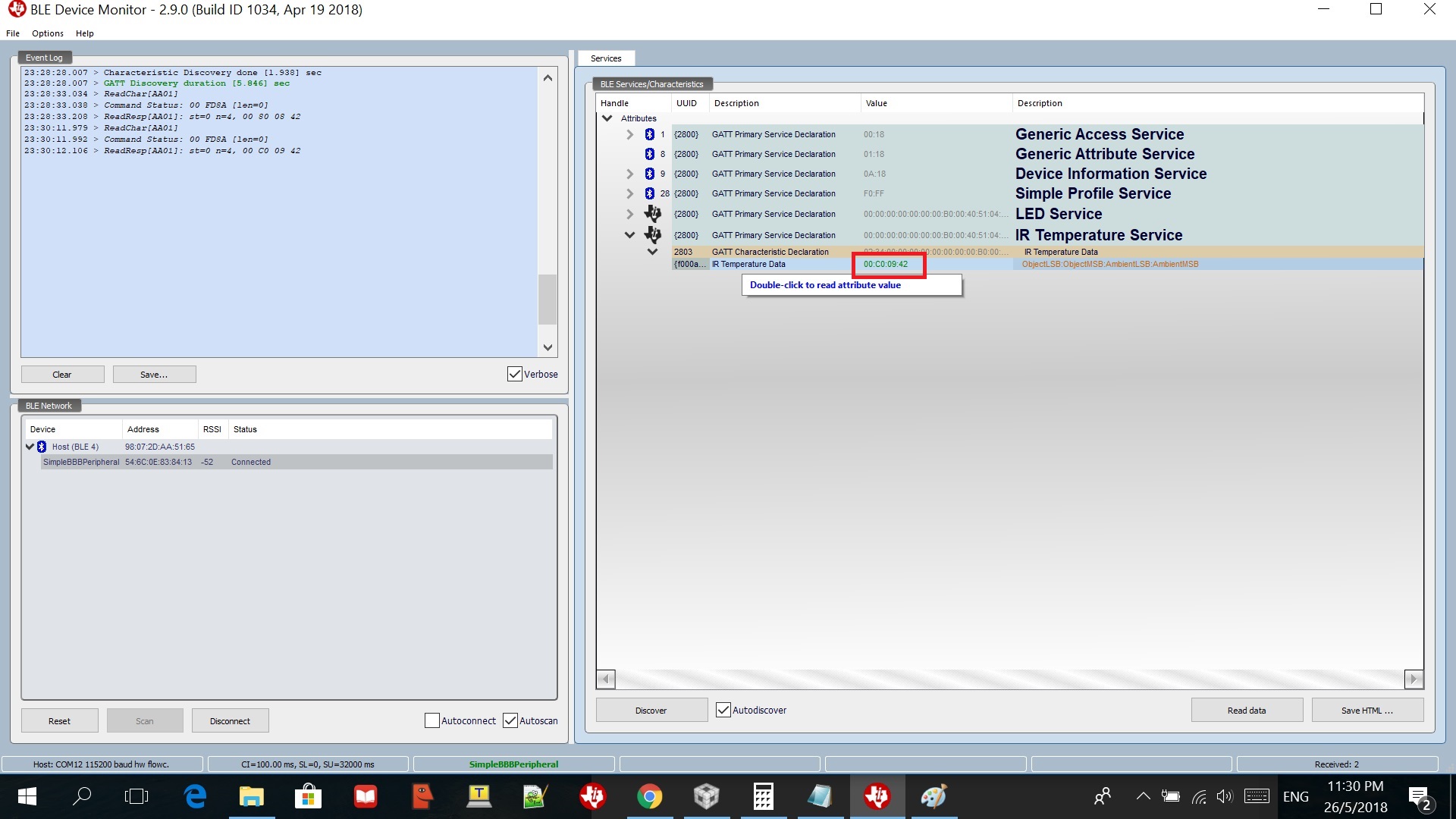

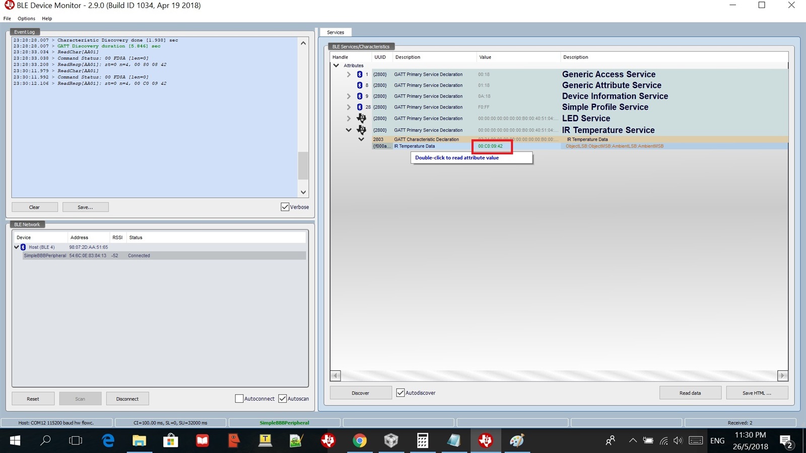

    When you run this, Characteristic 4 expects notifications to be turned on. Use light blue app to connect to it, turn on notifications and boom, you should stream some temp data every now and then.

  • Hi Evan,
    Not sure I was quite clear in my last post - "....I am *not* getting any output to my BLE client nor to the UART-connected display....." Actually, I get *ALL* of the expected outputs in terms of the the connectivity, UUID's, .... to both the display and the Client (Samsung notepad). It's just that none of the *sensor* data gets through. If I was more proficient with the ROV tools I could maybe make a bit more headway on my own. The static veiw shows all of the tasks 'Blocked' except the idle task.
    My code looks/seems to be exactly that which results from going through the '....Add BLE...' section (paraphrased - not in front of my computer)
    I appreciate the time you put into your response and I will give your suggestions a try. Please accept the following comments in the vein in which they are intended - a frustrated user who was depending on the TI example to help get a problem solved. I went through 90% of the SimpleLink Academy exercises. They are truly a 'must-have/do' resource and I commend TI's effort. I went through these exercises hoping that by the time I got to one of the only practical examples of combining some actual hardware with a BLE template that I would have a fairly good chance of getting the example going and porting some of my code into the template. With that said, respectfully, it would be nice if TI would run the example and see *exactly* where it is broken (I could be 'all wet' and in actuality it works fine - however, I did enter it 3 times and obtained the exact same results, but who knows ? Maybe I made the same error all three times.) If it truly doesn't work, my feeling is it should be pulled from the 'Academy. It should only take *at most* an hour to make the various mods and it may only be a line, or, two that needs inserted/modified. Again, maybe I've made some error and the example works fine.

    Can you right click project, go to properties > Include Options and look for this: ${COM_TI_SAIL_INCLUDE_PATH}
    Then, in the same window, go to General > Products > Products and Repositories can you confirm that you can see the SimpleLink Sensor and Actuator Plugin and that you have 1.20.x.xx selected for your project.
    Also confrim that in Build > Arm Linker > File Search Path > that you have these two libraiers under Include Library File or cmd file as input
    ${COM_TI_SAIL_LIBRARIES}
    and under Add <dir> to library search path that you have this:
    Apply and close.
    It may be also good to go to Window > Preferences >Code Composer Studio > Products and check to see that CCS sees SAIL (sensors and actuators plugin) as well. If not, click Rediscover.

    1. Unzip attached files Application.rar and Profiles.rar.
    2. Overwrite simple_peripheral.c and simple_peripheral.h from the files at Application folder
    3. At simple peripheral profiles folder add files led_service.c, led_service.h, MyTemp.c, MyTemp.h.
    4. Rebuild All
    5. Flash the hex file use LM Flash Programmer 2. The hex file is located at "C:\ti\ccsv8workspace\CC2640R2Fv150_Launchpad\simple_peripheral_cc2640r2lp_app\FlashROM_StackLibrary"

    5. Click Scan and you will SimpleBBBPeripheral at the BLE Network Window. Double Click SimpleBBBPeripheral.
    6. Open IR Temperature service.
    7. Double Click IR Temperature Data below and you will see the read Temperature in reverse hexadecimal format.
    8. The value shown in reverse is 0x42090C00. Which when converted to decimal is about 34 Celsius +. Just check in the internet how to convert that.

    The two images are from ROV. What I noticed is that *all* of the routines have either a 'BIOS_WAIT_FOREVER' (the tmp007 routine - for now I've commented that out but haven't had a chance to try it. Doesn't seem like it should really be necessary), or, an endless loop - for (;;) - with a '
    events = Event_pend(syncEvent, Event_Id_NONE, GAPROLE_ALL_EVENTS, ICALL_TIMEOUT_FOREVER) (gapRole_taskFxn), or,  for (;;) events = Event_pend(syncEvent, Event_Id_NONE, PRZ_ALL_EVENTS,
    ICALL_TIMEOUT_FOREVER); (ProjectZero_taskFxn). In both cases the functions are waiting for an event, but the general nature of 'ICALL_TIMEOUT_FOREVER' and I'm wondering if that's why all of the 'Events' are showing as 'Blocked'/'Waiting forever', as once any of those routines are called, they 'Init' their respective functions, then are waiting in the infinite loop.
    Another thing I'm wondering about is why the tmp007TaskFxn shows up in the ROV 'Event' list, but not in the 'Task' list ?
    Is there a technically sound fix (Hoping !!) ?

  • Hi James,
         There is no IOS BLE Apps issue seeing ble service. I just needed to refresh my bluetooth cach by rebooting my smartphone
         The step by step procedure I gave you uses SDK v1.50. The project zero from simplelink academy 1.12 uses SDK v1.00, which is the very first CC2640R2F SDK release. There are lots of changes and fixes from SDK v1.00 to SDK v1.50.
         Anyway, using the simplelink academy 1.12 ble thermostat module guide I was able to make it work with just minor modifications to Board.h. Here below is a screenshot of myTemp service UUID 0xAA00. This is raw temperature data in hexadecimal format.
    I assume you made the Project Zero work first. But, just to be sure here are the steps I did to make project zero work at CCSv8.
    1. CCSv8 installed installed at c:ti.
    2. CC2640R2F SDKv1.00 installed at c:ti.
    3. XDC Tools 3.32.1.22 installed at c:ti.
    4. Project Zero extracted at c:\ti.
    5. Copy "cc2640r2_project_zero" folder from "C:\ti\ble_examples-master\ble_examples-ble_examples-3.0\ble_examples-ble_examples-3.0\examples\rtos\CC2640R2_LAUNCHXL\blestack\" to "C:\ti\simplelink_cc2640r2_sdk_1_00_00_22\examples\rtos\CC2640R2_LAUNCHXL\blestack" folder.
    6. Import project zero app and stack project to CCS.
    7. At stack CCS project properties->General->Products. Make sure SDKv1.00 is selected. Make sure XDC Tools 3.32.1.22 is selected.
    8. At app CCS project properties->General->Products. Make sure SDKv1.00 is selected. Make sure XDC Tools 3.32.1.22 is selected.
    9. Enable hex generation utility for both stack and app ccs projects.
    After the above steps follow the simplelink academy 1.12 ble thermostat module guide. Here are the modifications at Board.h
    #define Board_TMP_ADDR          (0x40)
    #define Board_SENSORS_BP_TMP_ADDR Board_TMP_ADDR
    Rebuild All both Stack and App Project. Using LM Flash Programmer 2 select stack hex file then app hex file. Then flash the hex files. Let me know if you encounter any problems.
    Also you can download the latest simplelink academy 1.14 which has project zero that works for SDK v1.50. I have not tested that yet.
    -kel
