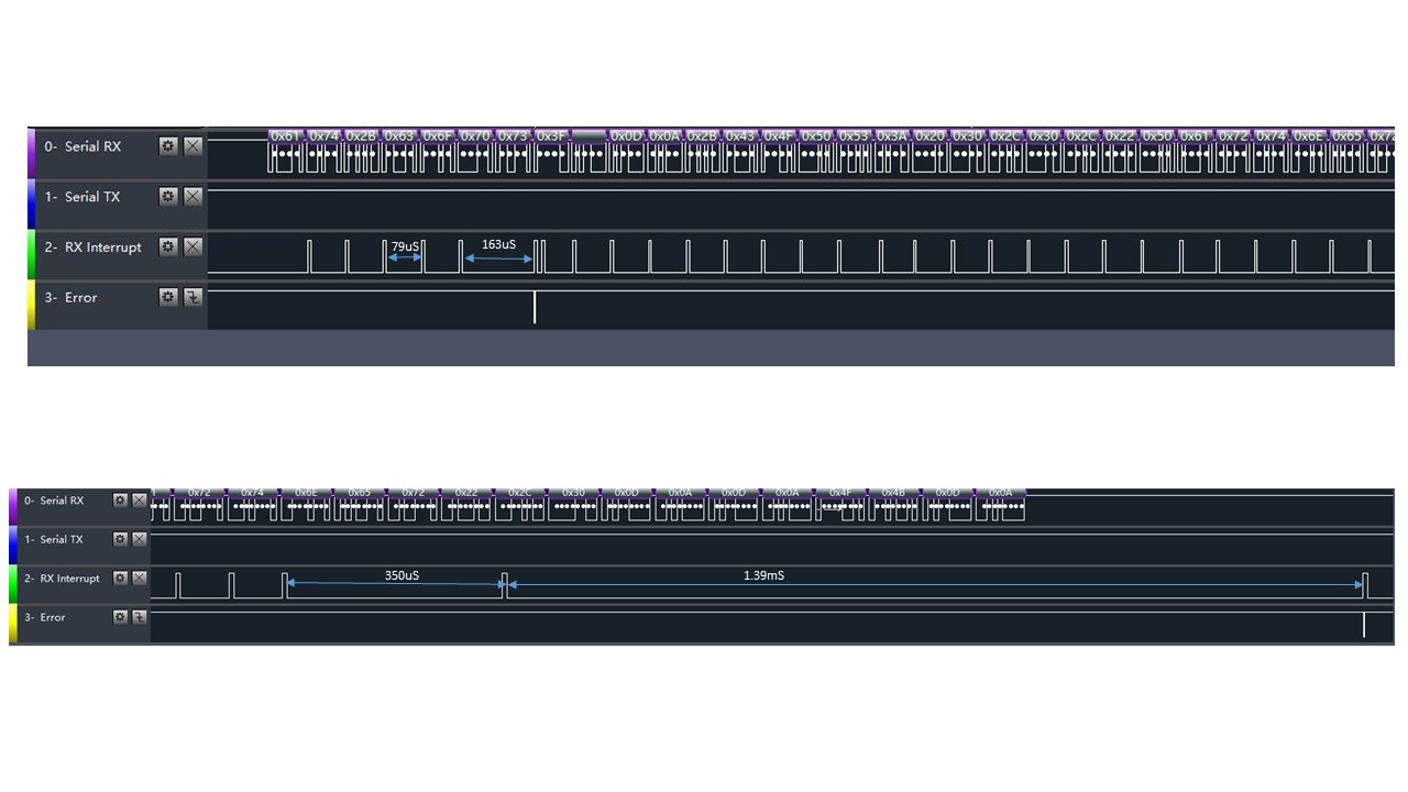

  You can see an example in the picture below, I recorded the serial port input and use an out port to demonstrate inert and another to notify whenever there is an unexpected input. In the first example the interrupt was blocked for ~100uS the second show an example where the interrupt blocked for  350uS and short time after that for 1.39mS . It is clear to me this is a bug in the BLE stack, interrupts should not be blocked for so long. I assume I am not the first one encountered with this issue. I can think of some workarounds, however each workarounds has limitations and not always implementable in my system.

    Thanks for your response. As mentioned I am using the simpleBLEPeripheral example code from TI. The serial port is connected to a cellular modem, and I am sending in a loop a test message comparing the results to what is expected ind signal if something is wrong. As long at the BLE advertising is off - everything runs smoothly, no errors, no interrupt losses, as soon as I turn on the Advertisement I am starting to loose data from time to time.

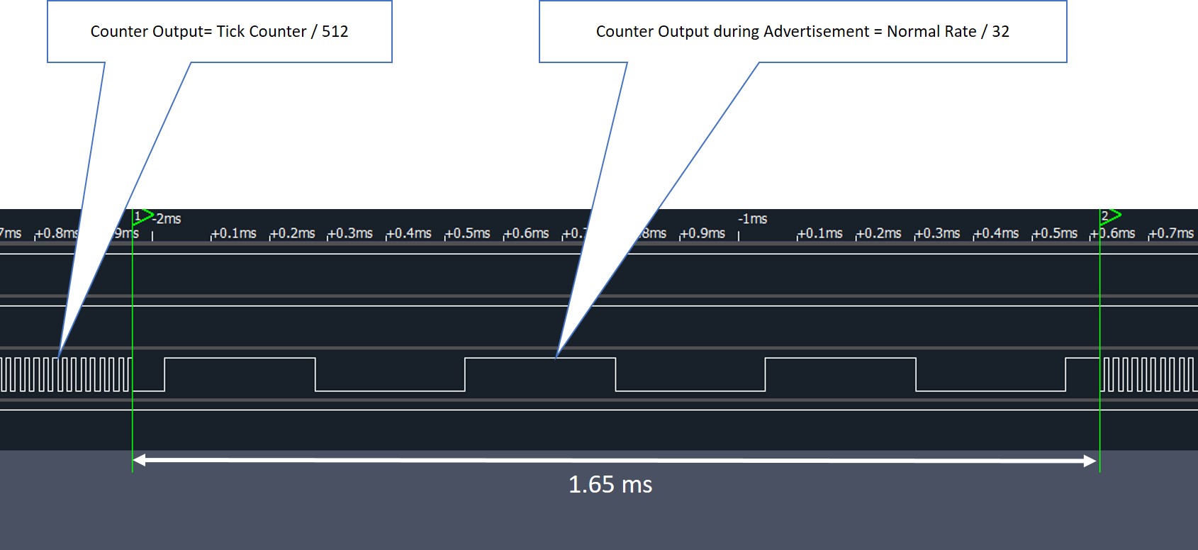

    I would like to add some more data, maybe it will helping you to analyze this issue, it seems like the source of the problem is not loosing interrupts but the CPU clock changed. It looks like the CPU clock is divided by 32 at certain time when advertising. Look at the picture below - it depicts an output of a free running counter configured to toggle every 256 CPU clocks i.e. the frequency is 25Mhz / 512 = 62.5 Khz. During advertising the CPU clock is divided by 32 - i.e. instead of 32Mhz it is only 1 Mhz. This results in undesired behavior such as the serial port baud rate is now 1/32 than the desired rate, if there is a receive or transmit during this period the data is corrupted.
    Eitan
