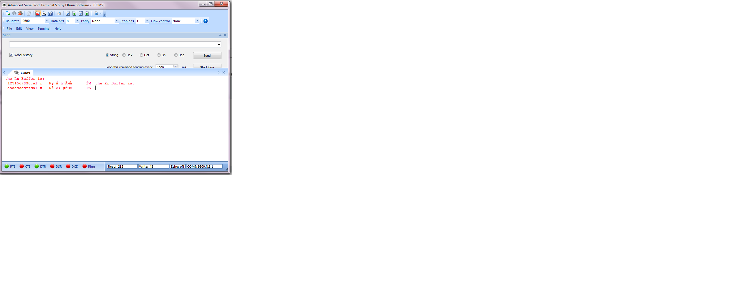

when I use many UART_write in the same function, the text and data I sent is not remain, some thing went wrong at the last of my string. Can you help me?
HERE IS MY CODE:
void read_cb(UART_Handle handle, void *rxbuff, size_t size)
    //uint8_t i = 0, index = 0, length = 0;
    //char data[20] = {0};
    char p1[] = "the Rx Buffer is:\r\n";
    UART_write(handle, p1, sizeof(p1));
    UART_write(handle, rxbuff, size);
    char p[] = "callback is active.\r\n";
    UART_write(handle, p, sizeof(p));
    UART_read(handle, rxbuff, size);
