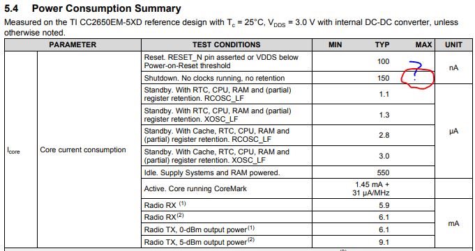

CC2640R2F: CC2640R2F Maximum Shutdown Current
Part Number: CC2640R2F
Hi TI Experts,
I would like to know what is the maximum shutdown current for CC2640R2F?
It is crucial to the design as it is only battery operated.
From the datasheet, it only mentioned 150nA (typ).
    The maximum shutdown current is nothing that is binary but could vary on many factors such as your hardware implementation and the temperature. You can use the typical value as a guide for in what range you expect the power consumption to be and from there characterize your own hardware to find out what it consumes in shutdown and if this is feasible.
