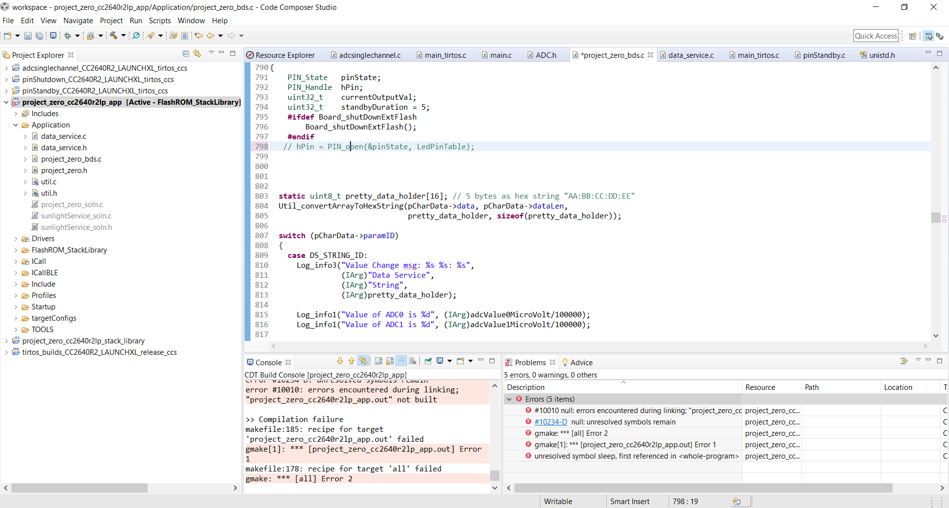

I am trying to compile Project_Zero by making some modifications to it i.e.: like adding functions as sleep to test the standby mode functionality. However, I am getting the error below. I tried to solve it by including path to posix library, but the error still keeps appearing. Kindly suggest a solution.
Description Resource Path Location Type
#10010 null: errors encountered during linking; "project_zero_cc2640r2lp_app.out" not built project_zero_cc2640r2lp_app C/C++ Problem
<a href="processors.wiki.ti.com/.../10234"> null: unresolved symbols remain project_zero_cc2640r2lp_app C/C++ Problem
gmake: *** [all] Error 2 project_zero_cc2640r2lp_app C/C++ Problem
gmake[1]: *** [project_zero_cc2640r2lp_app.out] Error 1 project_zero_cc2640r2lp_app C/C++ Problem
unresolved symbol sleep, first referenced in <whole-program> project_zero_cc2640r2lp_app C/C++ Problem

  • Hello Evan, I went to the include option and added path to C:/ti/...../ti/sysbios/posix.
    Here is what I have done I am trying to merge Project Zero and Standby Examples. So I have merged main() code and example code of both examples respectively. But I keep getting the error (unresolved symbol sleep, first referenced in <whole-program>).
    If it helps I can paste the error details below. Kinldy suggest a solution.

  • Hey Evan,
    1) I am just using the standby code for CC2640 provided as an example. Sorry for writing "standyby examples" and creating a confusion.
    2) I have attached the main.c code below, which is effectively just a merger of project_zero & standby example's main.c()
    3) Not sure about this. Can you please provide the steps necessary to do that?
