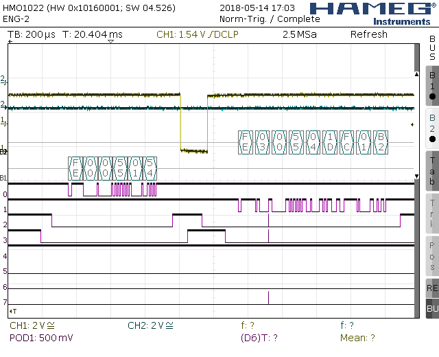

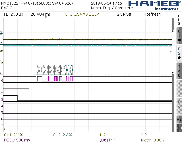

Attached are scope captures of a good (HFXT crystal disabled) and bad (HFXT crystal enabled) sequences.
What am I missing here?
Jeffrey
D0: BLE TX, D1: BLE_RX, D2: MRDY, D3: SRDY, D4: NRESET

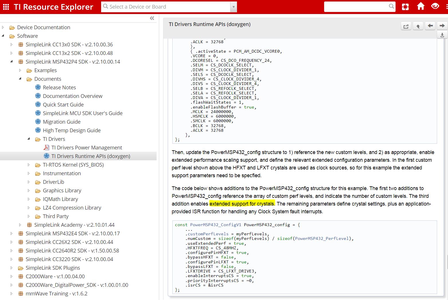

  • You can find a description of the customer power levels here:
    Chris
  • Hi Chris,
    How do I get to that section that you have in the picture? I did not see it in either Power.h or PowerMSP432.h.
    Jeffrey
  • I captured that from the doxygen output. If you navigate TI Drivers Runtime APIs (doxygen) and then select the PowerMSP432.h you will be taken to that section. It is close to the bottom. Which version of the SDK are you using? This was implemented in 1.60.00.12. dev.ti.com/.../
    Chris
  • Hi Chris,
    I am using MSP432P4 SDK version 2.10.00.14.
    I found that section.

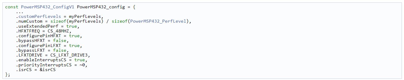

    The example SAP defines the PowerMSP432_config as follows:
    * =============================== Power ===============================
    const PowerMSP432_ConfigV1 PowerMSP432_config = {
    .policyInitFxn = &PowerMSP432_initPolicy,
    .policyFxn = &PowerMSP432_sleepPolicy,
    .initialPerfLevel = 2,
    .enablePolicy = true,
    .enablePerf = true,
    .enableParking = true,
    I just want to be able to run the example program using an external 48MHz crystal.
    Do I need to create custom performance levels to use an external HFXT crystal? Or do I just add the following lines to the configuration:
    .HFXTFREQ = CS_48MHZ,
    .configurePinHFXT = true,
    .bypassHFXT = false,
    Jeffrey

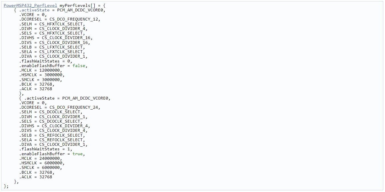

  • Jeffrey,
       Please follow the instructions found in the link above:
    First, if not already included in the board file, add the includes of cs.h and pcm.h.
    Next, add an array with your new performance levels.
    Then, update the PowerMSP432_config structure to 1) reference the new custom levels, and 2) as appropriate, enable extended performance scaling support, and define the relevant extended configuration parameters. In the first custom perf level shown above the HFXT and LFXT crystals are used as clock sources, so for this example the extended support parameters need to be specfied.
    The code below shows additions to the PowerMSP432_config structure for this example. The first two additions to PowerMSP432_config reference the array of custom perf levels, and indicate the number of custom levels. The third addition enables extended support for crystals. The remaining parameters define crystal settings, plus an application-provided ISR function for handling any Clock System fault interrupts.
