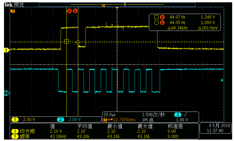

Hi
The right data should be 0x10000110, but actually it's 0x10111111, false data start from the 3rd bit.
a. It's working well when data rate is below 78KHz.
b. 100KHz, it appear above false long 1 data. Sometimes , it start from the 1st bit, sometimes start from one middle bit.
c. 100KHz, it's working well if running CC2541 peripherals I2C example, which has no BLE function.
Is it caused by BLE priority? We set BLE interruption priority higher than I2C. Thanks.

  • Hi AB,
    Thanks for your reply. Already find the root cause. Which is caused by customer wrong porting.
    They porting I2C driver from CC2541_43_44_45_Peripherals_Examples directly to Simpleperipheral example. I2C interruption function are running with OSAL task at the same time.
    We need CC2541 running at I2C slave mode + BLE connected beacon mode.
    Which document or example could help us porting I2C slave driver to Simpleperipheral example? Thanks a lot.
