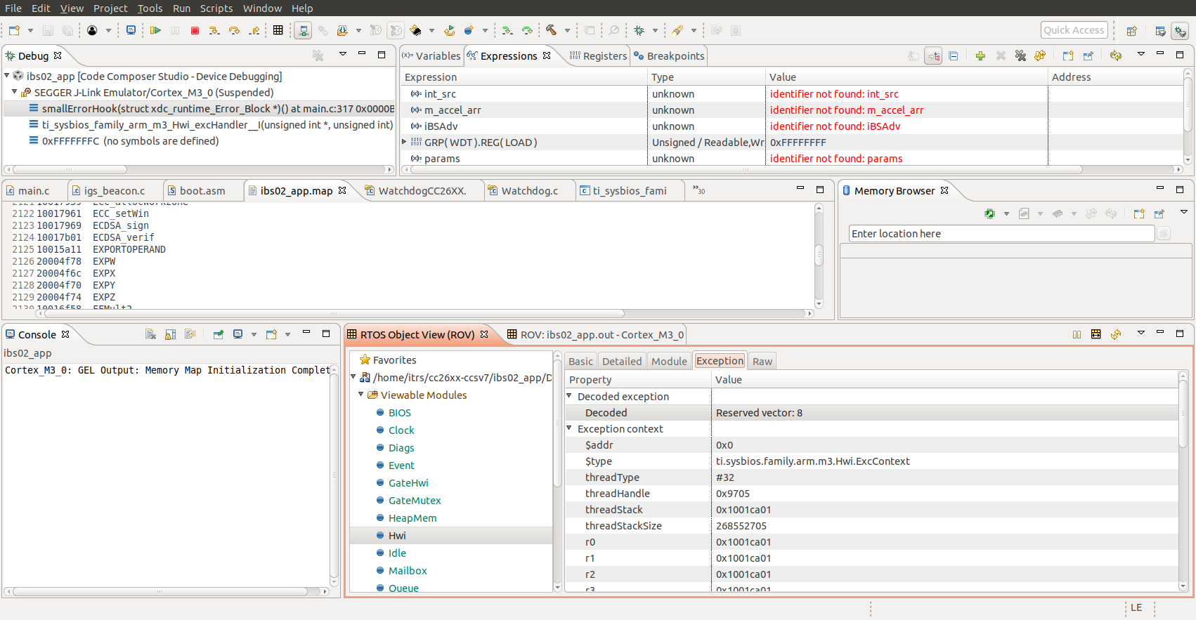

Hi All,
I try to introduce watchdog for CC2640 unexpected hang up,
void watchdogCallback(uintptr_t unused)
  // iBSAdv.frame.data.gpi |= GPI_SOURCE_HALL;
  iBSAdv.frame.data.tag_type ++;
  // IgsBeacon_syncAdvFrame();
  // IgsBeacon_enqueueMsg(SEB_ADV_MODE_CHANGE_EVT, ADV_MODE_SINGLE_BURST);
  Watchdog_clear(watchdogHandle);
  // while(1);
  // SystemReset();
static void IgsWatchdog_Init(void)
  static Watchdog_Params params;
  Watchdog_init();
  Watchdog_Params_init(&params);
  params.resetMode = Watchdog_RESET_OFF;
  params.debugStallMode = Watchdog_DEBUG_STALL_ON;
  params.callbackFxn = (Watchdog_Callback)watchdogCallback;
  watchdogHandle = Watchdog_open(Board_WATCHDOG0, &params);
  if (watchdogHandle == NULL) {
    /* Error opening Watchdog */
    while (1);
  uint32_t tick = Watchdog_convertMsToTicks(watchdogHandle, 10000);
  Watchdog_setReload(watchdogHandle, tick);
However watchdogCallback never be called.
Try to debug and find hwi exception happened.
Any hint or idea ?

  • Some findings:
    1. Watchdog Driver NMI interrupt not working
    --- a/sdk/tirtos_cc13xx_cc26xx_2_21_01_08/products/tidrivers_cc13xx_cc26xx_2_21_01_01/packages/ti/drivers/watchdog/WatchdogCC26XX.c
    +++ b/sdk/tirtos_cc13xx_cc26xx_2_21_01_08/products/tidrivers_cc13xx_cc26xx_2_21_01_01/packages/ti/drivers/watchdog/WatchdogCC26XX.c
    @@ -245,7 +245,8 @@ static void WatchdogCC26XX_initHw(Watchdog_Handle handle) {
         /* enable the Watchdog interrupt as a non-maskable interrupt */
    -    WatchdogIntTypeSet(WATCHDOG_INT_TYPE_NMI);
    +    // WatchdogIntTypeSet(WATCHDOG_INT_TYPE_NMI);
    +    WatchdogIntTypeSet(WATCHDOG_INT_TYPE_INT);
    The original WATCHDOG_INT_TYPE_INT will cause system hang while watchdog time out without calling watchdog callback
    Some thread mentioned this but it's still not fixed in sdk 2.2.2, can Ti guys confirm this ?
    2. watchdog reload time is very tricky. since watchdog only count down out of standby mode, the time is not work as expected.
    for my beacon project (most of time it should keep in standby mode), i leave watchdog without feeding and set reload time to 30 secs, it turns out that it takes 12 hours to timeout and reboot system !!
    The reload time is very hard to predict in real case.

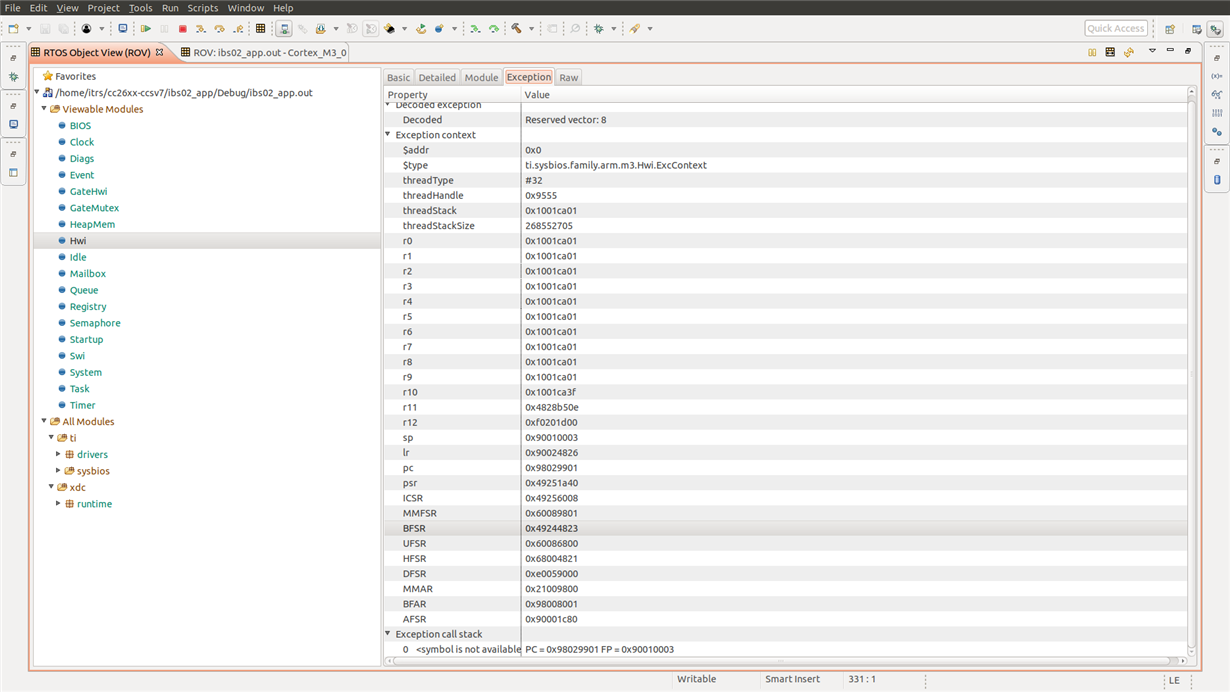

    Correct, this is still not fixed on the sdk 2.2.2. FYI, it is possible to update the interrupt number in your board file (CC2650_LAUNCHXL.c), for example:
    const WatchdogCC26XX_HWAttrs watchdogCC26XXHWAttrs[CC2650_LAUNCHXL_WATCHDOGCOUNT] = {
            .baseAddr = WDT_BASE,
            .intNum = INT_NMI_FAULT/*INT_WDT_IRQ*/,
            .reloadValue = 1000 /* Reload value in milliseconds */
    This will depend on the time your device is awake. If for some reason the PC is getting lost, usually it will execute code and it will not be sleeping, so in this case the watchdog timeout should be met and it will force a reset. Usually the watchdog windows are around 10 to 50ms.
    Anyway, you can try another power policy, keeping in mind that the device will consume more power. An example is using PowerCC26XX_doWFI instead of PowerCC26XX_standbyPolicy:
    /* Place into subsections to allow the TI linker to remove items properly */
    #if defined(__TI_COMPILER_VERSION__)
    #pragma DATA_SECTION(PowerCC26XX_config, ".const:PowerCC26XX_config")
    #endif
    const PowerCC26XX_Config PowerCC26XX_config = {
        .policyInitFxn      = NULL,
        .policyFxn          = &PowerCC26XX_doWFI/*PowerCC26XX_standbyPolicy*/,
        .calibrateFxn       = &PowerCC26XX_calibrate,
        .enablePolicy       = TRUE,
        .calibrateRCOSC_LF  = TRUE,
        .calibrateRCOSC_HF  = TRUE,
    Hopefully this helps.
