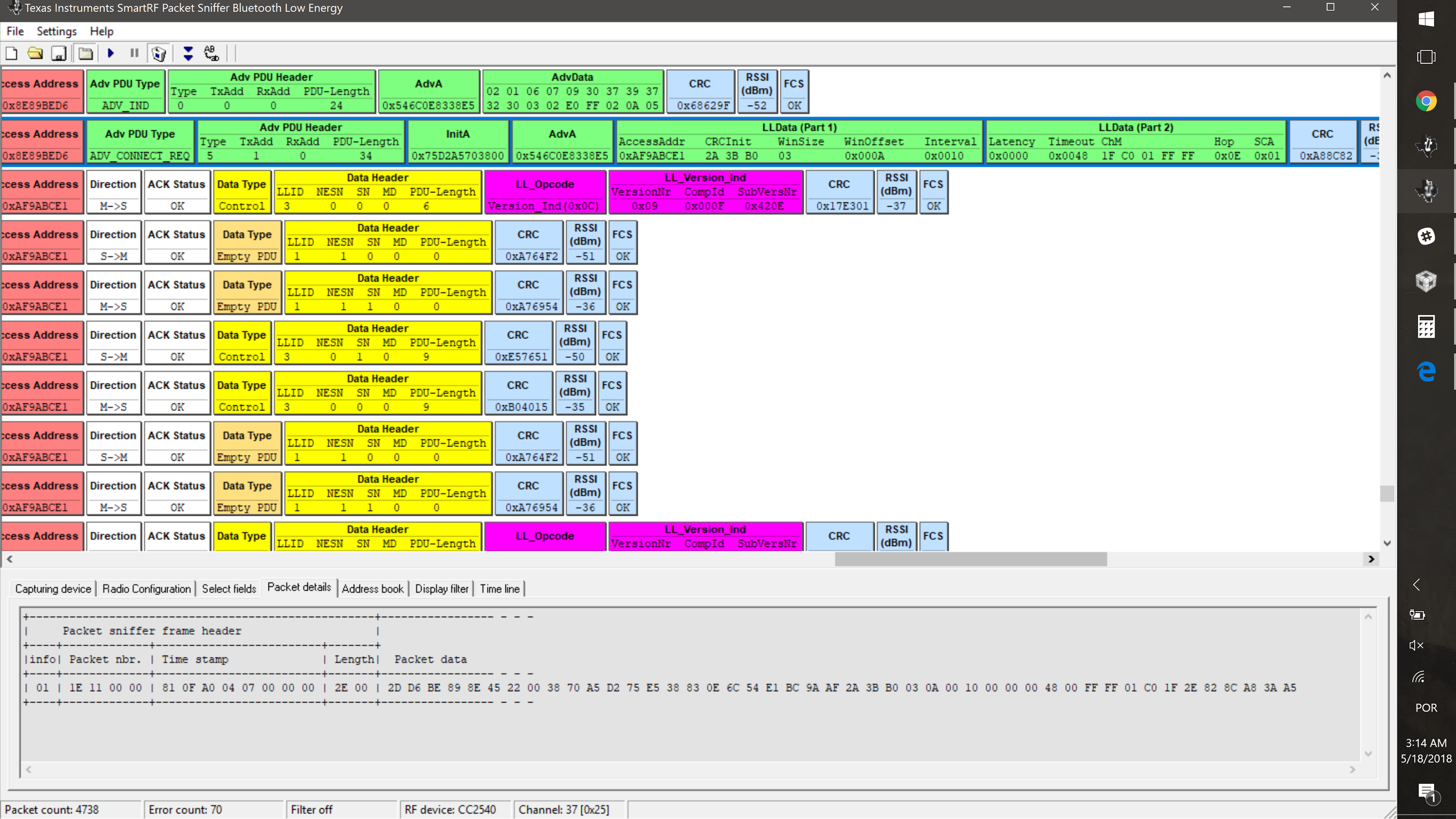

I did sniffer and it is advertising. The last message my peripheral received from the Iphone X was a request for a MTU exchange and my Iphone didn't receive anything. My mtu size is 65.

Hi Leoni,
Can you post the sniffer log with the Service discovery request packet sent from the master?
Here are the shiffer logs for a bugged connection and for a healthy connection.
Healthy: healthy conection.psd
