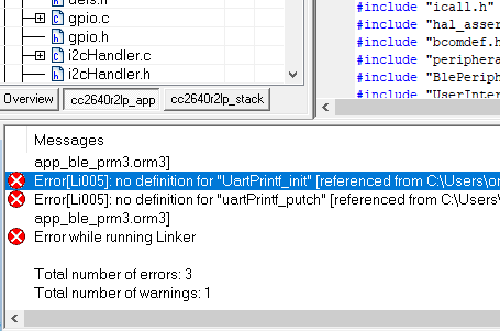

hello
I have a project in IAR using Bluetooth chip. My aim is to debug events sent to the chip using log_info0, I studied the project zero in another pc but could not figure out what the problem is
I ve the following lines
#include <ti/drivers/UART.h>
#include <xdc/runtime/Log.h>
#include <ti/drivers/uart/UARTCC26xx.h>
in the main I have
main ()
Power_init(); PWM_init(); I2C_init();
UART_init();
when I compile the project I get :
Error [Li005]: no definition for UART_count [referenced from UART.orm3(drivers_cc26x0r2.arm3)]
Error[Li005]: no definition for UART_config  [referenced from UART.orm3(drivers_cc26x0r2.arm3)]
Is there a header missing?
