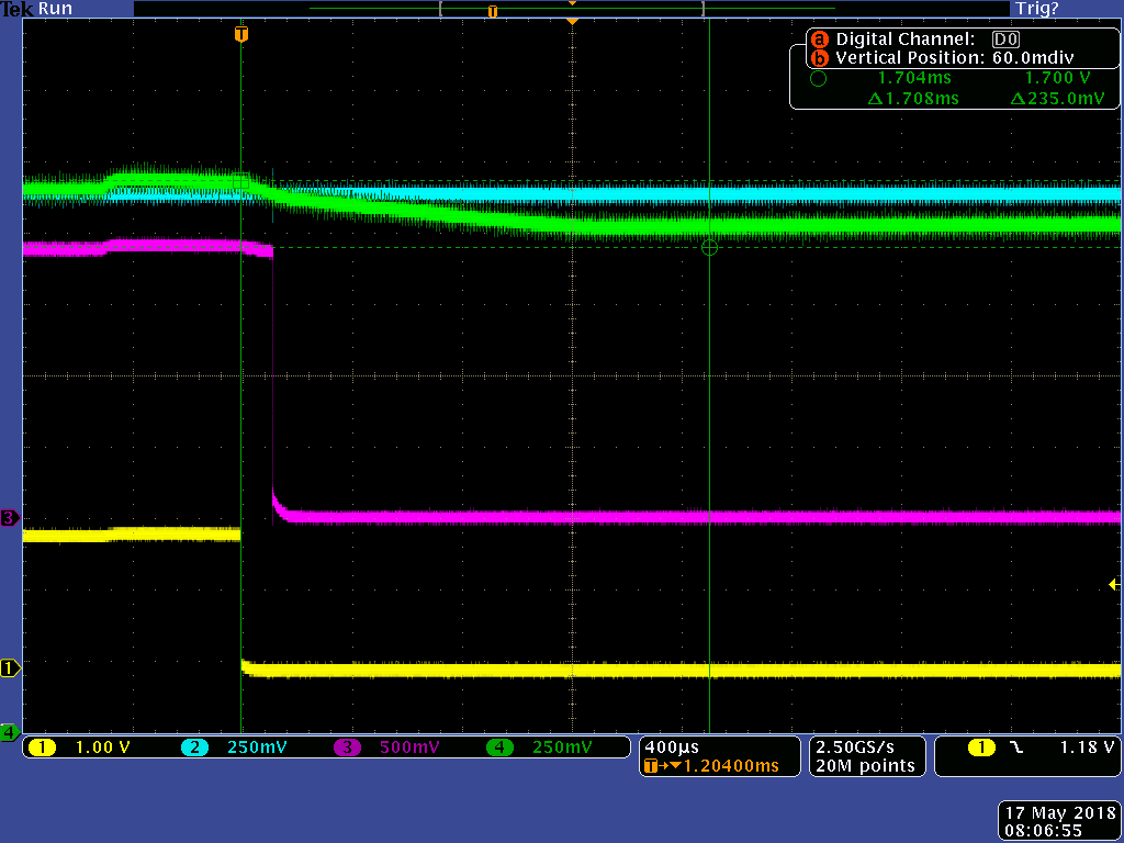

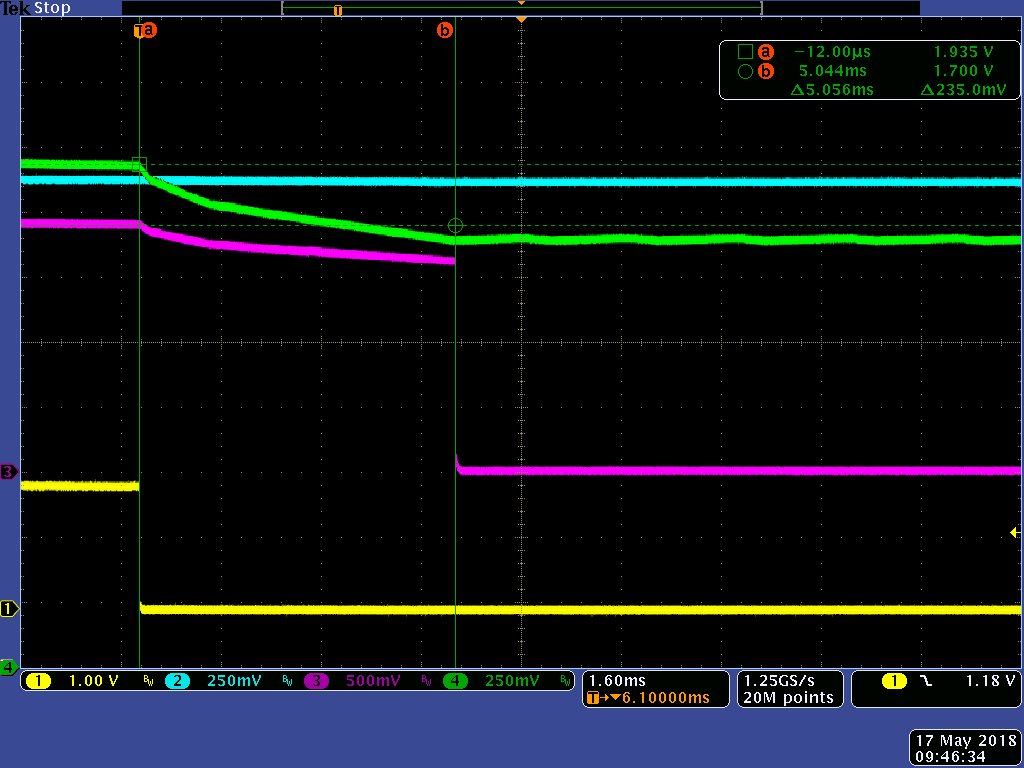

The PG signal (Power Good – in yellow in the oscilloscope snapshot) is connected to a CC2640R2F GPIO interrupt
The CC2640R2F standby mode entering process is the following :
Step1/ The PG signal falling edge triggers a CC2640 interrupt which calls “standby mode entering” procedure within TI RTOS CC2640 environment
Step 2/ The TI RTOS schedules “standby mode entering” using message queuing priorities
Step 3/ GPIO settings are modified before standby mode in CC2640 and particularly the GPIO connected to a LED driving PT25 (in Purple in the oscilloscope snapshot) is set to low
Conclusion : On pic1 we can see that the timing between PG falling edge and PT25 falling edge is 170us. On pic2 we can see that the timing between PG falling edge and PT25 falling edge is 5ms. This means that the “standby mode entering” process timing is not deterministic.
