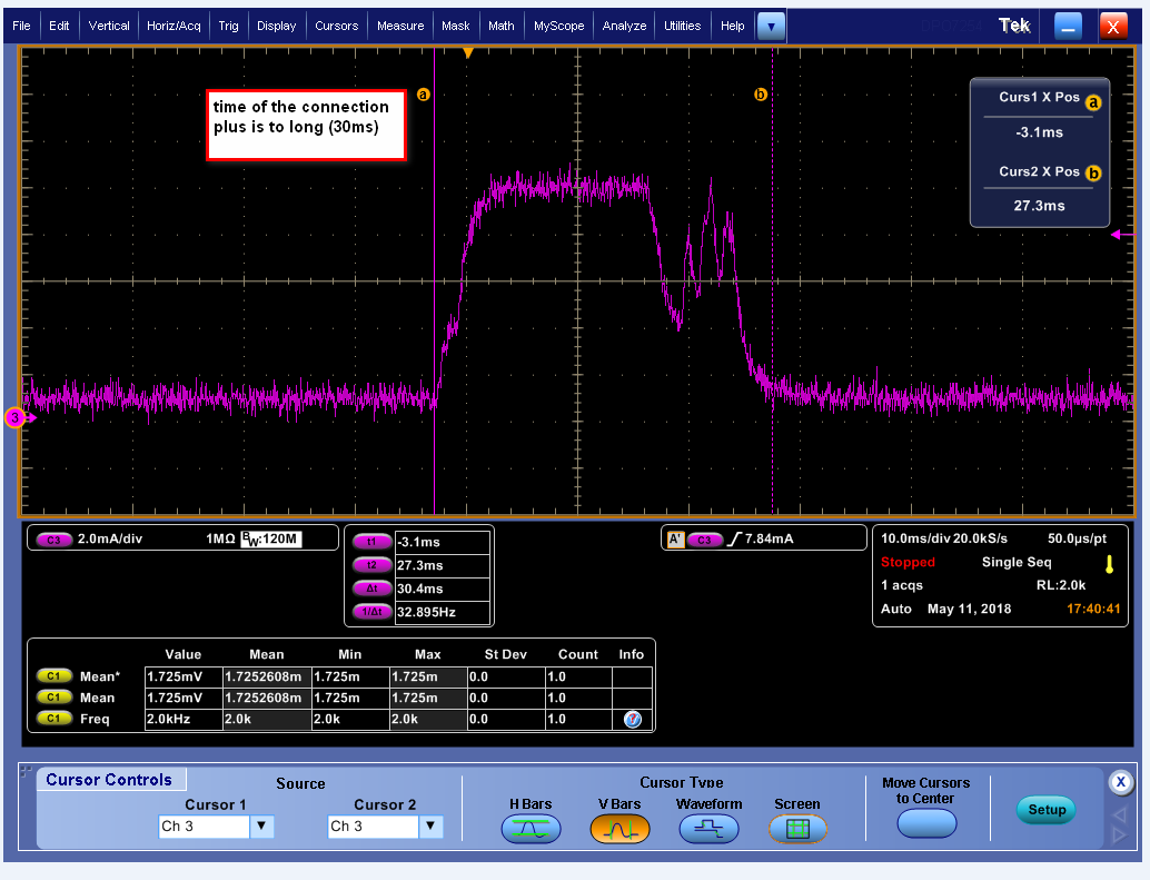

Attachment is connection mode current(500K date rate) of our tag , this current waveform’s width is too wide( 30ms). We do not send any other data. Is BT5.0 connection current always is such big? Do you have reference power current for 500K data rate on connection mode?
  • Hi Michael,
    Can you show where you are setting the PHY - are you sure it is using 500kbps and not the 125kbps coded PHY, because for that I think 30ms might actually make sense since it takes 8 times as long to send the same data.
