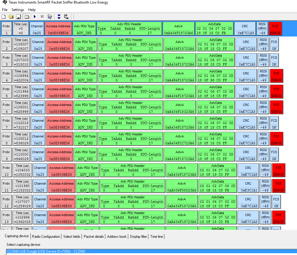

The software is running, and UART monitoring confirms all OK. Sensors are operating, the BLE waiting for connection in “Advertising” mode.
BUT ERROR: the device can be discovered by other devices, but cannot be connected, cannot retrieve the service list, cannot communicate. Device name "N/A" or "Unknown" in BLE monitor. The BLE packet sniffer list the advertising packages, but there are tons of "FCE ERROR" (50%).
I was suspect the 32Khz oscillator instability, but I had tried 3 different type of oscillator. I had also measured the oscillator signal with an oscilloscope, but it always showed perfectly stable.
After this, based on the documentation of swra499b.pdf I had switch to internal RC oscillator, but the problem still exist.
The RF front-end design identical with the Launchpad’s one. The power supply is stable 1.8V.
In my opinion the error is in correlation with the power supply build-up design, but I cannot identify what else should be modified apart form those I listed above, to ensure, that the BLE communication work perfectly.
