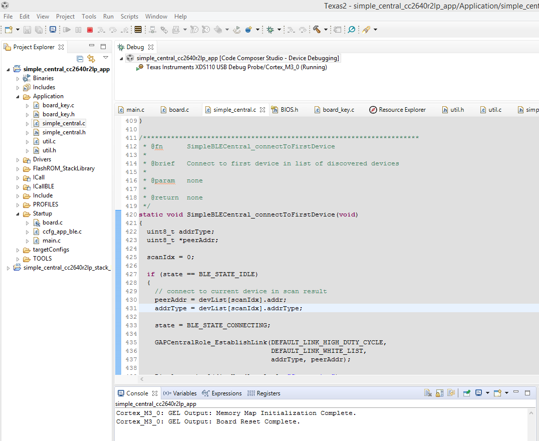

Hello.
The project "simple_central" for cc2640 does not work on cc2650moda. After playing the debug, there is no action:
  • do not work breakpoints
  • not pause button
  • the board does not respond to changes in the code
The processor did not change the settings (in the project it costs cc2640), following the advice https://e2e.ti.com/support/wireless_connectivity/bluetooth_low_energy/f/538/t/404236.
Other projects work without problems.
I use ..\ble_sdk_2_02_02_25\examples\cc2650em\simple_central
