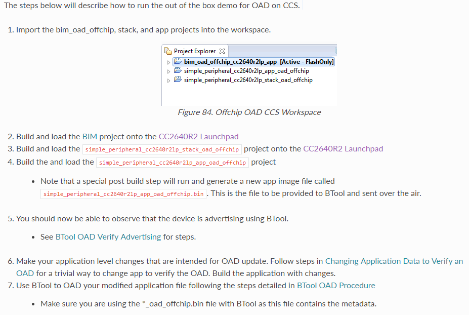

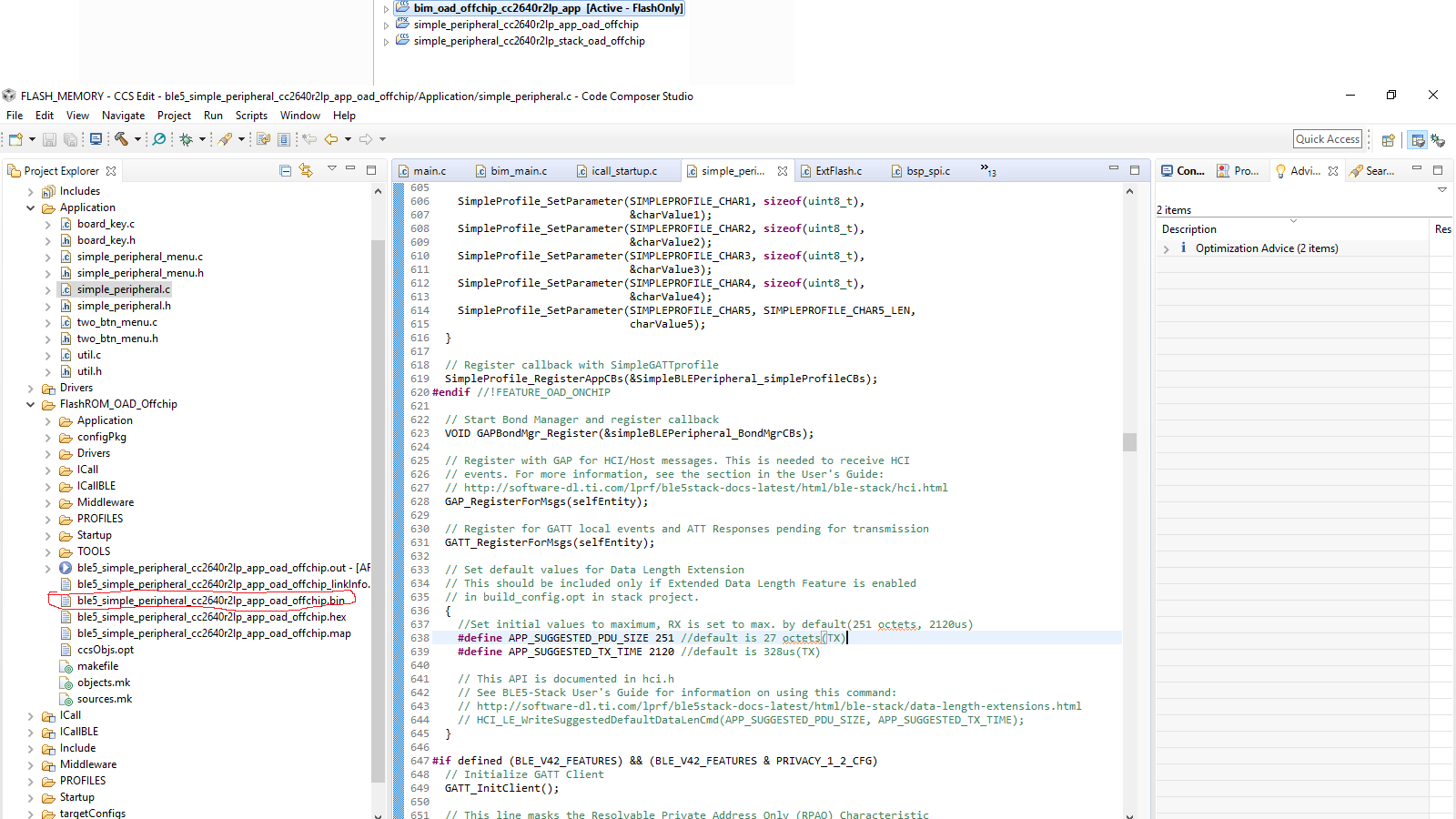

I'm a beginner to  OAD in CC2640R2F MCU. i am  using MX25R1635F external flash memory for OAD. i did following steps
The bin file which is i marked in red color in above image i read that bin file in  btool. I am getting  OAD not successful status. what is the reason for this???

    No,i didn't make any changes in project. In btool it is showing OAD not successful.
