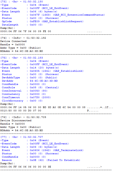

    For reference, here's what it looks like in BTool when the slave does not join the connection request:
    In the above it didn't connect because the slave was set up to use whitelist, not including that central.
    I should add that it works this way because the CONN_IND is not acknowledged, so as far as the central is concerned the connection is established the moment it has sent the connection request to the slave.
