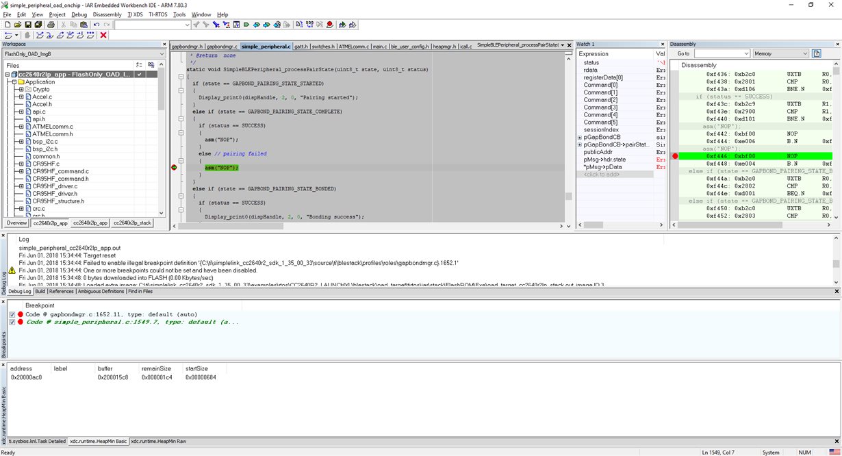

I noticed when I create a task in simpleBLE peripheral project I can't pair anymore. Has anyone seen this issue before ?

  • This is my what I do to create the task:
    Task_Params taskParams;
    // Configure task
    Task_Params_init(&taskParams);
    taskParams.stack = TaskStack;
    taskParams.stackSize = SBP_TASK_STACK_SIZE;
    taskParams.priority = SPI_TASK_PRIORITY;
    Task_construct(&spiTask, ATMELcomm_taskFxn, &taskParams, NULL);
  • Hi Marie,
    Here's my screenshot for the heap details(I'm using IAR). to be honest the isntructions for troubleshooting Heap are not very clear. Does "remainSize" mean I didn't go over my heap size?
    Mario

  • Hi Mario,
    I find the easiest is pausing the debugging session and adding the heapmgr global variable to the watched expressions (heapmgrBlkFree, heapmgrMemAlo, heapmgrMemMax, heapmgrMemFail etc).
    If heapmgrMemFail > 0 you probably have a heap issue.
  • Hi Marie,
    After adding heapmgrMemFail and pausing each time after pairing is attempted I can see that the count is going up each time so I'm getting memory allocation failures. So now the question is what can I do about it?
    Can I increase the size of the heap?
    Also, I am using SDK 1.35.00.33.
    Mario

  • Hi Marie,
    Thanks for that app note. I made a lot of progress. I used AUX RAM as RAM and I'm not getting heap memory allocation failures anymore, however I encountered one new issue. I can only run my application when I run it through my debugger. As soon as I disconnect my debugger and power cycle my board it doesn't advertise anymore. If I use start a debugging session then it works fine.
    Any ideas why?
    btw I'm using the cc2640r2 OAD build configuration so I don't know if that makes any difference.
    Mario
