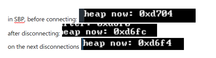

On every connect + disconnect, the MCU loses 8 bytes of heap memory.
Here are the steps to reproduce:
1. run ble5_simple_peripheral_cc26x2r2lp_app project on the relevant LaunchPad.
2. constantly print the total free size of the heap using
uint32_t heap_now = heap_stat.totalFreeSize;
Display_print1(dispHandle, 15, 0, "heap now: 0x%x", heap_now);
3. notice: the free heap size before connecting is larger in 8 bytes than the total free heap size after disconnecting.

  • Hi Amit,
    Thanks for reporting this. It turns out that it's the paramUpdateEventData allocated in SimplePeripheral_addConn that isn't deallocated.
    As a sort of hack, you can add ICall_free(pUpdateClock->f6); before Clock_destruct in SimplePeripheral_removeConn(..) and ICall_free(connList[connIndex].pUpdateClock->f6); in SimplePeripheral_processParamUpdate(...)
    I've reported this to the development team. Thanks again.
