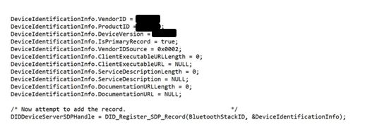

(1) Below is my code for PnPInformation.
The return value of DID_Register_SDP_Record() is zero.  Looks like I am missing something here.  Do I need to register the service before adding a SDP record.  However I cannot find any APIs to register DID service.  Please advise.

    The supported profiles and service with Bluetopia stack are listed in the STM32 User's guide -
    www.ti.com/.../swru428.pdf
    If, you are tying to set the Manufacturer name etc, can't you use the DIS service, "DIS_Set_Manufacturer_Name", etc.. You can see any demo example, "HOGPDemo.c" etc..

    Can I confirm that Bluetopia stack does not support Device Identification Profile as it was not listed in the document (swru428.pdf).

    May I know what is the difference between using DIS (device information service) to provide VID/PID and setting up DID_SDP_record for PnPInformation (VID/PID)? In another word, does the remote host use the same command to retrieve these information from the controller (CC2564MODN)?
